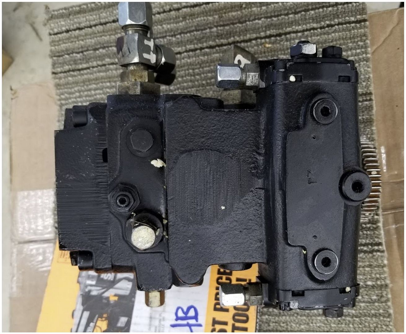

Thank you everyone, I have the tram pump off and had it sent back to PT. I talked to Terry and he said your not even close to be in panic mode. The wheel motors do eventually drain back into the holding take he said. I was raised to respect peoples thoughts and make my own decisions and keep them to myself. I have read what everyone has posted and came up with some ideas. At this time I really don't want to buy a new tractor but it is really fun to look. I just can't get past how versatile this tractor is for me. The standard tractors just don't measure up to my tasks.
I do like the idea of some type of filtration in the wheel motor system at least for awhile. Marrt I am go to try to see what you did for that inline filter if I can find it. Tomorrow Terry should give me a call since the tram pump was suppose to be there today according to ups tracking. I am going to bring this up to him. I called a place that would basically do what an inline filter would do and it was really expensive. Money don't grow on trees around here but I really like that idea of another filter in that circuit even if it is just a small one. I don't know if it could be permanent, does the oil go both directions in the lines going from forward to reverse. I am replacing all the oil with fresh (old oil is really dark now) and the reservoir is drained and completely wiped down. Anyone know how to get all or the majority of the oil out of all the lines. Blow it out?
Again thanks for all the replies. I will update you all as things start to happen.

Got of the phone with Terry and my pump is on its way back. I asked about cleaning the lines. He said don't worry about it the pump was very clean inside. He said when I hook everything back up the filter will take care of anything left in the lines. The cause was I broke both bolt heads off that hold the swash plate on. He said all the parts were still in there. I asked what could cause that to happen. Just a fluke, he couldn't tell me. In reality it is just my crappy luck I guess. Either way I am going to do my best to flush anything out of there I can because I am replaceing all the oil with new fresh liquid gold. Thanks for all your help and suggestions. This still is the best forum on the internet. Helpful and knowledgable people not to mention nice as well.
What is the definition of "eventually" in this context? That's what I was talking about at the end of my last post...how much "leakage" is normal in these circuits. Further, the White motors in the 425 do not have a dedicated case drain. So, from a practical perspective, how could this circuit ever be filtered? Regarding your oil and condition of the pump, the particles that cause the most damage are too small to see. If your oil is dark, it's more likely from thermal breakdown IMHO. Definitely replace it though. All hydraulic machines require the hydraulic oil to be changed periodically. I replaced it in my Kubota's at 50 hours. My Takeuchi track loader also uses motor oil for hydraulic oil and the replacement cycle is every 1000 hours. For the Takeuchi mini-x, it's every 2000 hours depending on attachment use. Just to give you an idea of the range. Keep in mind, a commercial machine will reach these cycles every 1 or 2 years.
I've been curious for a while as to why these pumps from Power Trac fail so often. I've had one fail at <400 hours and another one on a different machine at <700 hours. This is crazy. A few people get a lot of hours out of them but that seems fairly rare, just going by this forum. For a lot of equipment used commercially, a failure rate this high would mean replacing the pump once or twice PER YEAR. To solve my curiosity, I hired a hydraulic consultant who's written several books on hydraulic maintenance to help me understand what is going on. What I've written is based on his advice.
The diagram for the filter I built is below. It uses a 3 micron filter (special order) and a filter case like this one (SAE 12 3 GPM High Pressure Filter | Filters | Hydraulic Filters | Hydraulics | www.surpluscenter.com). I added some gauges and a flow meter as well but they aren't needed for the basic setup in personal use. I probably wouldn't try to plumb this in permanently because there's not really enough room in the tub and it's hard to find an affordable high pressure filter that will take the pressure full time. I'm using a high pressure filter that's rated for about 3K PSI but I filter the tractor on blocks with the wheels off. Some pumps will generate over 5K intermittently under load. With the wheels off the ground, the circuit generated about 700 PSI if I remember correctly. This is plumbed IN LINE at the wheel motor....meaning you remove any line that's convenient and connect it to any line on the filter. Connect the remaining line from the filter back to the motor. When connected, you can reverse direction of the tram to reverse flow in the circuit (this is even advisable). I'm going to filter the circuit on my 1845 this week and I'll try to get a picture.
