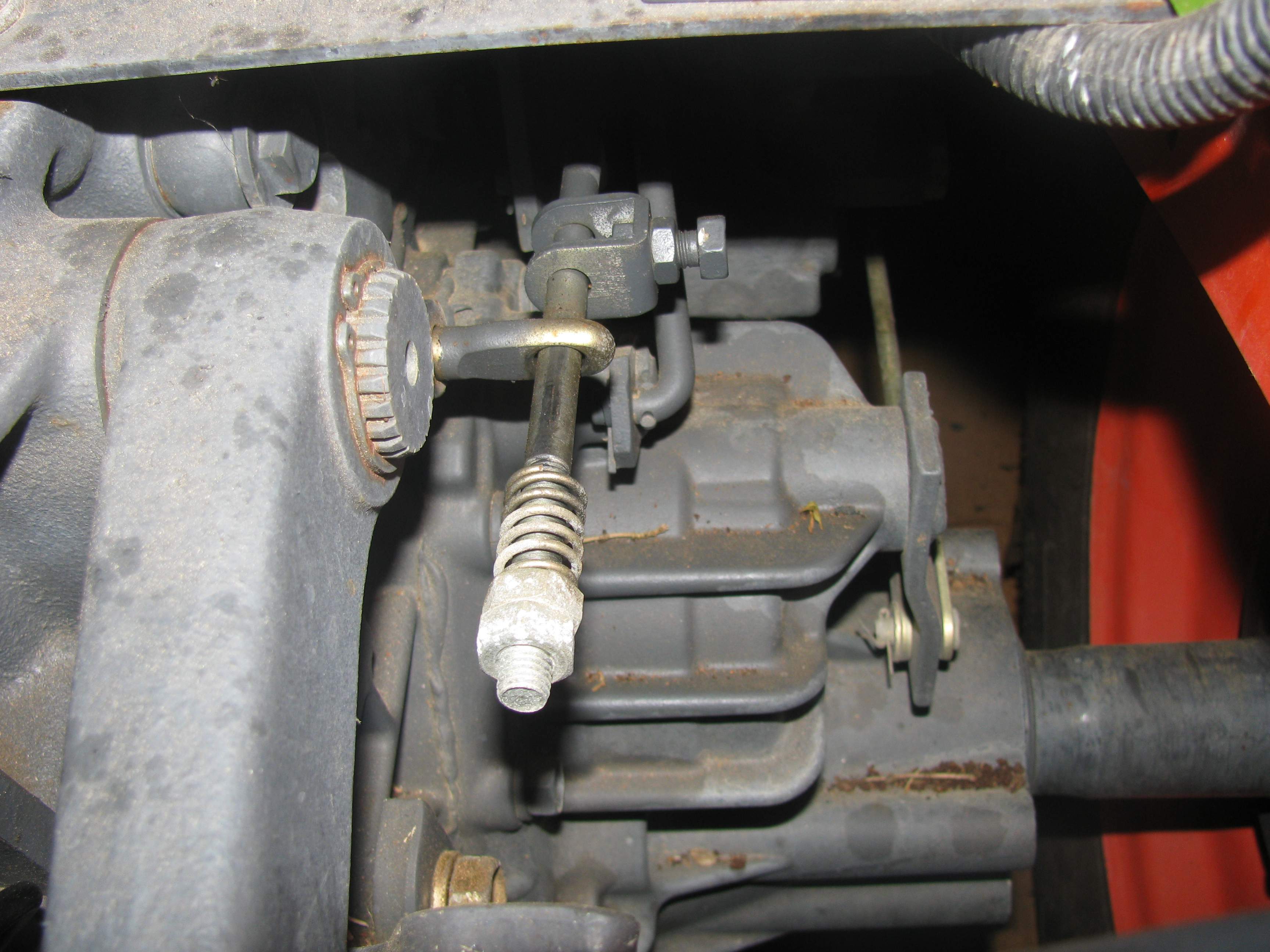

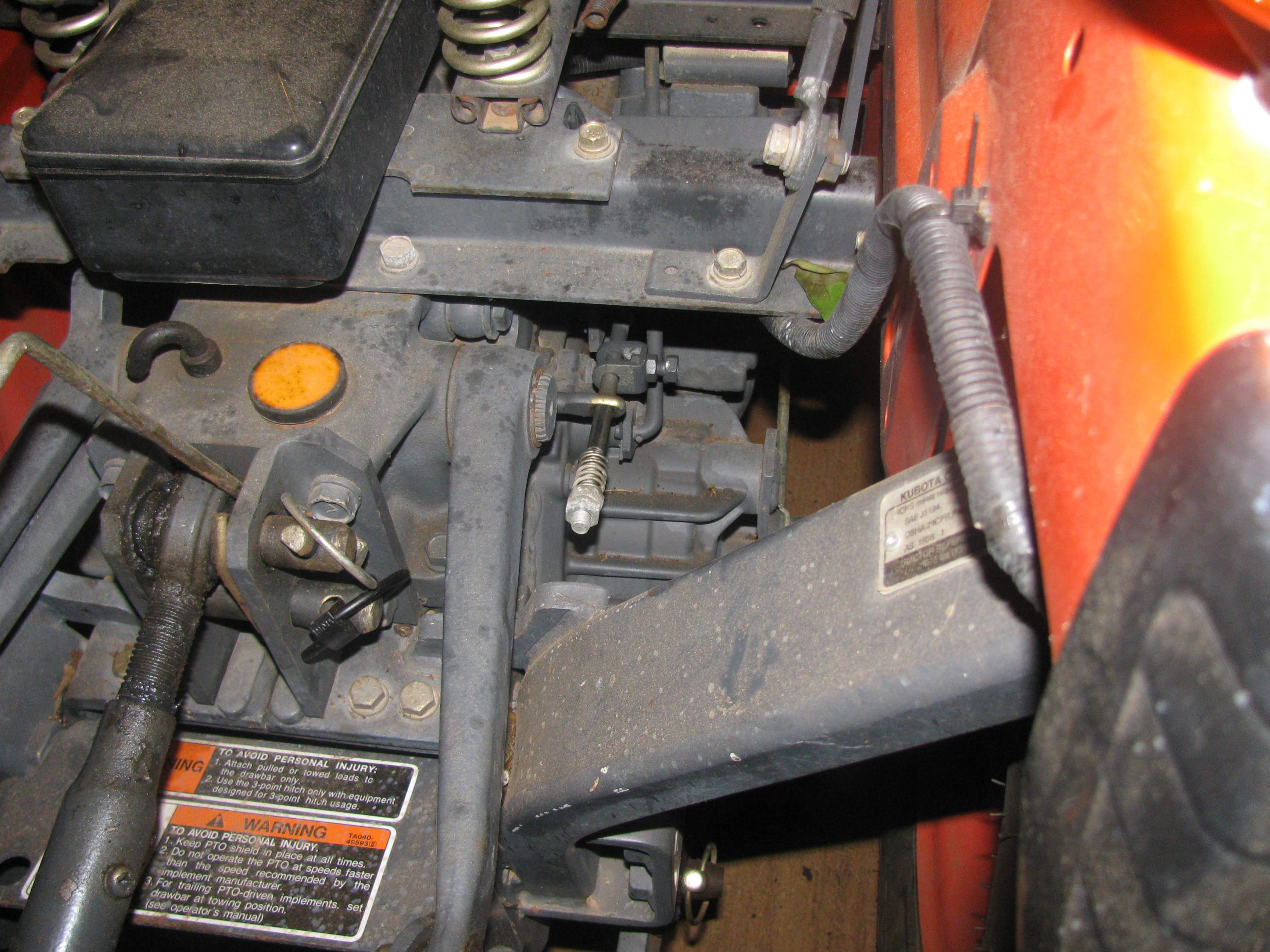

s219 gave you some good direction and there is also an older post on the forum somewhere that is an excellent explanation of the quarter inching system and how to make adjustments to it. When I find it I will post the link in this thread.
Also, the 3 pt can get hard to control due to some binding at the feed back lever. I recommend putting a little grease on the feed back lever where it passes through the feed back pin to prevent this. Doing this really smoothed mine out. See pics.
