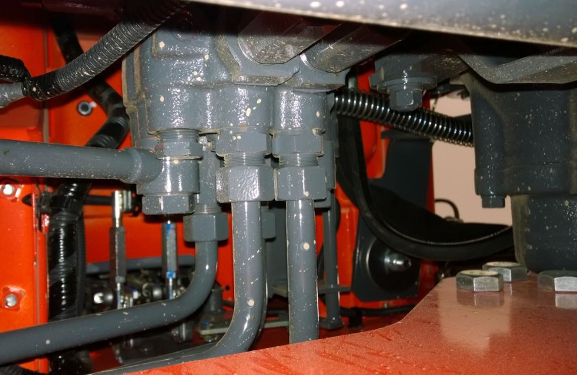

Here is what I see on my tractor and please forgive me, I am novice on how hydraulics work but do want to learn.
This is a picture of the FEL hoses connection. This is where the FEL connects to hoses which those hoses connect to a junction block.
This picture is the other end of those hoses from the first picture. It just looks like another junction block. You can see the gray steel lines on the other side of that junction that go underneath of the tractor.
This is a picture of where the gray steel lines go to underneath the tractor.
Where does the third function splice into this? Yes, I'm confused on all the lines.
/ Help me understand Third Function Remote please #15
If you buy a kit for your model tractor, it will have instructions. They will tell you which line to remove to connect the third function valve lines. Mine is a smaller tractor and the valve is somewhat different but I think they all probably use the same theory. I had to remove a pipe that went from the valve to the tank. There were two hoses that went into the two open holes that were left. It was pretty simple really.
