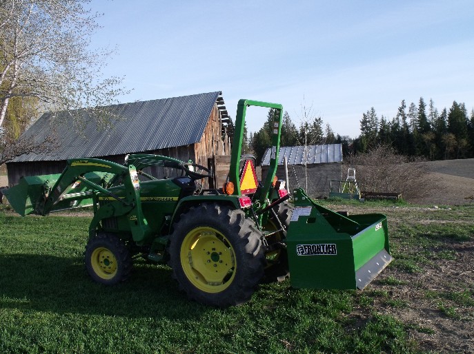

I would lean toward a 60 inch boxblade for your described applications..
I run a 48 inch on my 790 for maneuvering around in the tight quarters of the tree farm when burying spade holes, filling small washes and removing remaining roots after a tree gets dug. .
My boxblade is a frontier BB2048. Its a heavy, very well built little thing. I would recommend getting as heavy as a 60" box as you can, weight is how a box blade works.
Go heavy duty, and 60" you will get years of service from your investment of a boxblade.

I would look for a 54" or 60" used boxblade that is well made. Should be able to find something used for half the price of new.

I would go with a 60", as others have said, weight is a good thing. If I remember correctly, those tracters had a weight bar on the front and was offered with factory weights as a option. Might not be a bad thing to scrounge up some front weights if you dont already have them. I have a 48" I use in the woods for road clearing and maintaining them. I am looking for a 60" to do driveways,dirtwork in the yard, and to get close to things. LUTT

Did you notice this is a 2wd 855?

I don't think the OP would have trouble with the boxblade moving dirt with the rippers up or dropped down slightly. I do think dropping the rippers on a five ft boxblade would do a quick job of anchoring the tractor in place. I use a 48" boxblade with my x749 garden tractor and thats all it wants, My 4520 cab with weights is loaded with my 7' boxblade and that is all it wants. Don't think an 855 would handle a heavy duty 60" boxblade with the rippers down very well.
Ideally something such as the Cammond 54" boxblade would be a better match imo. Here's a link to a 54" Cammond with four rippers that should work well with this tractor. http://cammond.com/Cammond Economy Scraper Series.htm
