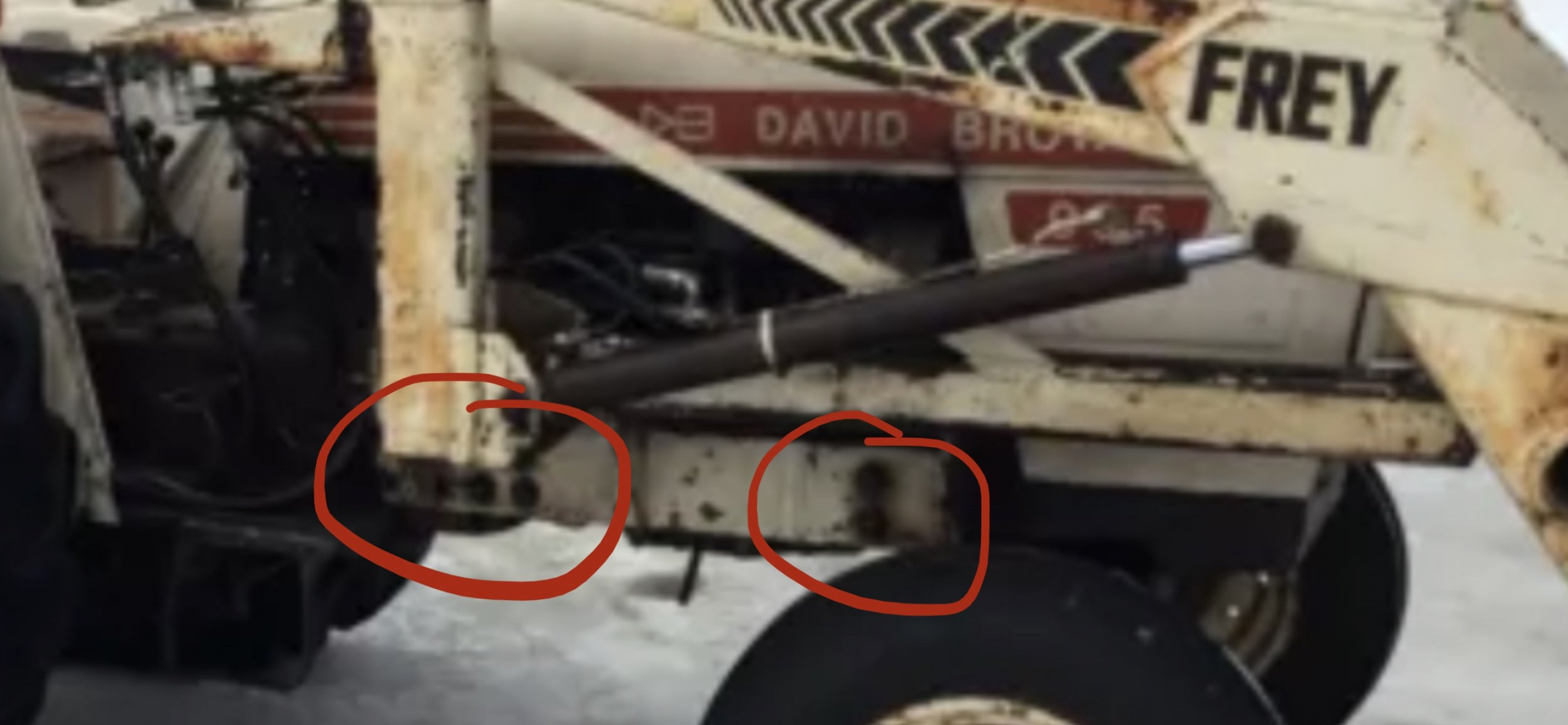

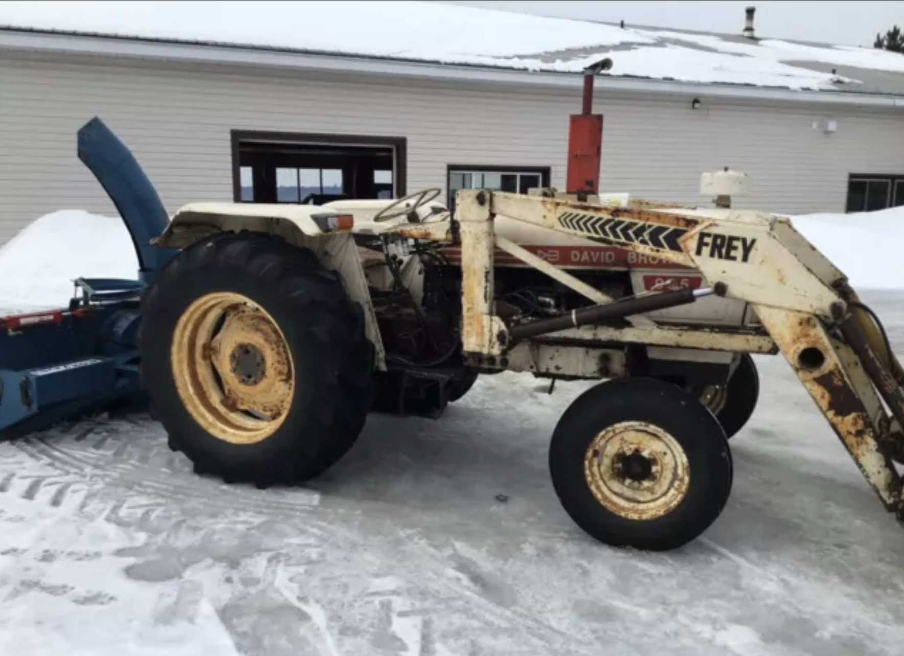

A picture of the right side showed the loader mount a little better. I know little about tractors, other than internet research. Does this look like an appropriate mount?

I worked on these in the early 70's and yes, those are the mounting brackets for the loader. The front frame is part of bell housing frame too. You can see the bolts where the loader mounts are in these pics. TractorData.com David Brown 995 tractor photos information
They have their quirks, but if don't mind turning a wrench, a decent buy given the blower is worth half the tractor cost.

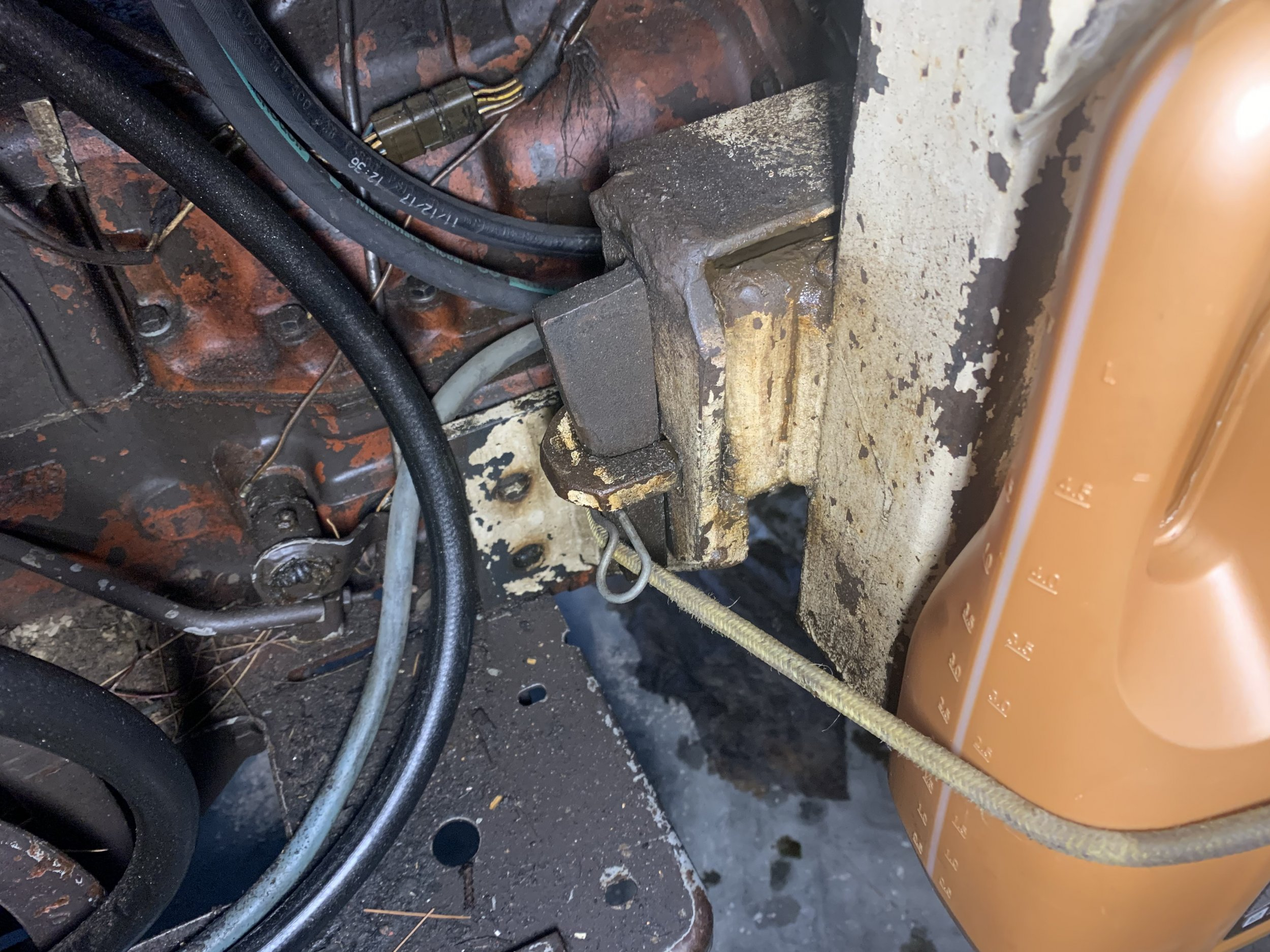

The seller sent me some detailed photos of the loader mount. 4 bolts on the back and two in the front on either side. It’s got a sorta quick detach mechanism for the loader. The crappy looking weld looks like either a repair or something jimmy rigged.
He also fully raised the 3 point with a 1000lb snowblower and it took about 12 hrs for it to settle to the ground. That seems ok to me.

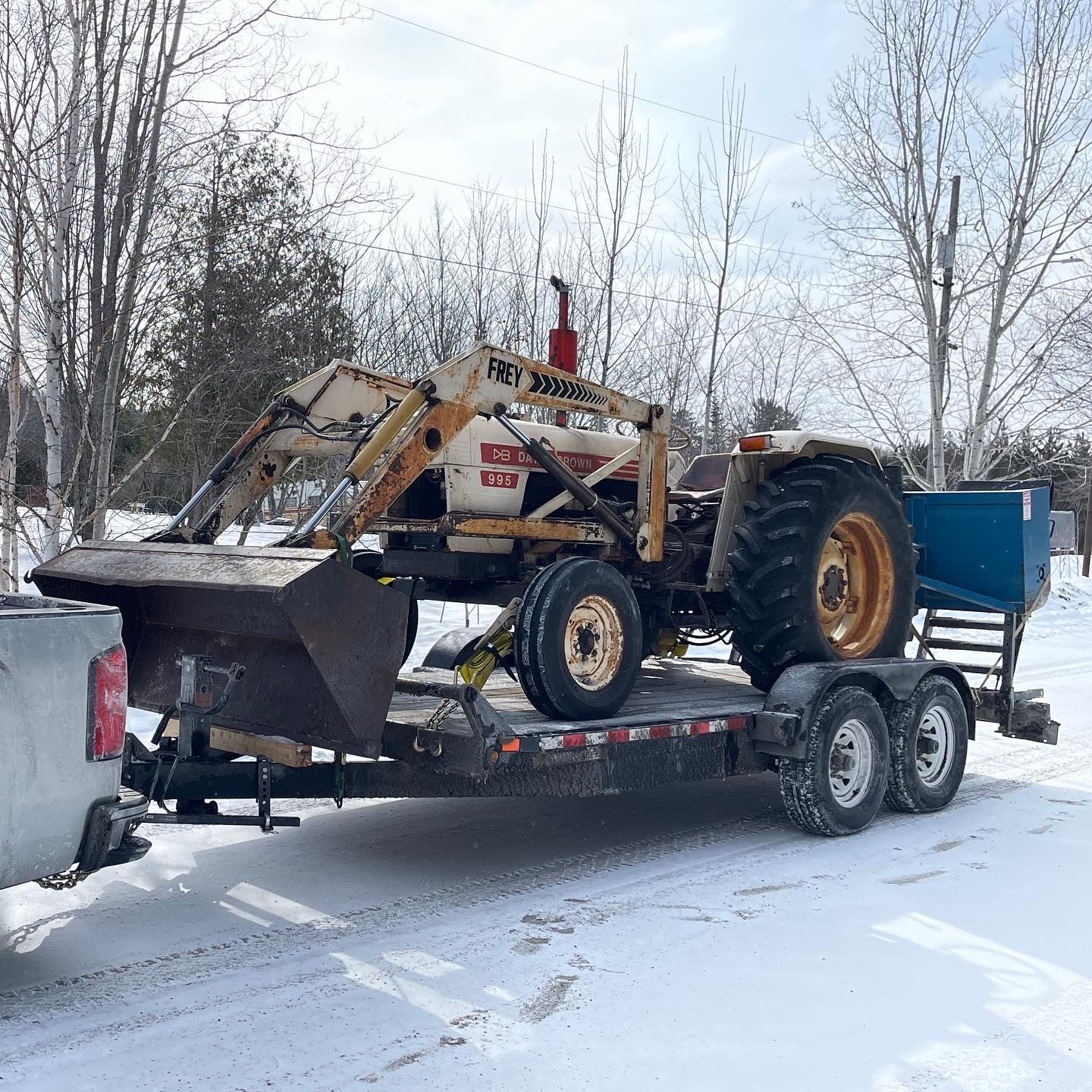

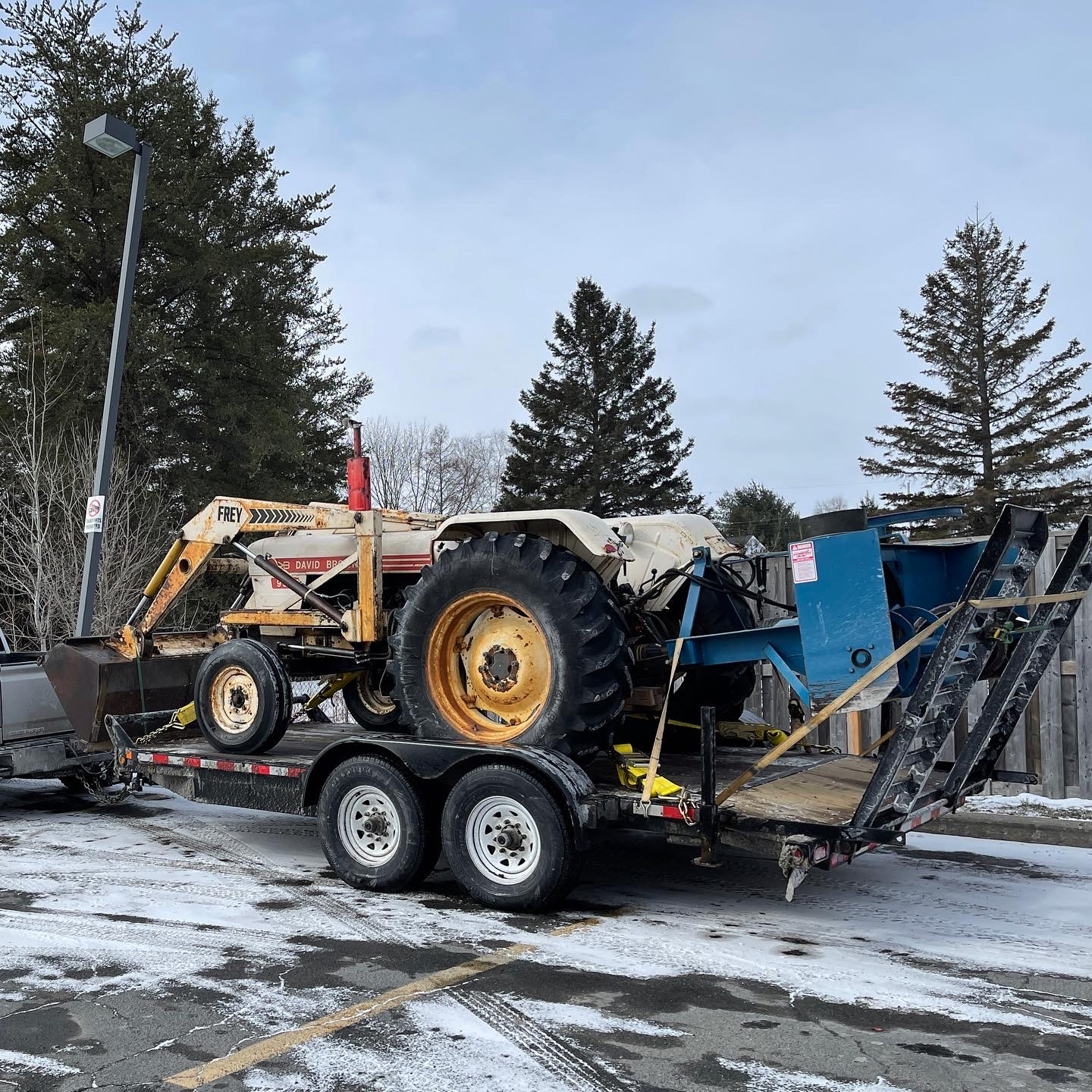

Got her home late last night after a 2000km round trip!

Looks nice, but like it has seen a lot of salt. Probably needs a good wash to get all the salt off and then the project begins! I'm looking forward to hearing about it. Wonder if there are any DB clubs & websites? Congratulations on making the trip.

The trip went way better than expected. This load was at the very top end of my 1/2 tons tow rating. A WD hitch made it drama free though!
After having working the tractor for about almost a week I have chuckled to myself several times remembering your comment of how it appears as though the tractor has been fixed just enough to get by. That is EXACTLY the case with this tractor! Things are just kinda cobbled together. Lots of missing bolts and support brackets. The temp gauge is the only thing that works properly on the dash.
Surprisingly the tractor was fitted with a thermostart (previous owner wasn’t aware). The wiring to the dash switch is buggered, but I’ve just been jumping power directly to it, which has helped a lot with cold starts.
Steering is incredibly loose, and the internal pump seal is leaking which is causing engine oil to be forced into the ps system. (Common DB issue). That’s what the oil bottle is for that’s tied to the side of the tractor. The good news is I can now just dump the ps overflow back into the engine sump! Haha it took me a little while to figure out why the engine was consuming so much oil.
