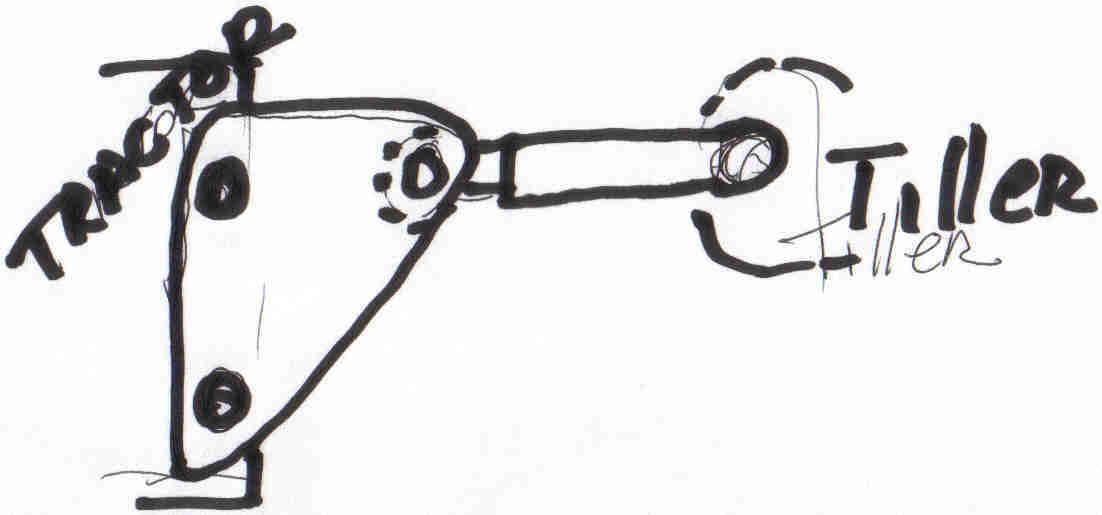

Can anyone help with proper install of that yanmar tiller toplink? I can't figure which way is right side up or not. One way, the horizontal line is at the bottom with the angled line at the top. It also fits the reverse of that. :confused:

Tony are the tines hitting the tires when the tiller is raised? The tiller on mine fits real close to the tractor but that keeps the weight close and you don't have to add weight to front of the tractor. I run the triangle part of the Yanmar toplink with the short side on the top and the long angle running towards the ground. The bar (top link) is about 6 to 10 inches long. I will try to upload a crude drawing of the setup. I would hook up and take pictures but am not able to get to tractor right now. Hope that this helps. big dan

Oldhip (i'm one too), good art work there!

Big Dan, man....thanks for the drawing. That does help alot! I have it the opposite way. I'm also determined to break loose the adjustment on the toplink, as that will let it pull in another 1/2" and may do the trick for me. There are some "paddles" connected to a spring inside the two plates for the toplink plate. What are those for?
The tire isn't hitting tines, just the outer case. Not good either way though.

Tony, I'm not home today so working from memory which isn't the best any longer. Think the skectch provided has the orientation correct. There are several different top link mounts. Believe mine has a decal with the various models it is intended to be used with. There is also some info on length for the link itself. Seem to recall the link dim is on a decal on the tiller.
When properly adj'd the tiller pivots as it is raised and lowered. Even with proper link and adj, the tiller come very close to the rear wheels. I've got one of the harbor freight QM hitches and no longer use the Yanmar top link. I modified the mount on the tiller so it complies to cat 1 stds. Works great for me.

Used the tiller yesterday! I tried every conceavable way to adjust the toplink and bracket, and none mad it any better. Then, I tried using the short 10" toplink without the bracket peice. That was actually an improvement, and I think will work for my purposes. Now it only rubs the tire if in the fully raised position. It doesn't hit when operating. So, I just lift it a few inches off the ground when driving around.
