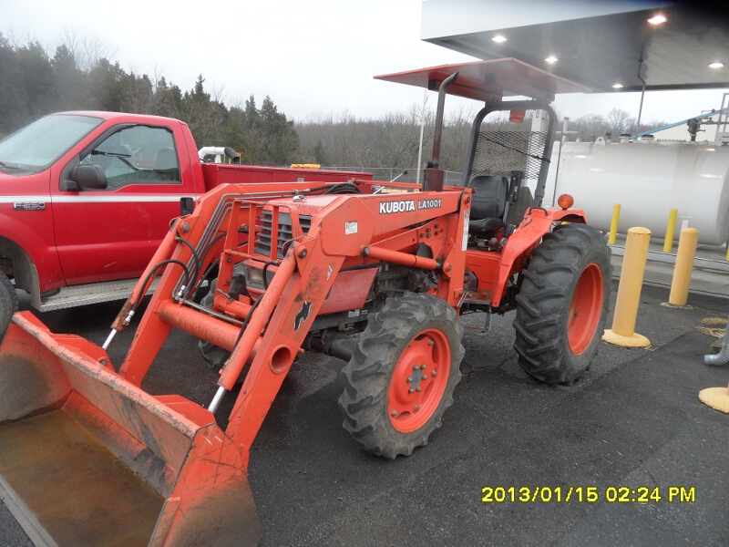

Here's a 50HP Kubota w/ 1400 hrs, FEL, dual rear remotes, Cat 2 3pt, canopy.
457920d1456146770-help-me-find-tractor-manage-8x6sam_0798-jpg
price I paid was about $12,000 at a local public service auction.
Since the date on the photo I've had to replace the 2 front tires, about 5 hydraulic lines (< $300), rebuild 1 FEL cylinder ($50).
I could have gotten a slightly less capable but newer Kubota from Barlow's for $16K.
