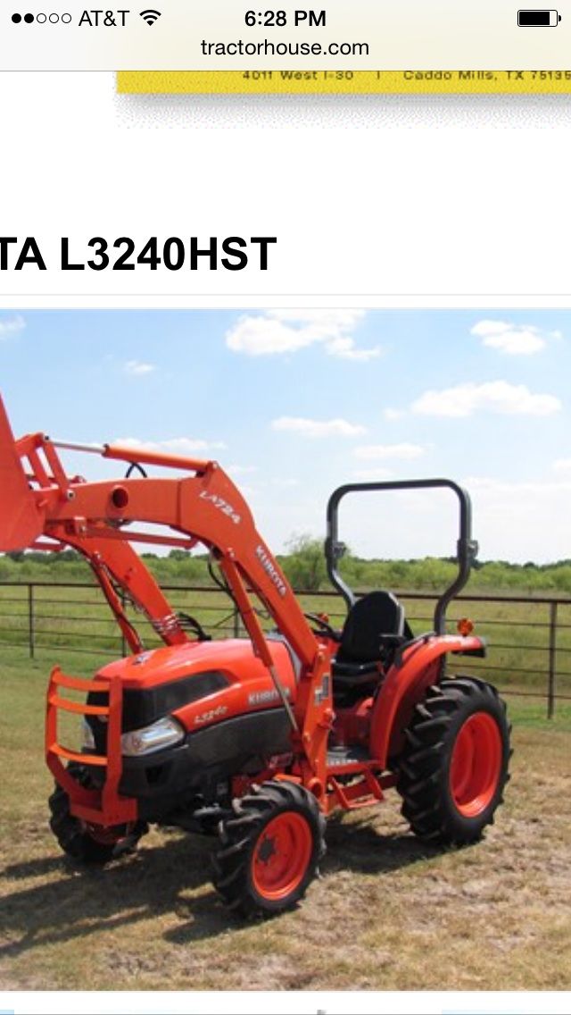

Yah, don't go there if your budget is low, but that used one seemed pretty reasonable for what looked like a well-equipped (big SSQA loader), cherry low hours tractor. I really wish I had the auto-throttle on our L, and I miss the complete instrumentation that the Grand Ls have, like actual PTO rpms, road speed, oil pressure and coolant temp. Not familiar in particular with the L3240, but I'm sure that it wouldn't disappoint. Heck, if Texas wasn't so far away, and it had rear remotes, I'd be interested!
   / Help me find a tractor to manage my 40 wooded acres #123
Problem is that L3240 has the LA524 loader, which isn't particularly strong. If one steps up to the L3540 you have the option of getting the LA724 loader which is way stronger than the 524

Ah, TSO, the Kubota L3240 I am liking does have the LA724 loader- that's why I made the comment "big" loader. All good.
   / Help me find a tractor to manage my 40 wooded acres #126
image.jpg yeah I see LA 724
   / Help me find a tractor to manage my 40 wooded acres #127
My mistake... I thought the 724 was only available on the L3540 and L3940.
Looks like a good machine!
