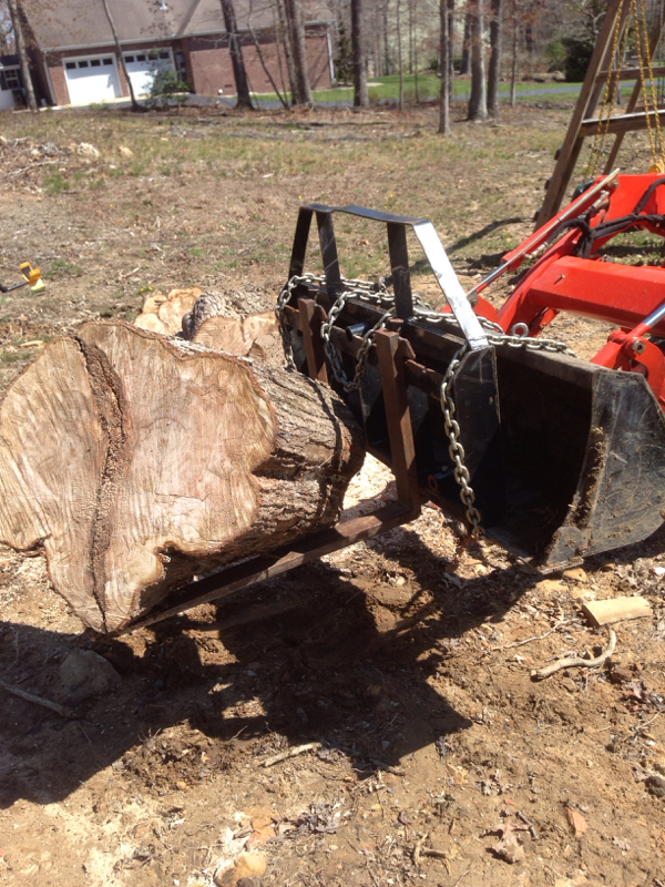

I have chained a set of SSQA forks in a bucket. My loader has SSQA, but this tractor didn't. It didn't work very good at all, but beat no forks. Clamp on forks would have been better.
   / Help me figure out clamp on fork lifting capacity #22
I'm now leaning towards skipping the clamp on forks. Going to ask my dealer if he has a blank plate that fits my loader. Then I could buy some used forks and weld on the plate.

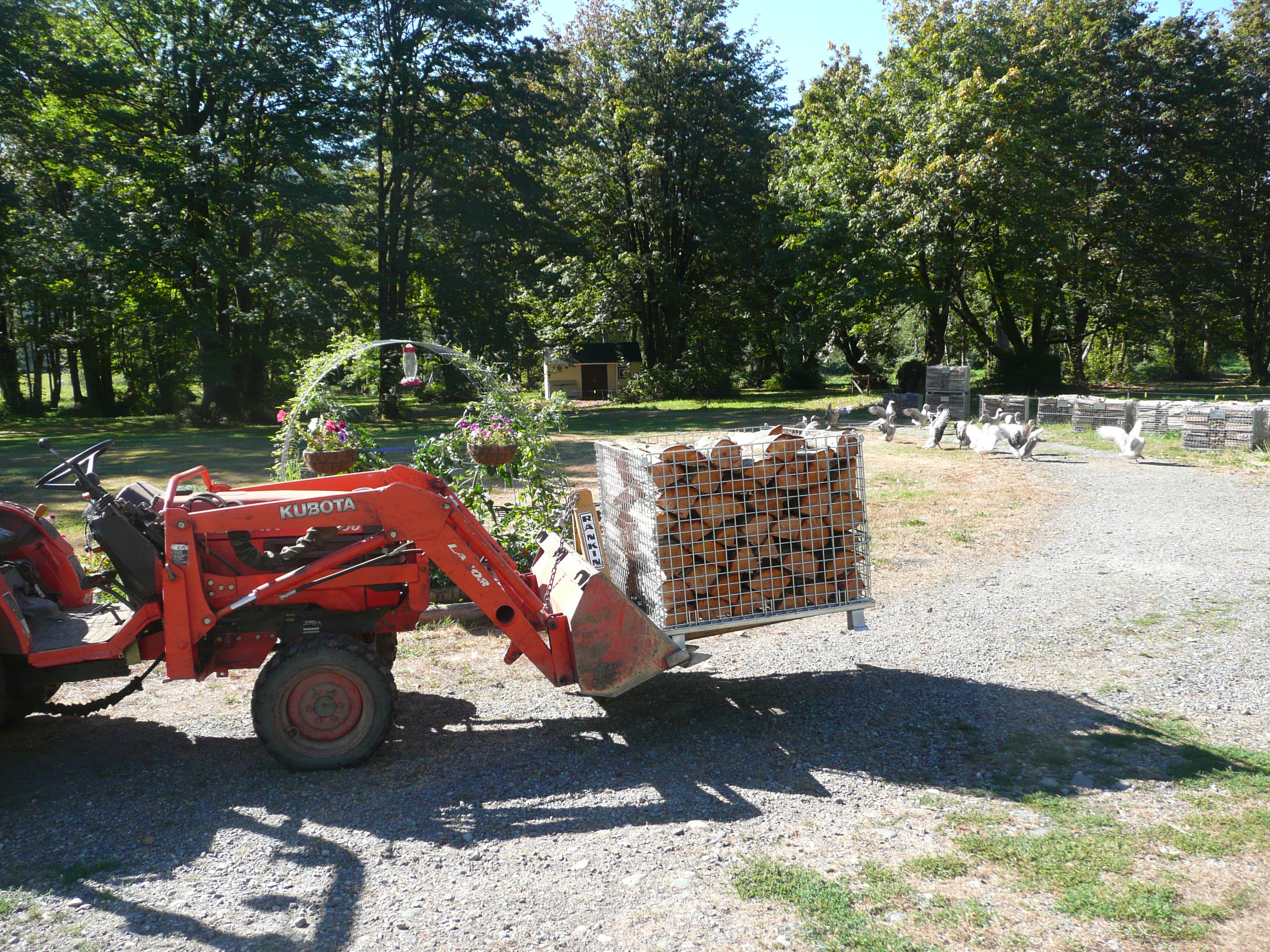

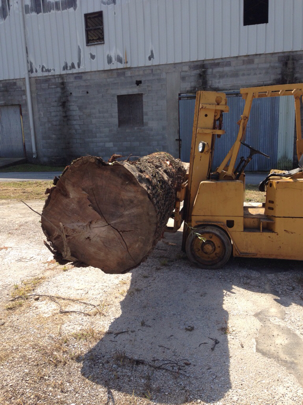

4570man, yeah, I do this too:
Poor B7800 is about maxed out lifting these. In the process of buying a new, bigger tractor that's got SSQA and will have pallet forks!
   / Help me figure out clamp on fork lifting capacity #24
I'm actually surprised at the B7800 lifted it. How much would you guess that crate weighs? I use my forklift to do as much of the heavy lifting as possible.
   / Help me figure out clamp on fork lifting capacity #25
This particular crate wasn't packed, and it had some wood that had dried out a good bit. Maybe 500 lbs? Not sure. I know that I've had it straining really hard, such that I could just get a crate off the ground to move it (and steerage was almost impossible- in my picture, in the background you'll see a crate stacked on another- this was exceedingly difficult as I could just barely get that crate up there and that the steering once almost nonexistent). We're talking max about 1/4 cord. Loader capacity is supposed to be something like 880 lbs at the bucket center. Being tipped back and with the forks resting back inside the bucket a bit helps bring the weight back. Note that I just recently acquired these crates and filled them. This was the plan; but, I was pretty sure that they'd be more than the B7800 could really handle- I had already been planning on purchasing another piece of equipment that could handle them: even considered a fork lift, but since I want something that can run a bigger mower and move more weight around my property I decided to go with another tractor.
