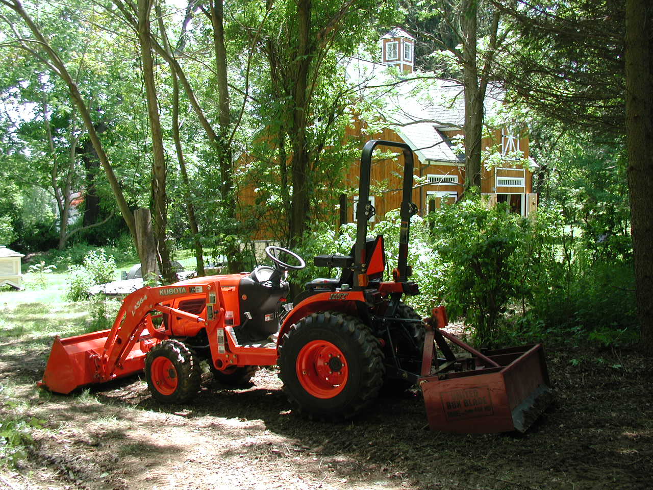

I have had a Box Blade by United for over 7 years now. I used this on my BX22 and now my B2920. I was and am 100% satisfied.
Take a look at the pictures under this link - the area where you would pin the 3 pt is one of the best I have seen - for the money this is a very very stought design. I cant beleive there is much better.
Also, the second link has a very nice video on how to use a BB if your interested!
