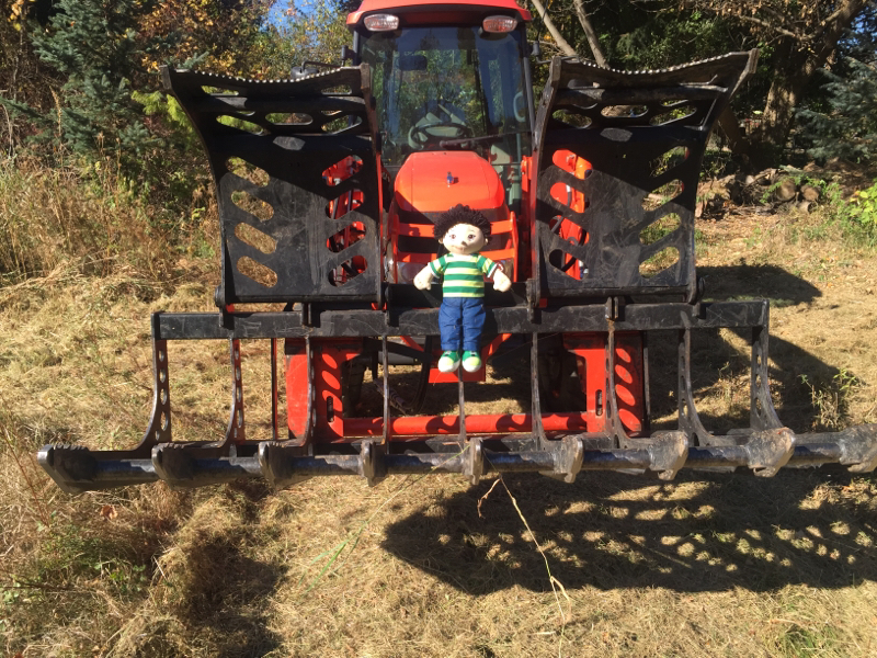

I like 60". Single or double is up to ya! $300 difference and I haven't heard of any game changing limitations of one vs. the other.
Travis
And now........A subliminal ad from our sponsors! :D

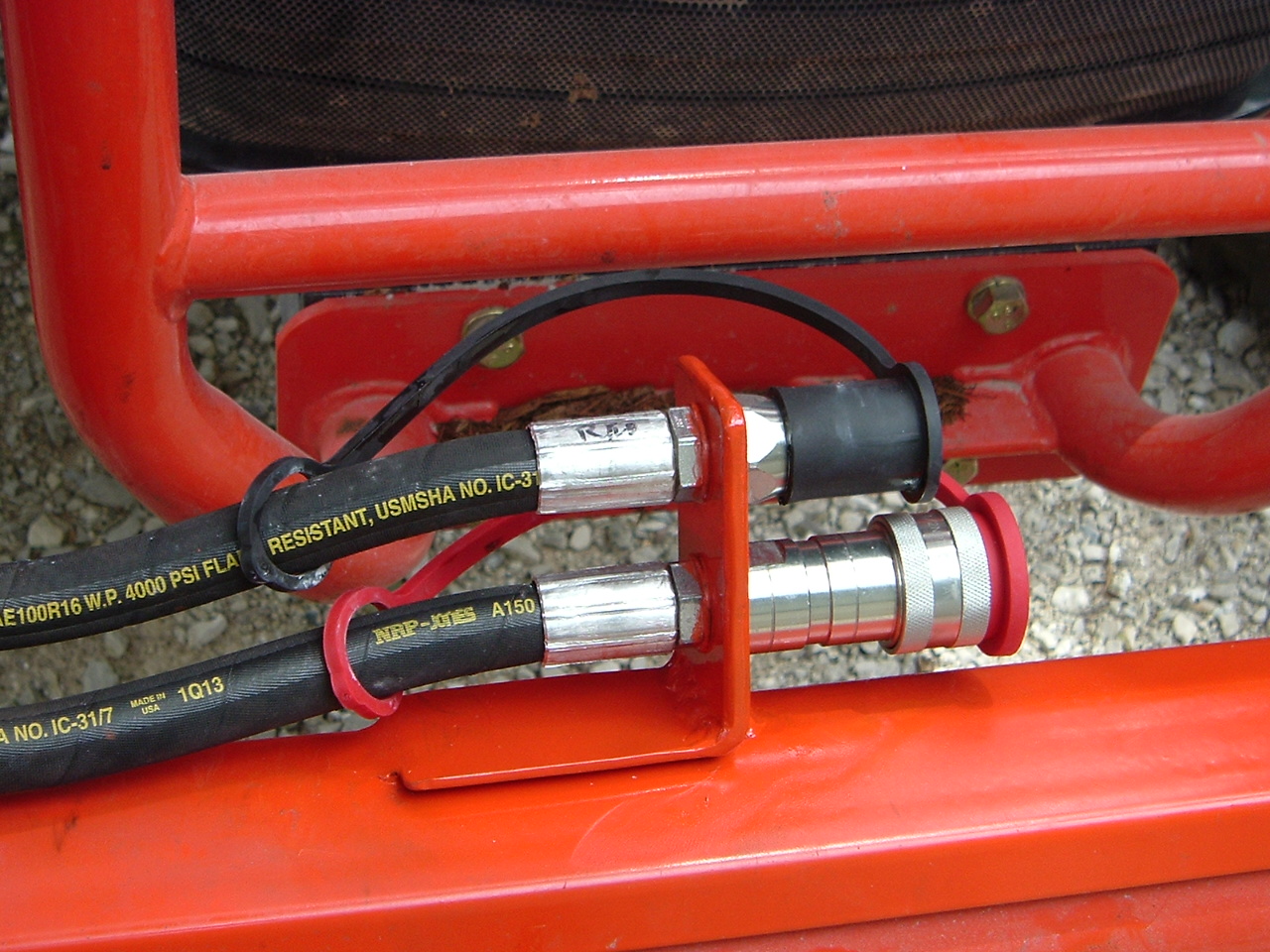

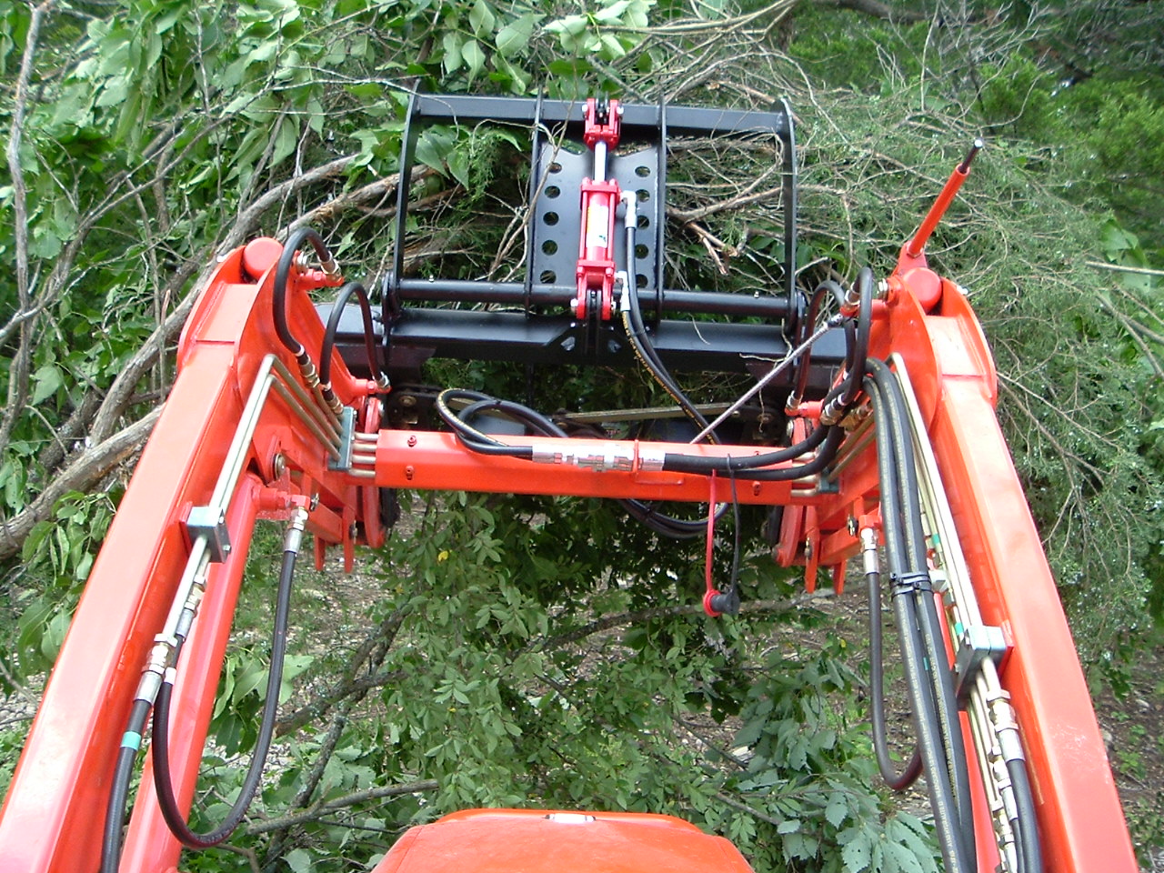

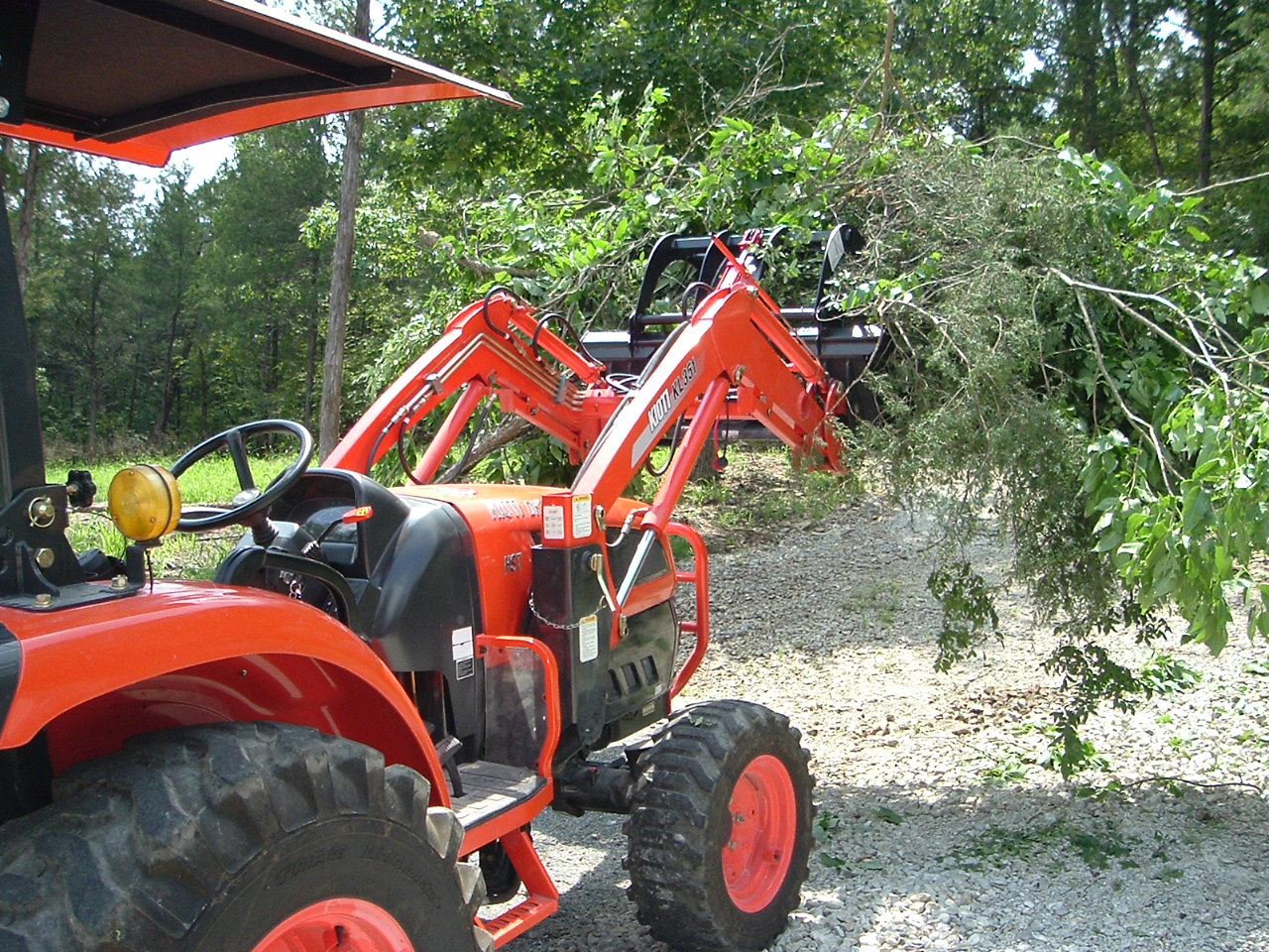

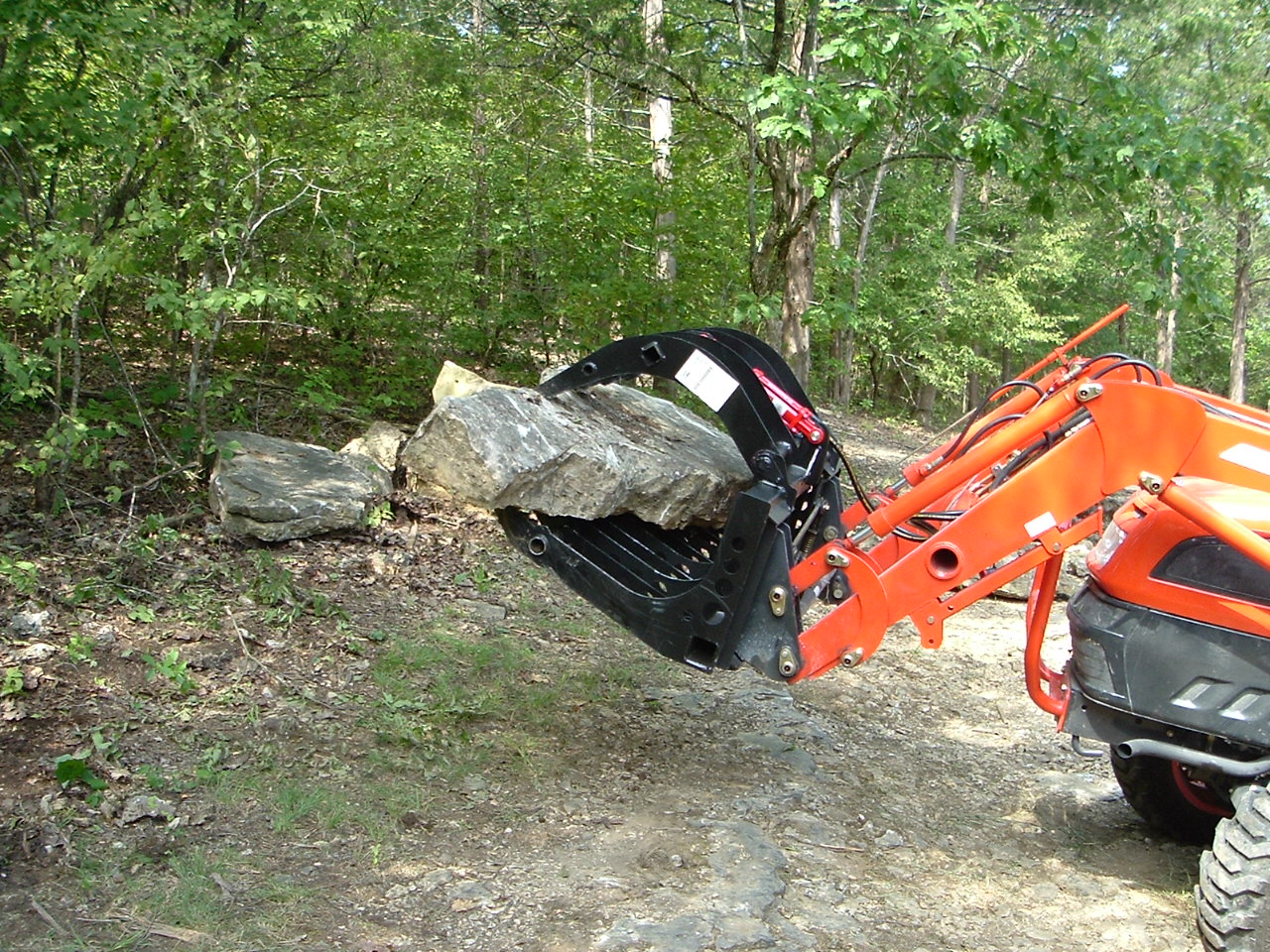

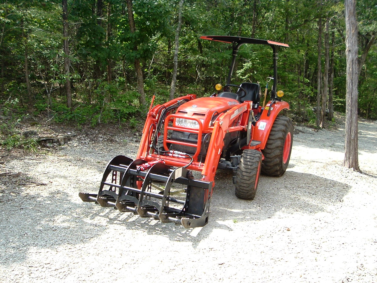

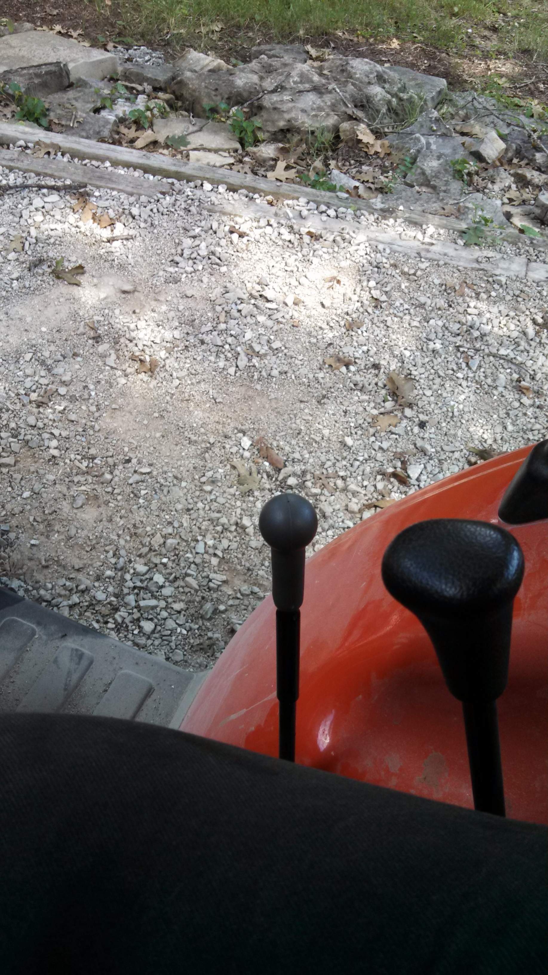

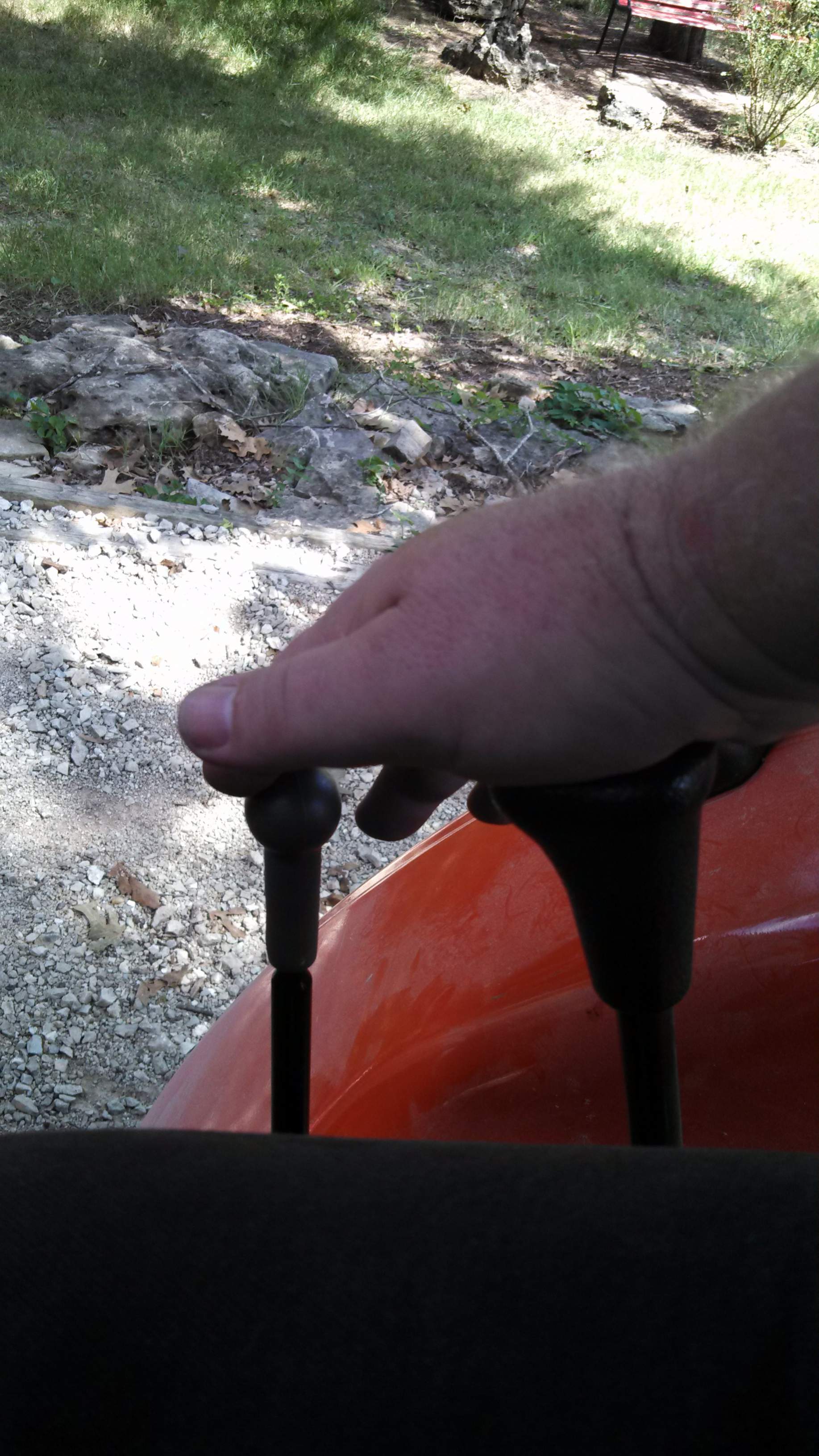

I have the single lid EA grapple, and it works fine for me. I am using a rear remote to control the lid. I did lengthen the rear remote lever to make it more convenient to operate.installed 1.jpgin use.jpgDSCF0554.JPGDSCF0550.JPGDSCF0547.JPGDSCF0551.JPGDSCF0527.JPG

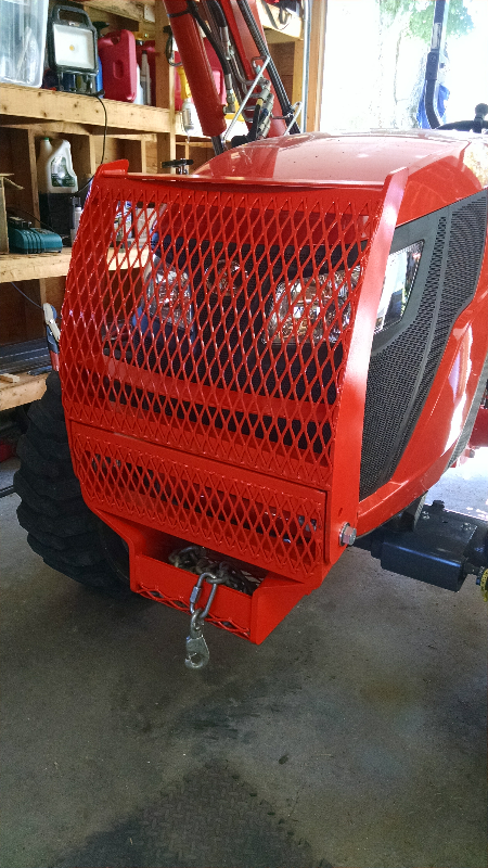

I have a single lid grapple - Land Pride SGC1560. I sprung for the $$$ and had the dealer install the third function. I find I use it so often that the bucket is seldom on the tractor. Its a very HD grapple but my experience told me to go this way and avoid "grapple damage".
I would definitely recommend the third function AND beef up your grill guard to protect the radiator. Lots of threads on TBN where folks did this after expensive damage.View attachment 445330View attachment 445331
   / Help me choose a grapple #10
Extremely good point about the grill guard!
