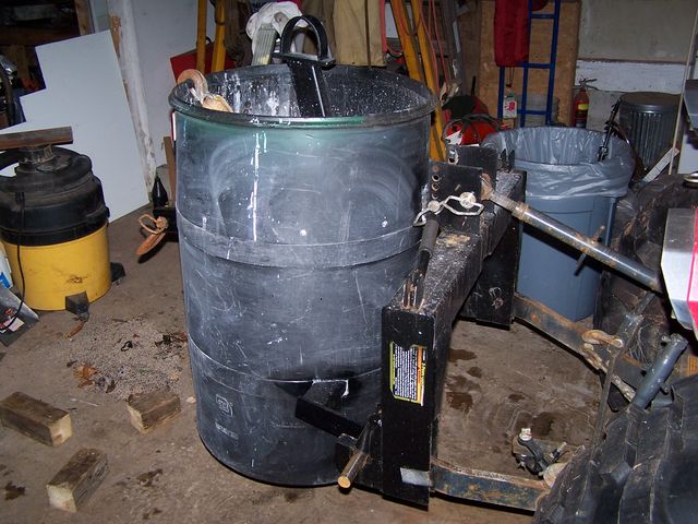

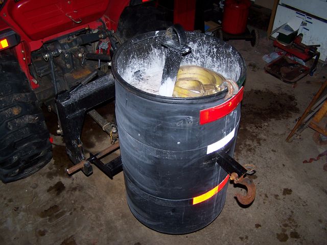

Don't know what your 2210 weighs. I have a 26HP Mahindra that I made a rear ballast for. I used a plastic 55 gallon barrel, welded in some cross supports and bracing, then filled it about 3/4 full of redi mix cement. It weighs about 800 lb. You may not need that much, maybe 500 lb would work for you. The barrel doesn't stick back as far as a rear blade. You could make one similar and fill it with cement or sand or whatever.
