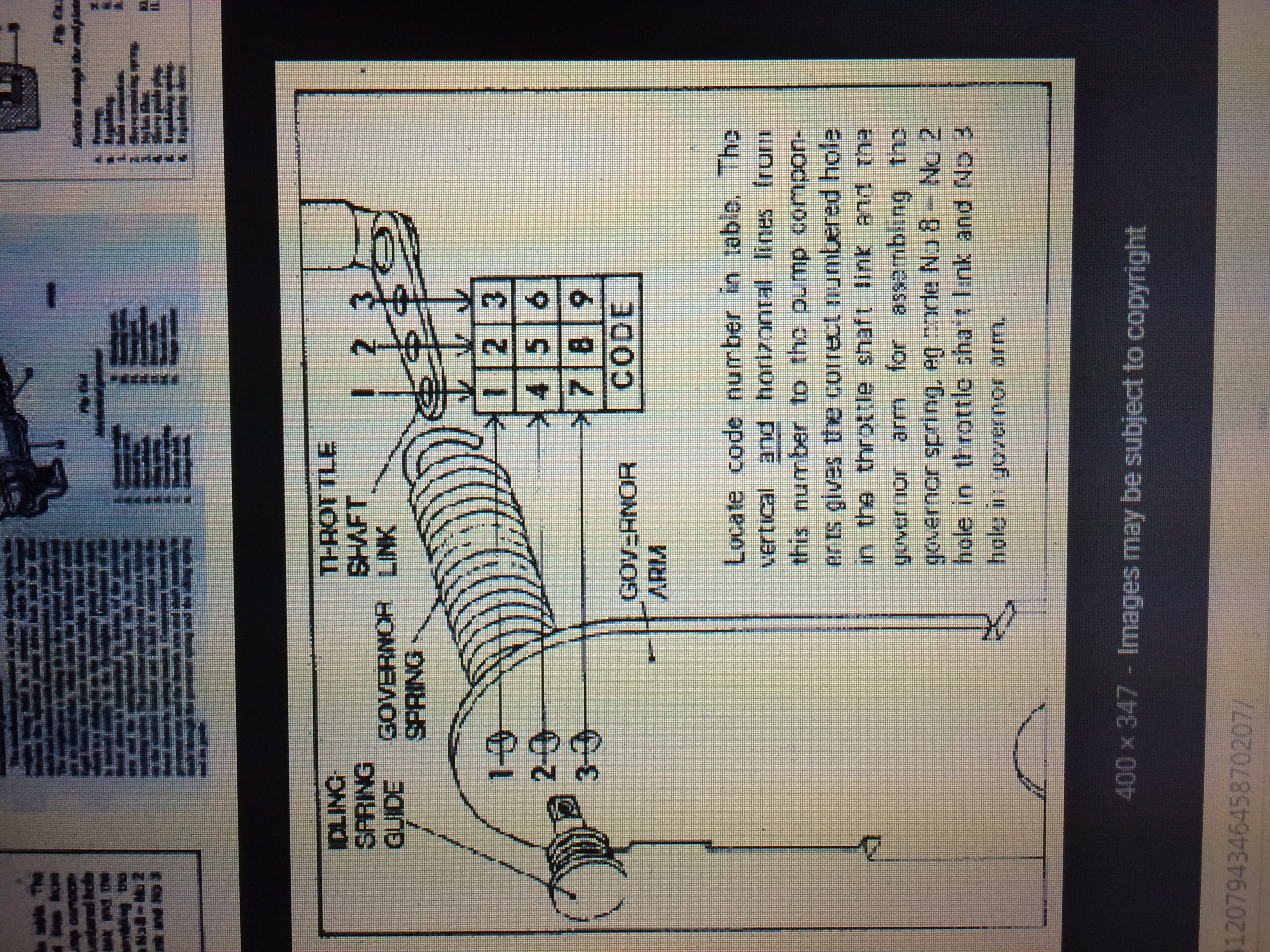

Hi
I have Lucas cav injection pump on my Perkins 3.152 engine. In the process of changing the gasket on the top cover of the pump I removed the govenor spring from the govenor plate which was located in the bottom hole. Then proceeded to pull the cover off and the other side of the spring popped off of the throttle linkage. And I am not sure which hole it was in. After researching online I found a chart where you can match the code number up to the chart to see what hole the spring is located in.
This is all the info I took off of the Tag on the pump:
Type: 622
DPA: 3230F550
SER: 37700 E66
MOD: 2643B129AW/8 1800
Other numbers stamped on the actual pump itself:
767A
49635
Any help would be appreciated!
Thanks
   / *help* Lucas cav injector pump govenor spring location *help*
#2
   / *help* Lucas cav injector pump govenor spring location *help* #3
Look for the bright spots where the spring was
Really can’t tell there is little to no wear on the linkage
   / *help* Lucas cav injector pump govenor spring location *help* #5
if im reading your model info correct your code is 8 .
   / *help* Lucas cav injector pump govenor spring location *help* #6
Spring code IS "8".. follow the chart.
   / *help* Lucas cav injector pump govenor spring location *help* #8
Gottcha thanks everyone
