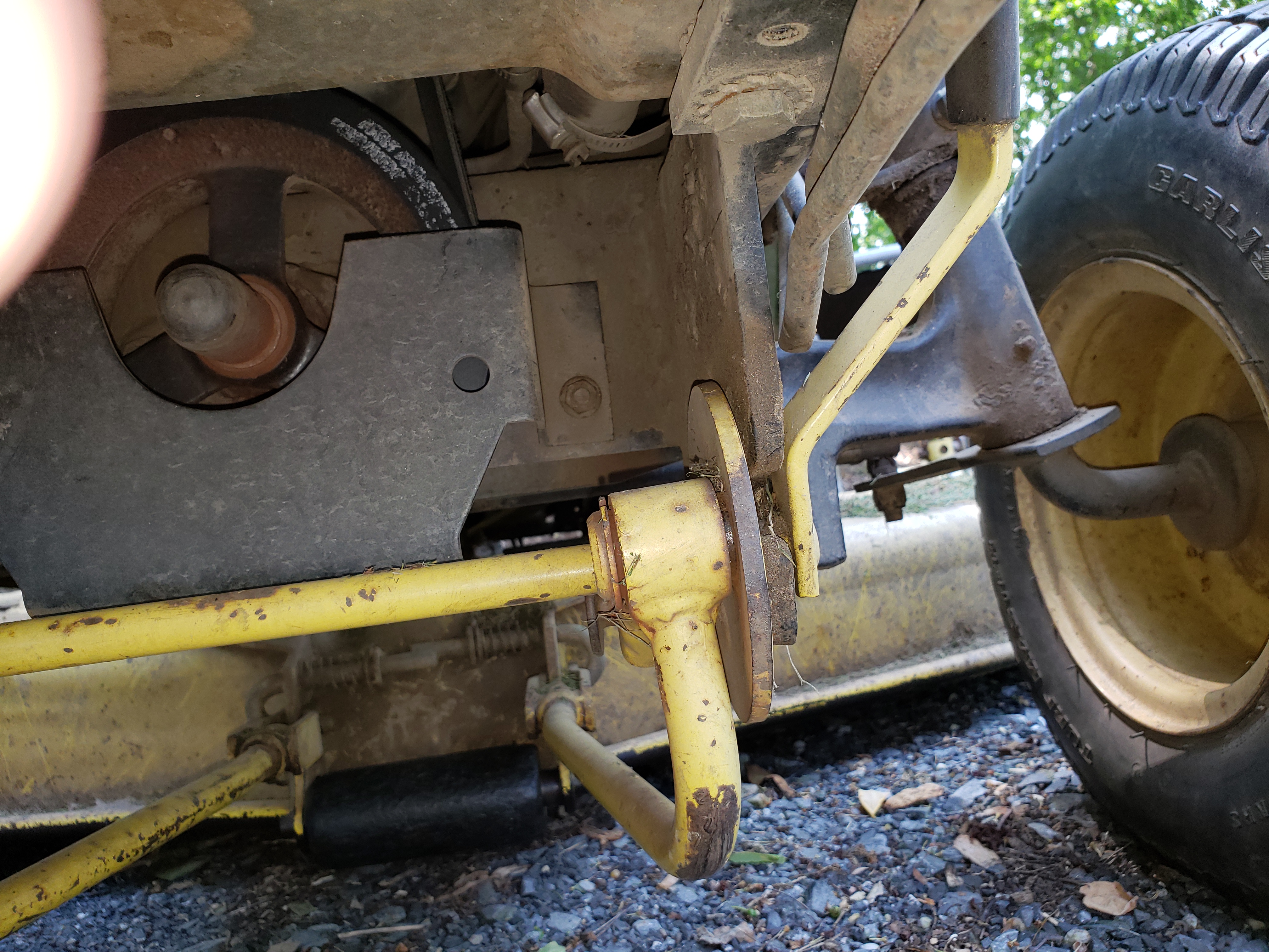

I have a John Deere 430. Removing the mower deck is a pain. There is a lever on the left side, and you pull it to rotate a part that connects two arms to the deck. The rotating part has two big flanges that press against the inside of the frame. It's supposed to be loose enough to permit the part to rotate pretty easily, but on my tractor, it's very tight, making reinserting the part very difficult.
I assume this is a defect. Surely they don't expect you to use a hammer every time you install the deck.
The part number is AM39379.
I was considering putting a bottle jack between the frame rails and bending them outward a millimeter or so, to loosen it up. Then I wondered if this was likely to split whatever connects the frame rails.
Can anyone here give me advice? I hate it when things that are supposed to be fast and easy to take apart turn out to be scams.

Can you take a pic and post, I have a 430 with a 60" deck, so I can help but need some more info. I think you talking about the lift arms and the quick release pins???

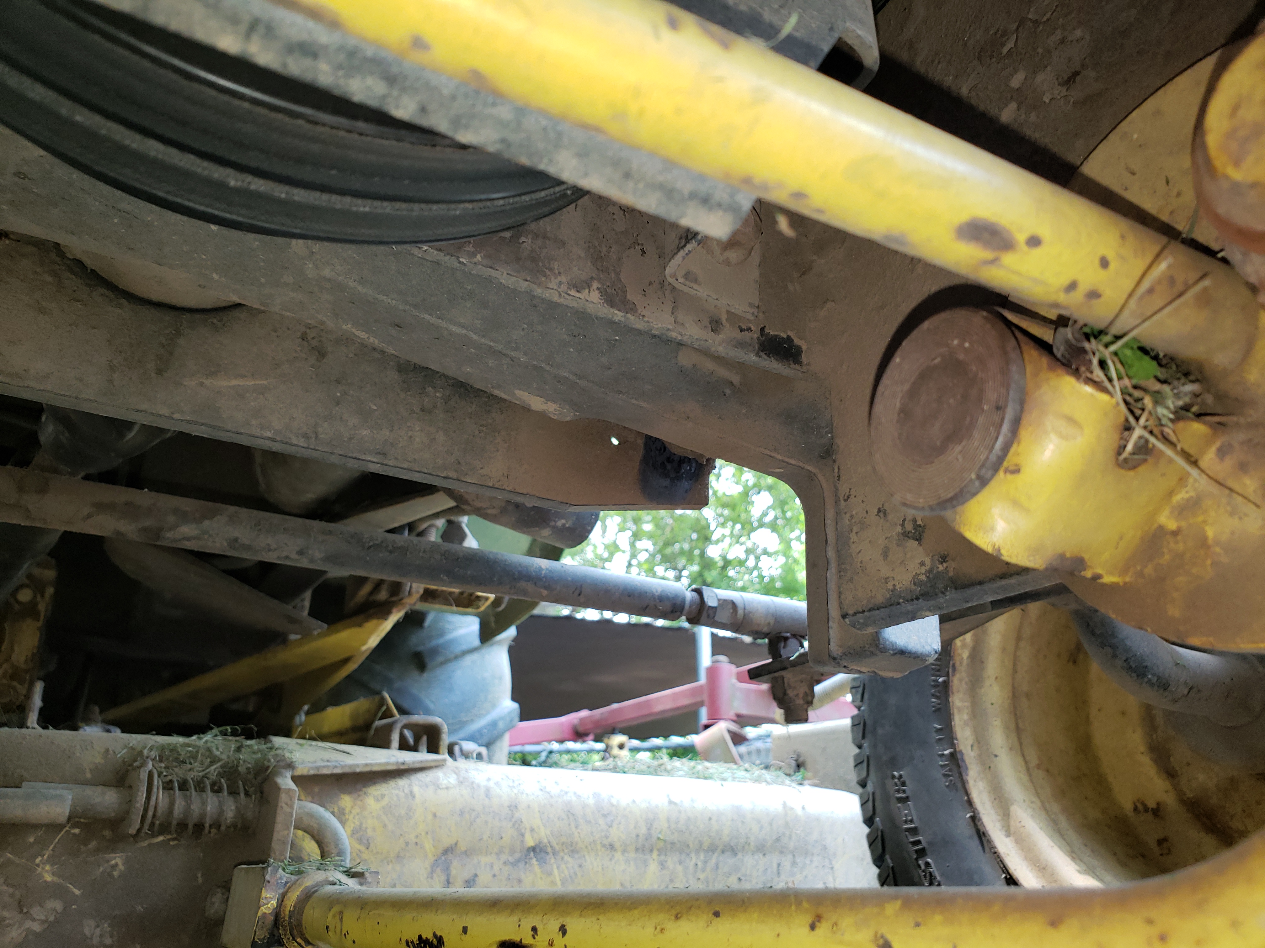

See pictures.

I spray the surface that fits inside of the frame and the inner part of the frame with a dry lube. Plus you have to get that pin to move freely also.
/ Help Loosening up #9
If it were mine, I would remove the deck and take a flap disc to both rubbing surfaces. A few thousandths off would not hurt a thing.
A flap disc like this; 4-1/2 in. 36 Grit Flap Disc
If you do not have a grinder, you can use a large ******* file. (remember files should only be used on the push stroke)
/ Help Loosening up #10
As others already said also anti seize the living heck out of it.

The part number I gave is correct.
BG71361's pictures show the correct part. Yes, I pulled the pin. I don't have the tractor here with me by the PC, but I don't think you can remove the deck with that pin in place. I believe it prevents the part from rotating.
Maybe worn and need of a replacement.
If it were worn, it would be easier to use, not harder.
Far as I can tell, there is no need for these parts to fit tightly.
It's really funny. I found a video with some model dropping the deck in about thirty seconds, without getting on the ground. No, sweetheart. It doesn't really do that. Maybe it works that way after the advertising team works the tractor over with an angle grinder.
It's nice to have a good clear photo of the part in place. It looks like a flap disk might help. I was reluctant to scrape off whatever coating John Deere had put on the frame, but I guess there isn't much left after all the years of needless scraping due to an improper fit. I don't know if a bottle jack would be strong enough to bend the frame. It doesn't look like there are any welds down there that could break.
