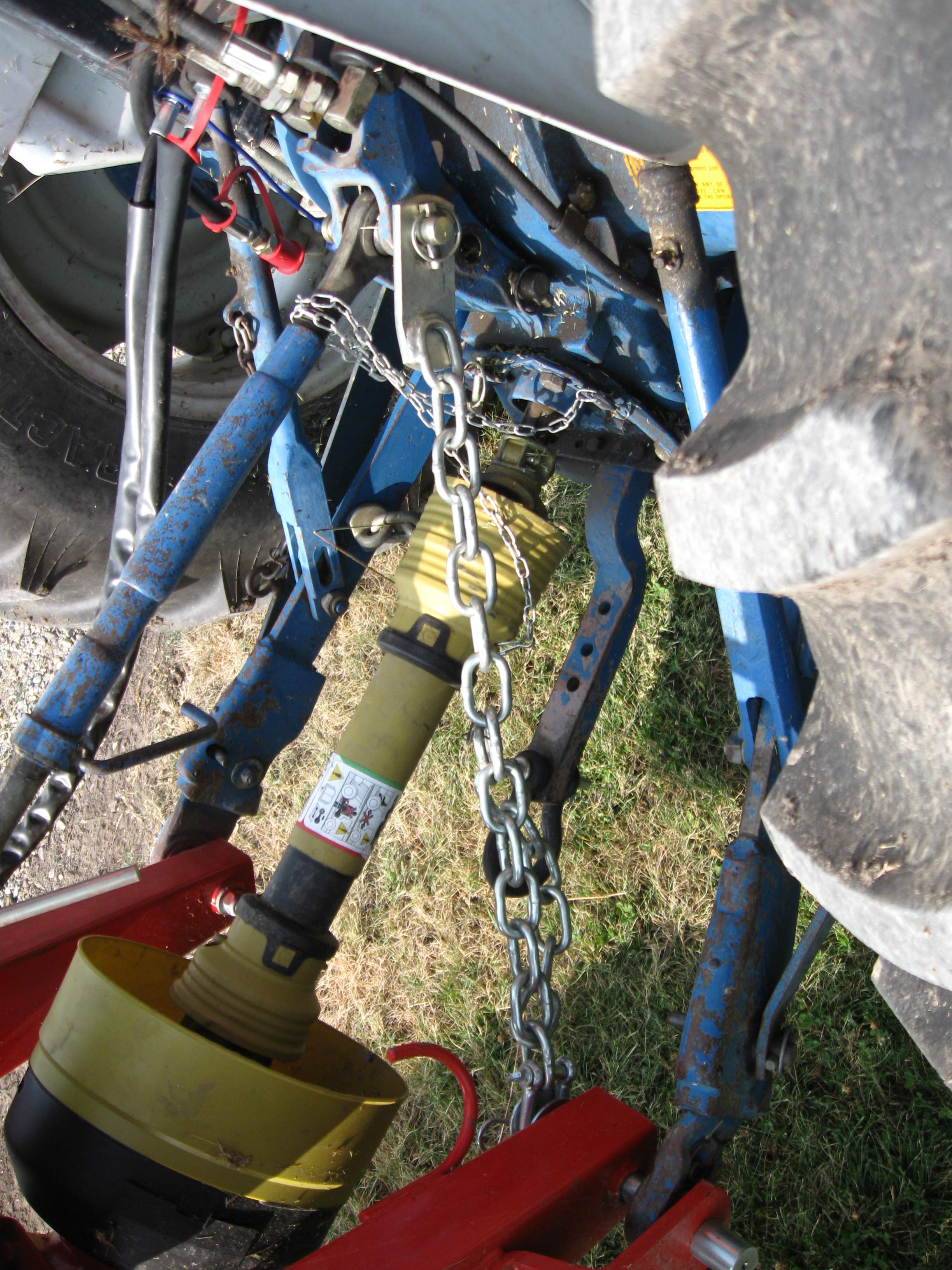

I have a Kioti DK 35 I just got a Kuhn PZ170 drum mower I don't have much adjustment in my 3 point hitch arms and the mower won t. Set level What can I do ????

the mower sits tilted down so the far outside drum is closer to the ground than the inside one There is no more holes in the draw arms to move i may have to drill one i guess i have adjusted the threaded link all the way It does not have much adjustment It sets level front to back .

I have a Galfre 190 drum mower and I leveled it along the roll axis using the chain provided. The chain was attachéd to the pin that's used for the top link and then is attached to the right lift arm. It was trial and error to find the correct hook up. See the attached picture.

Thanks Jerry I have been working on that mower between rain storms the last couple of days I actually came up with a similar idea I hooked a chain on the roll bar and the other end on the drawbar to level it out when in cutting position I looked in the Manuel and there is a picture of a piece of chain as a add on piece of equipment but doesn't say we're it goes Thanks for your help now we just need this rain to stop
