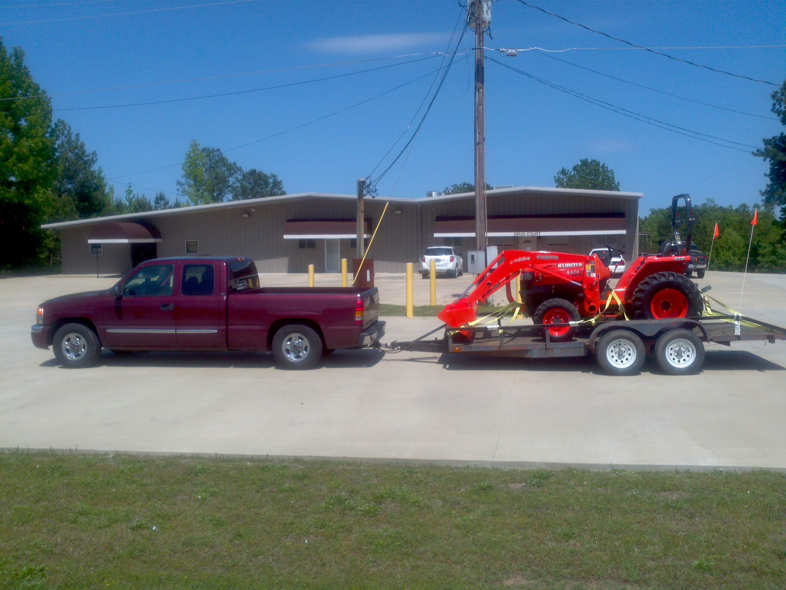

L2800 with FEL on a 16ft trailer.
Get yourself an adjustable hitch so your trailer is level... It'll be better all around... Tire wear, load distribution, towing etc...
Thank you for the advice. If I ever get a trailer I'm remember this. The trailer was borrowed from a friend so I could just get the tractor from point A to point B. This was the first time I'd ever hauled a trailer this long and did it with a tractor on it. It would probably helped to have had it about 2ft more towards the back, but it was loaded on uneven ground and when I took this picture I didn't feel like undoing all the straps and restrapping it.
