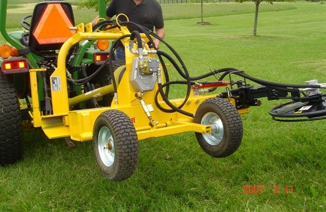

I'm looking to purchase a JD CUT for coffee operations in Kona. In order to begin growing organic, I'm considering a "Mow-Around" from Butler Enterprises in TN. It will reach out under the trees to mow weeds thereby eliminating the need for herbicide.

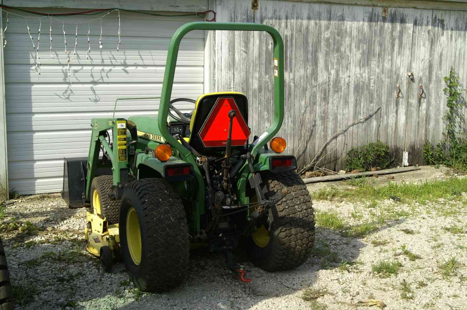

Attached is a photo of the MowAround that would work great for me. The photo shows the south end of a JD. Anyone recognize the machine from the lights, etc?

I am pretty sure that looks like a 855 or 955. I think a 755 would be smaller.
   / Help indentifying JD CUT in Photo #3
Looks like a 755 CUT, like mine.

So, how does a 755 compare to a 2520 in its ability to tow a 1000lb MowAround?
   / Help indentifying JD CUT in Photo #5
The 2520 has 26.5hp while the 755 has something like 20 or 22hp.

Fred,
Having owned a 755, and knowing the capabilities compared to today's tractors and especially the 2210 I now have, I would definately put the tractor in the 2520 class. The hp is somewhat lacking, but the hydraulic power was there.

Looking at the ROPS geometry, I'd say 770, 855 or 955. Rear fenders also look like one of those machines.
