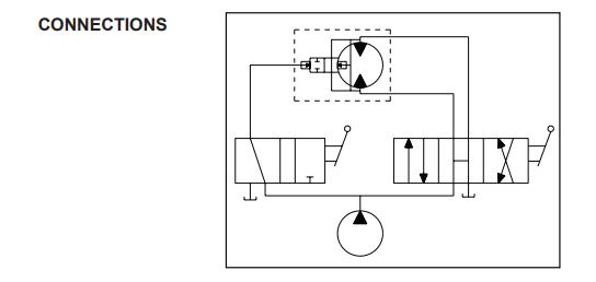

Or why not a simple cartridge sequence valve with reverse flow check? That may be the more convenient way
   / Help in Hydr. Motor with hydraulic clutch port. #12
The sequence and check valve will work as long as the check vents to tank. That would require a motor spool if connected to the motor port.
   / Help in Hydr. Motor with hydraulic clutch port. #13
The real question is what is considered free wheeling,... How much energy (pounds pull) will it take to unspool (freewheel) the cable/winch drum...
The valving is simple, apply pressure to clutch port motor is engaged, remove pressure from clutch port motor disengages, its all there in data sheet....... You are making valving more complicated then it needs to be... Single (one) valve to control clutch, single (one) valve to control motor rotation...

You may be right. Simple is what I want to keep. But addind another parallel circuit adds a TEE, the valve, and a drain. But maybe it can get simpler with a tee in the hose on one work port. That way I do not need the extra valve or the drain. Just because I need only one direction on the motor.
Anyway, its not a big deal now, I believe I got how it works.
Thank you everybody!
   / Help in Hydr. Motor with hydraulic clutch port. #16
I think oldnslow is correct, without pressure to the clutch port, the motor should freewheel.Not sure how well just teeing into the work port is going to work. The port will not build any pressure until there is a load on the winch. In other words, if you pull off more cable than you need to pull your log, will the pressure build up enough to work the clutch with very little line load. No information as to how much pressure or flow is needed to engage the clutch. My next question would be do you intend to mount the winch drum directly to the motor. If so what dia drum would you be using and what would be the line speed. I am thinking 200rpms might be pretty quick with the drum directly mounted on or to the motor shaft. Use of gearing would slow the line speed, but would also make unspooling the winch cable a little harder.

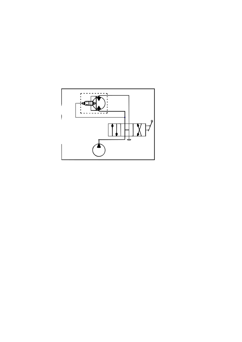

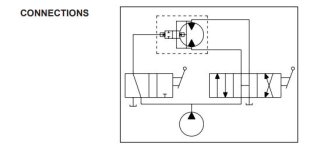

I give it a second thought. In this diagram on their data sheet, clutch-valve.jpg
the clutch port does not really get pressurized in advance, as the oil follow the path of least resistance, which simply is towards the tank through the valve on the right.
So If I do the following connection I do not see why It will not work one direction.
On the reverse, the clutch drains to the tank through the valve.
I will try it, worse case scenario it will not work. Nothing will blow up here. :) :)
