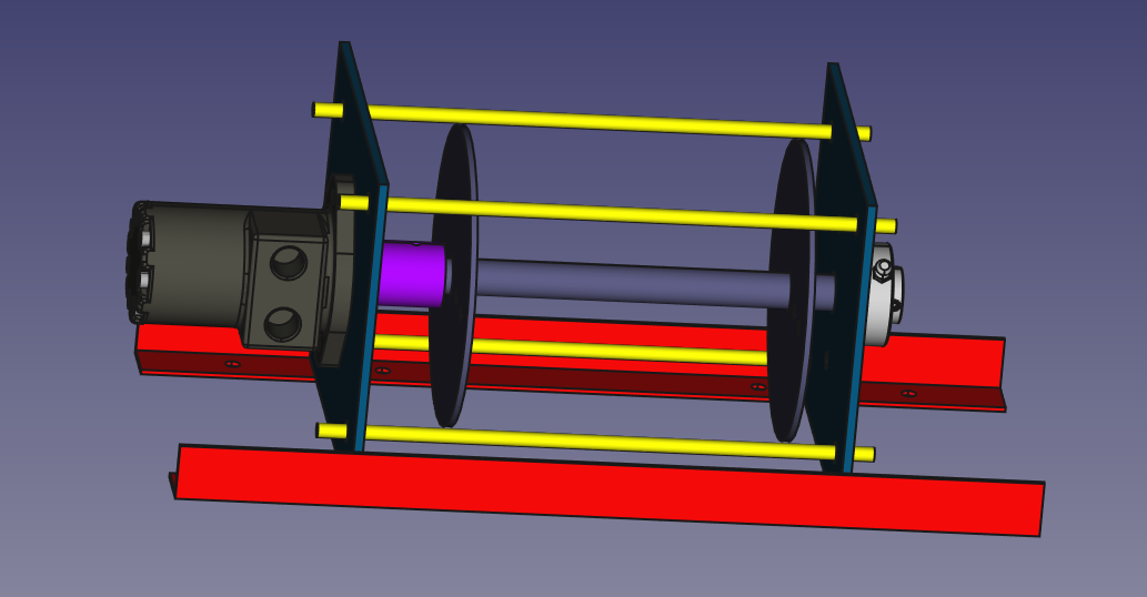

Do you have experience of on how easy it is to unwind a motor that is connected to a motor spool directional valve? (The ones that have the work ports connecte in neutral) That was my 1st approach before I saw that "clutch motor". Will it be realistic to pull a cable out of a spool for 30-40ft or not? I really do not want to design a mechanical disconnect on the winch. Its so simple right now.
Roy what do you think on the priority valve that ptsg suggested? Or what if I put a check valve with 150psi cranking pressure between the TEE and the work port? Then the clutch will get oil first.
A quick hit on the opposite side on the directional valve will vent the clutch to the tank, no?
Anyway I contacted Cross ltd, I am waiting to hear back from them

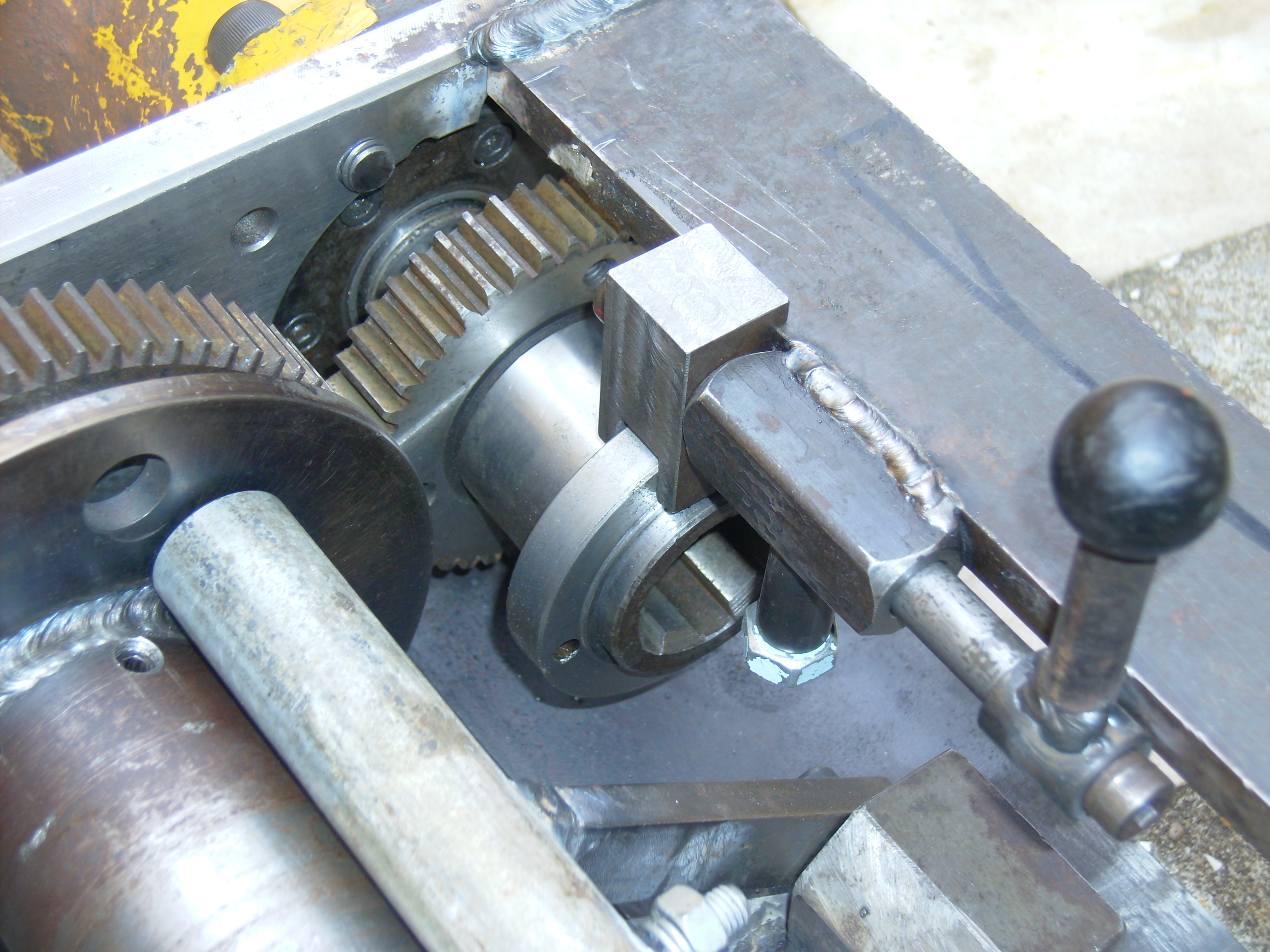

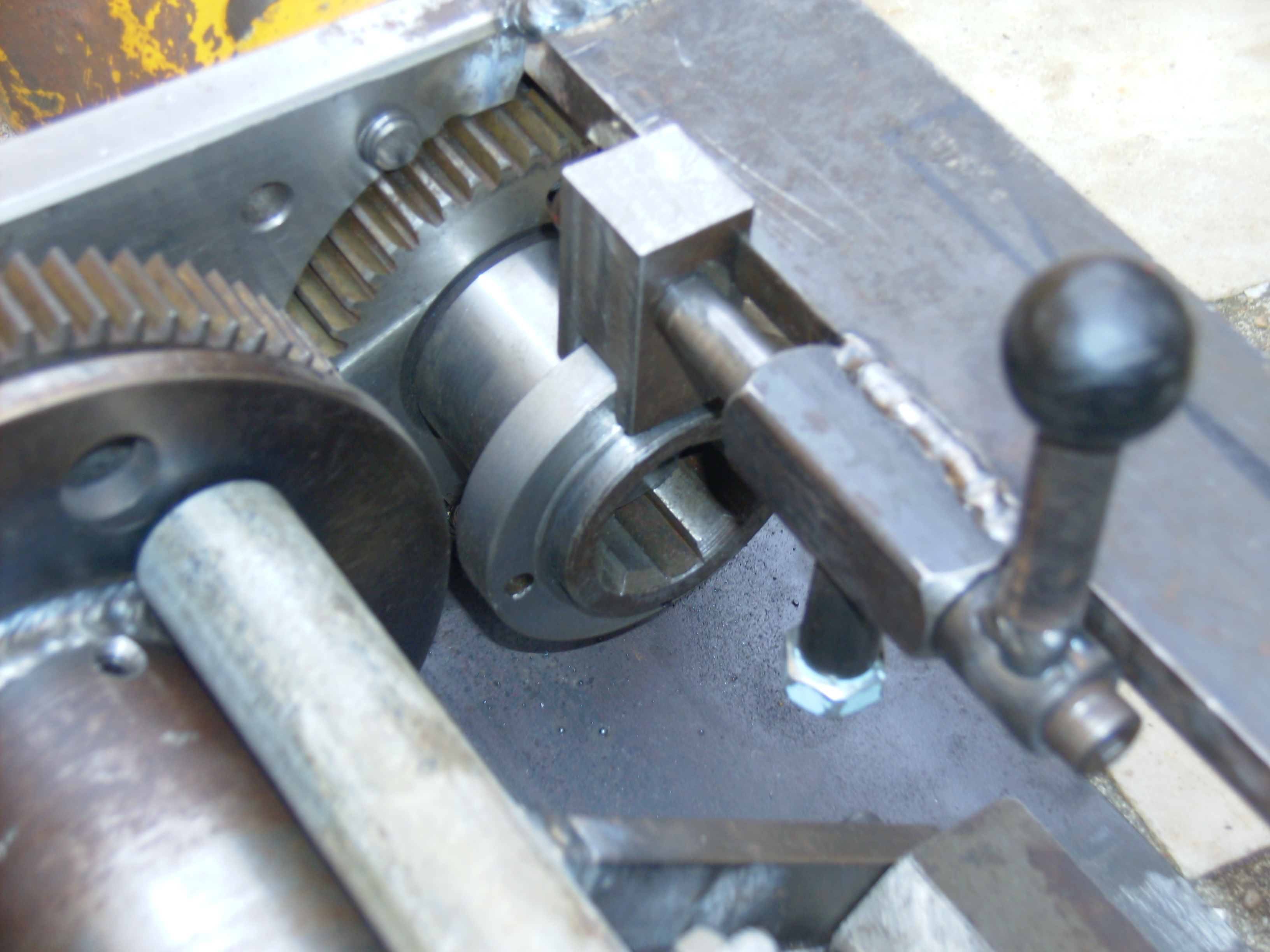

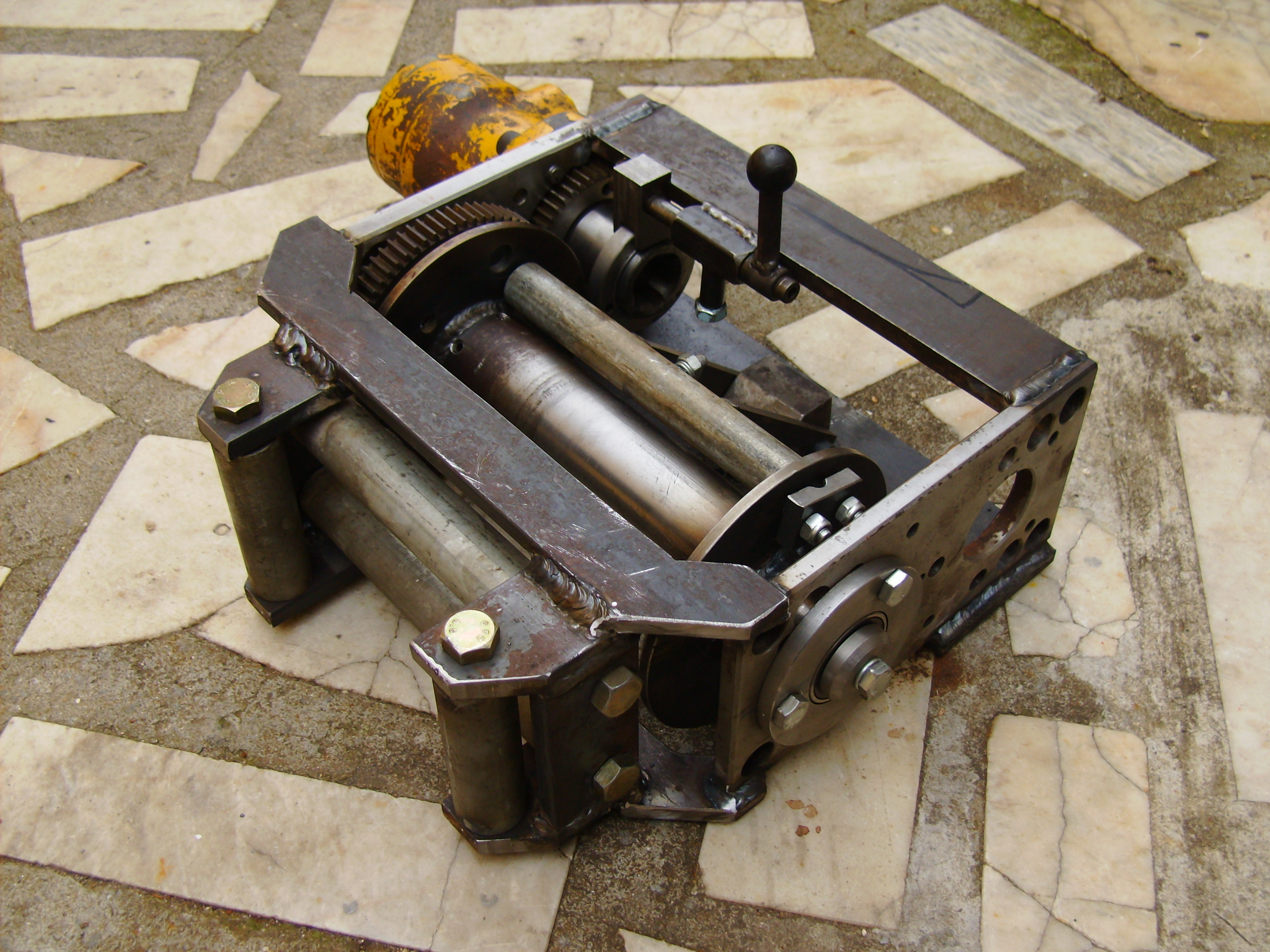

I made a mechanical disconnect on my winch. It makes it really easily to work with.
The gear just slides on the motor shaft as shown in picture 2 and 3. I did add a detent to the fork. But yes, a mechanical disconnect will complicate things a bit.
   / Help in Hydr. Motor with hydraulic clutch port.
Thanx for the photos man! They look great. But I am a little deficient in engineering and I have not many tools (other than a CNC Plasma cutter). It looks like that my best option is a dedicated 3way valve
