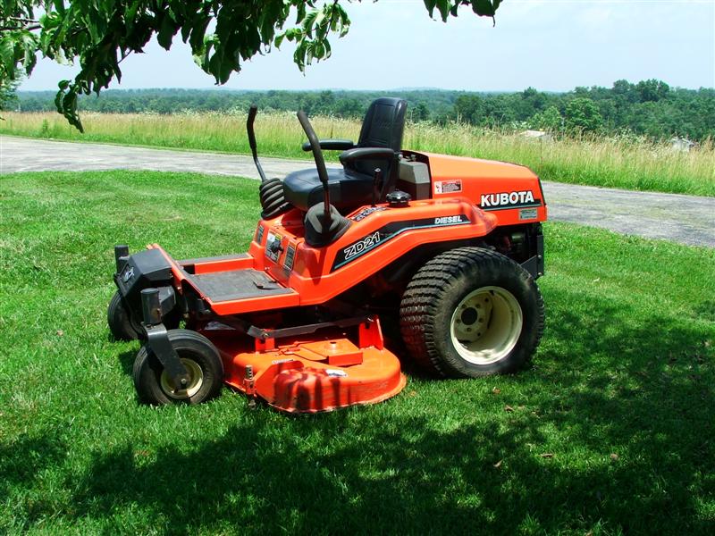

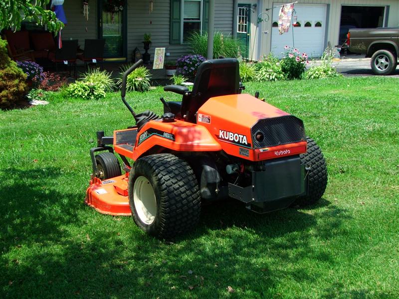

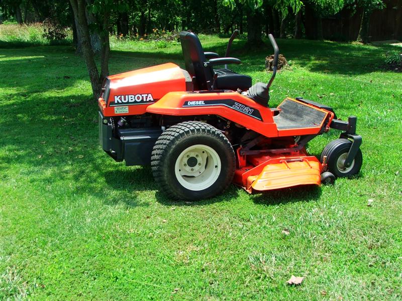

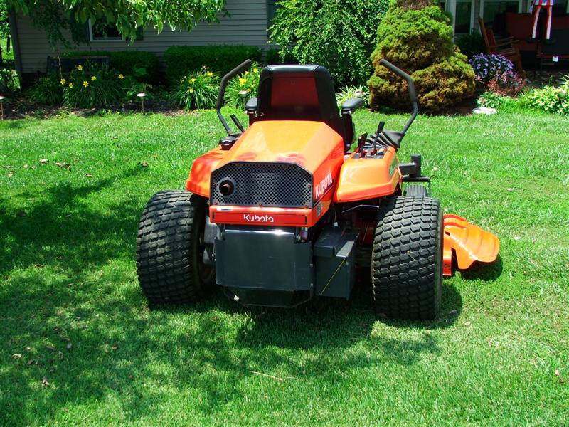

Might try used, I got this one for less than $4500 including tax. Should last me as long as I need a mower.
