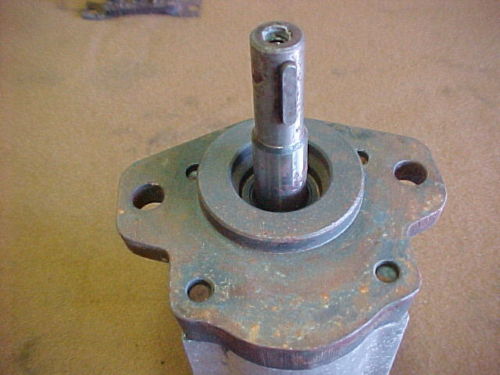

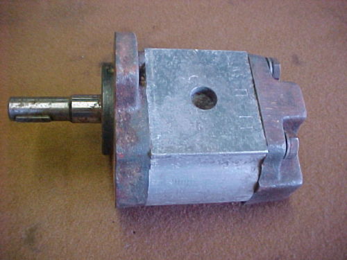

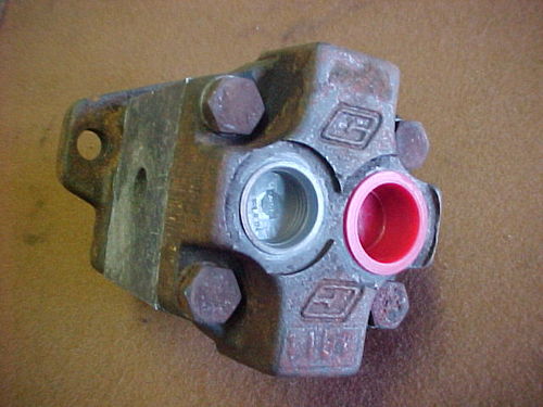

Supposedly it's from a Plow setup off a Jeep bought at a Farm Fleet store 10yrs ago. The only markings on it are a "G" on the back. Anybody have an idea what it is or were i could find out? Specs?
Thanks
Stew

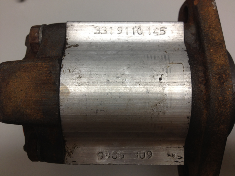

Commercial gear pump..(now Parker)...Any numbers on the flange?

Not sure. Just got it cheap on eBay but the guy didn't know anything about it. Other than what I listed above. Will see when I get it in a few days.

If it's from a plow setup then the pump may only be about 4-8 gpms.....there is a way to measure the gear set internally to approx the CID, then you could calculate with the prime mover rpm's to give you gpm's
   / Help IDing Pump
Thanks, for the info. 4-5gpm would be perfect, even 2-3 will work ok for my size cylinders(1.5in). Will have to use the calculator if cant find out any other info on it.

Guess the guy couldn't see this info on the pump. I found the info on the Parker site. Looks like a 5gpm pump at 3k RPM!!! Which is perfect for the other random eBay purchase two spool valve I bought last year!!!
