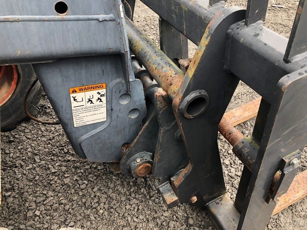

Help identifying the type of hydraulic cylinder used in a Rockland Quick Coupler
   / Help identifying the type of hydraulic cylinder used in a Rockland Quick Coupler #11

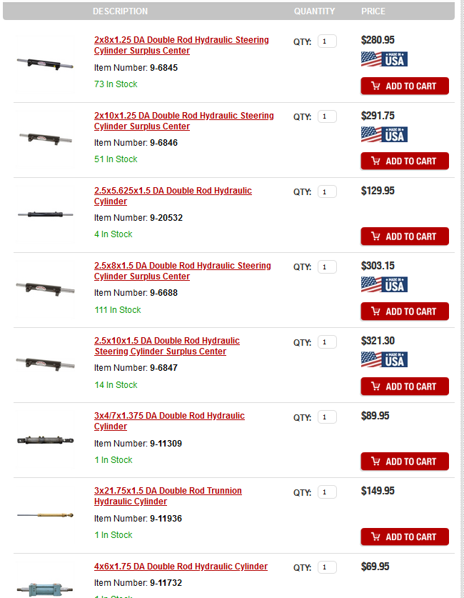

Nothing from Surplus Center is close?
Double Rod Hydraulic Cylinders | Double Rod & Tandem Hydraulic Cylinders | Hydraulic Cylinders | Hydraulics | www.surpluscenter.com
   / Help identifying the type of hydraulic cylinder used in a Rockland Quick Coupler #12

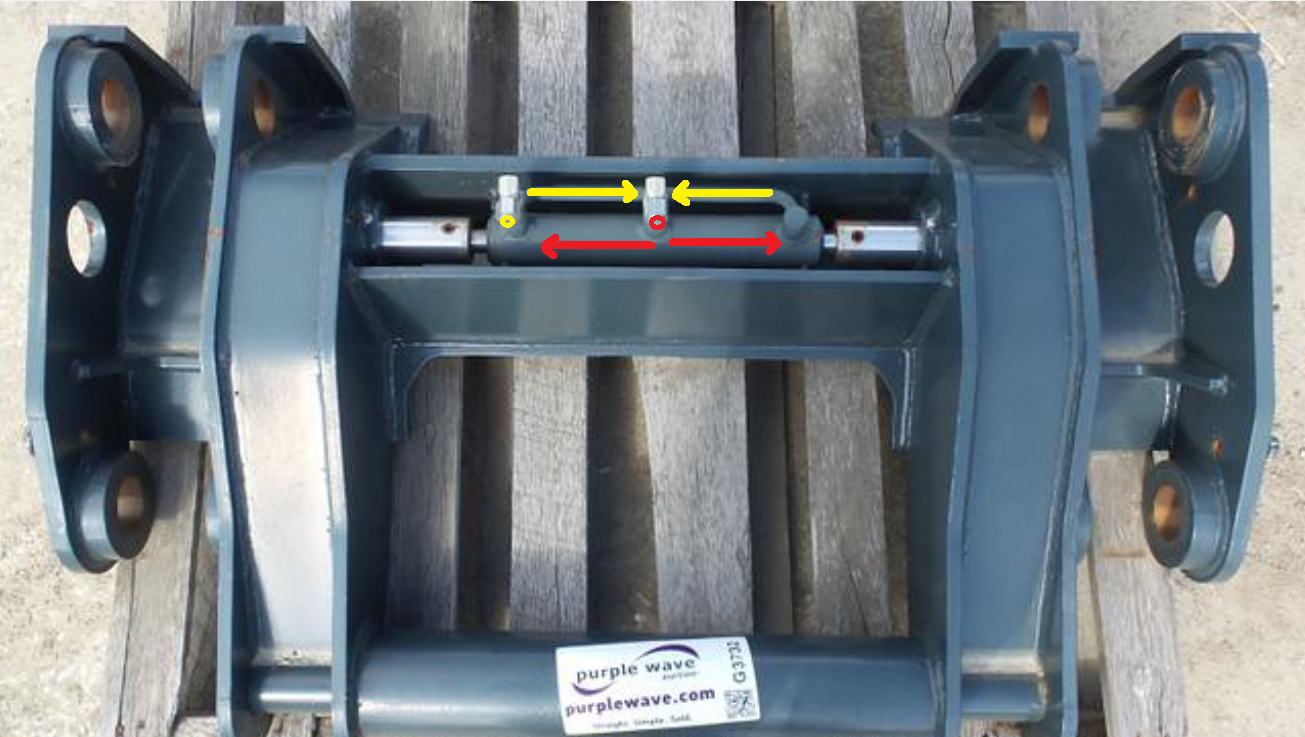

Ignore my previous post. Now I know why your quest is so difficut. I was just thinking double rod cylinder, but most double rod pistons (like steering cylinders) move in a straight line (i.e. when one side retracts, the other side extends). You need a cylinder where both sides retract at once or both sides extend at once. The line sending hydraulic fluid to the two ends is the tell. Maybe a hydraulic shop could give you the nomenclature?
Sincerely,
Captain Obvious
   / Help identifying the type of hydraulic cylinder used in a Rockland Quick Coupler #13
My skid loader does the same job with a regular single acting cylinder. As long as the pins had a stop so it had to pull both pins vs pulling one twice as far there’s no reason it wouldn’t work.

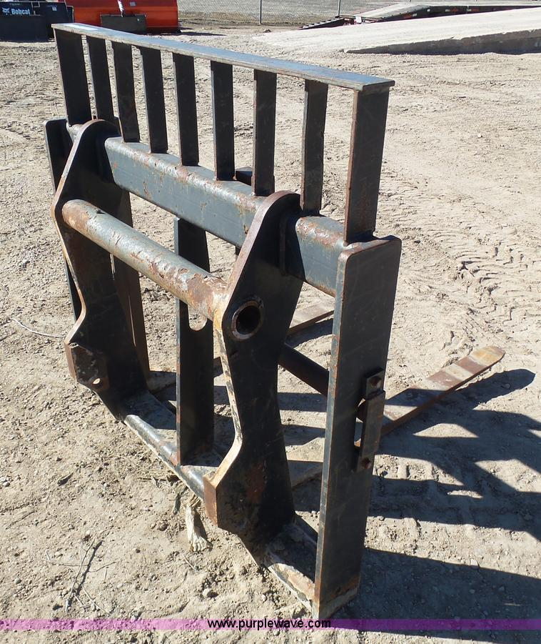

This is the QA cylinder that Bobcat used in the V518 compact telehandler:
When it wore out I removed it an used a steel rod pushed in from the left side through the holes in the bucket .
Or the holes in the forks:

Makes we wonder if that type of cylinder could be used to power the latching mechanism(s) on a SSQA.
Bob-Tach and the like ones I've seen are all single cylinders with the base of the cylinder pinned onto one quick attach arm and the ram pinned onto the other quick attach arm. because of the 1/4" cover on my coupler, it appears to me that the cylinder was fixed center with two double-acting rams. Anyway, way less expensive to use a single cylinder. To do so, I drill mounting holes in the ears of your quick attach levers then measure when wide open and also measure when all the way closed and use a find it tool to select the right sized double-acting hydraulic cylinder. Double Acting Hydraulic Cylinders | Hydraulic Cylinders | Hydraulics | www.surpluscenter.com
View attachment 735405View attachment 735406
View attachment 735413View attachment 735416

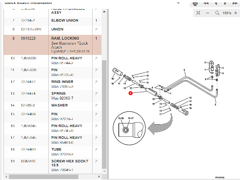

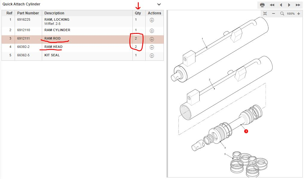

I left a message for the parts guy Bill, at Rockland asking if a newer cylinder can be used in my Coupler. What I can say is that the 3" wide pins are threaded for 1' x 8 thread pitch, so super common size that would allow me to thread bolts into the dowel pins that hold the Coupler onto attachments, and then puzzle out how best to pin those bolts to a cylinder or ram. If I must, I can make a single-cylinder work leaving the tough cover off so the hoses don't get damaged from the cylinder moving around.

Super cool! Bill the parts guy from Rockland Manufacturing called back and took my bucket and coupler part numbers down, explaining that Rockland does have those records in a different location as old hard copies. Bill explained that it would take him a day or two to find the records but he'll email me the parts book and part numbers to order from one of their dealers.
This is a way better result than when I called Rockland last year asking about the same thing and was told everybody who knows anything about that has retired.
