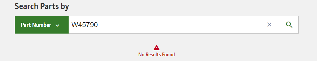

mscheer772
Entering that part #(W45790) in JD parts system comes up with no information. Are you positive part # you posted is correct?
