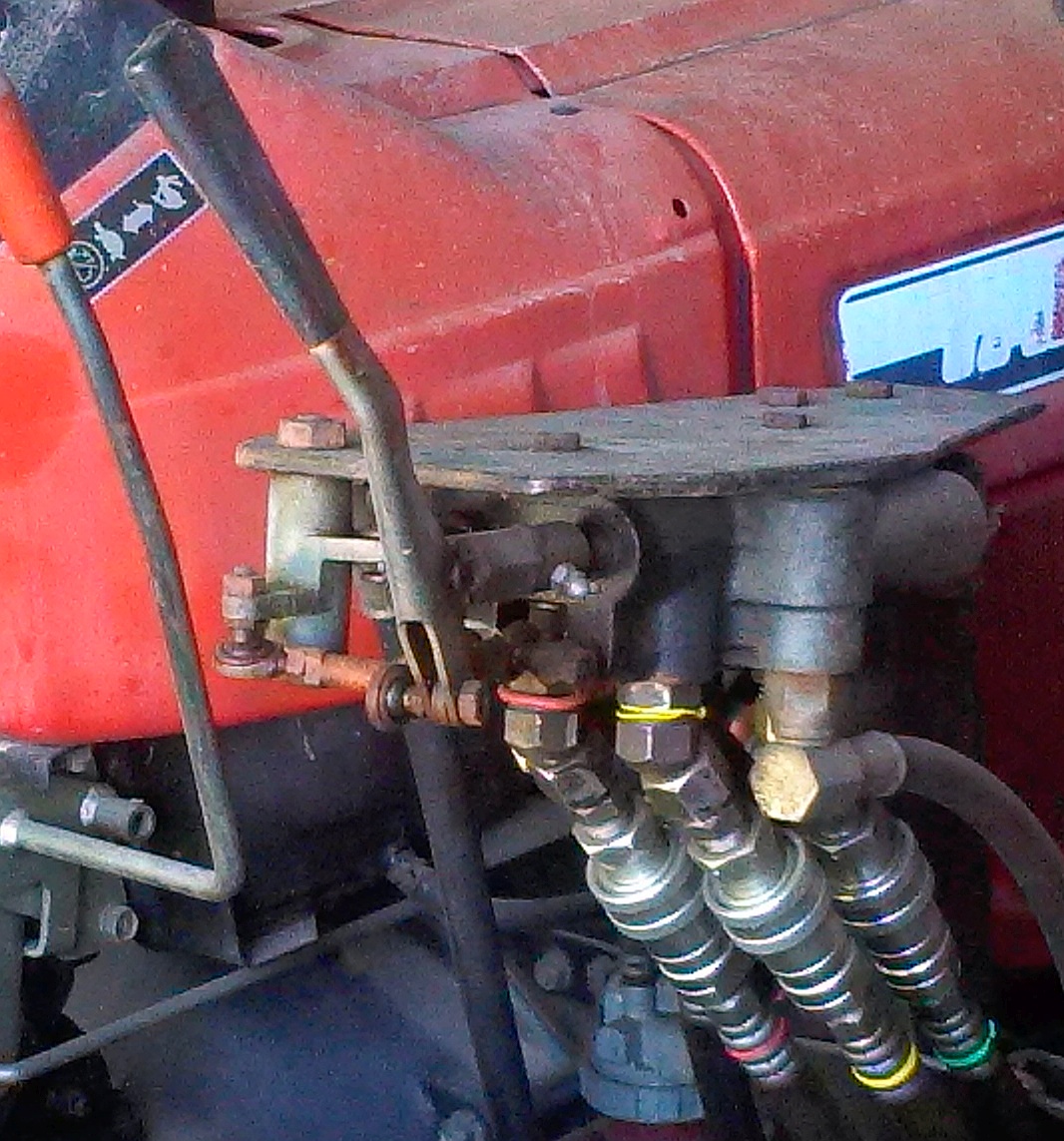

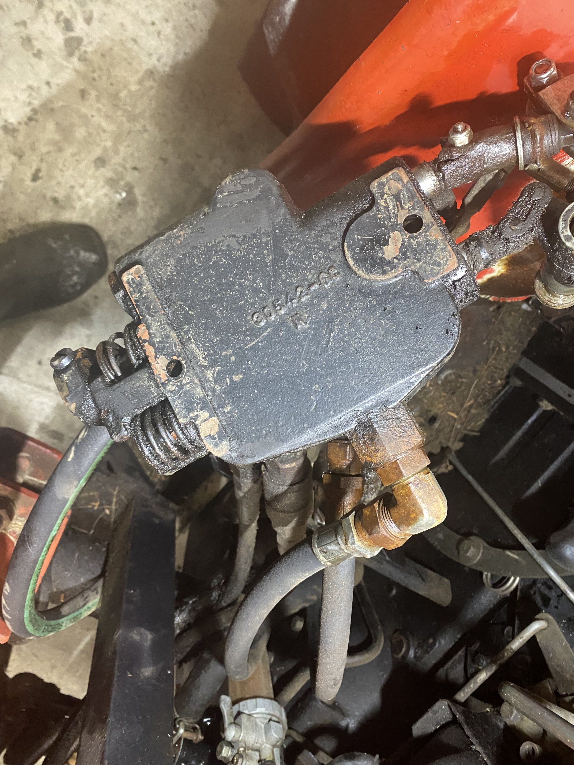

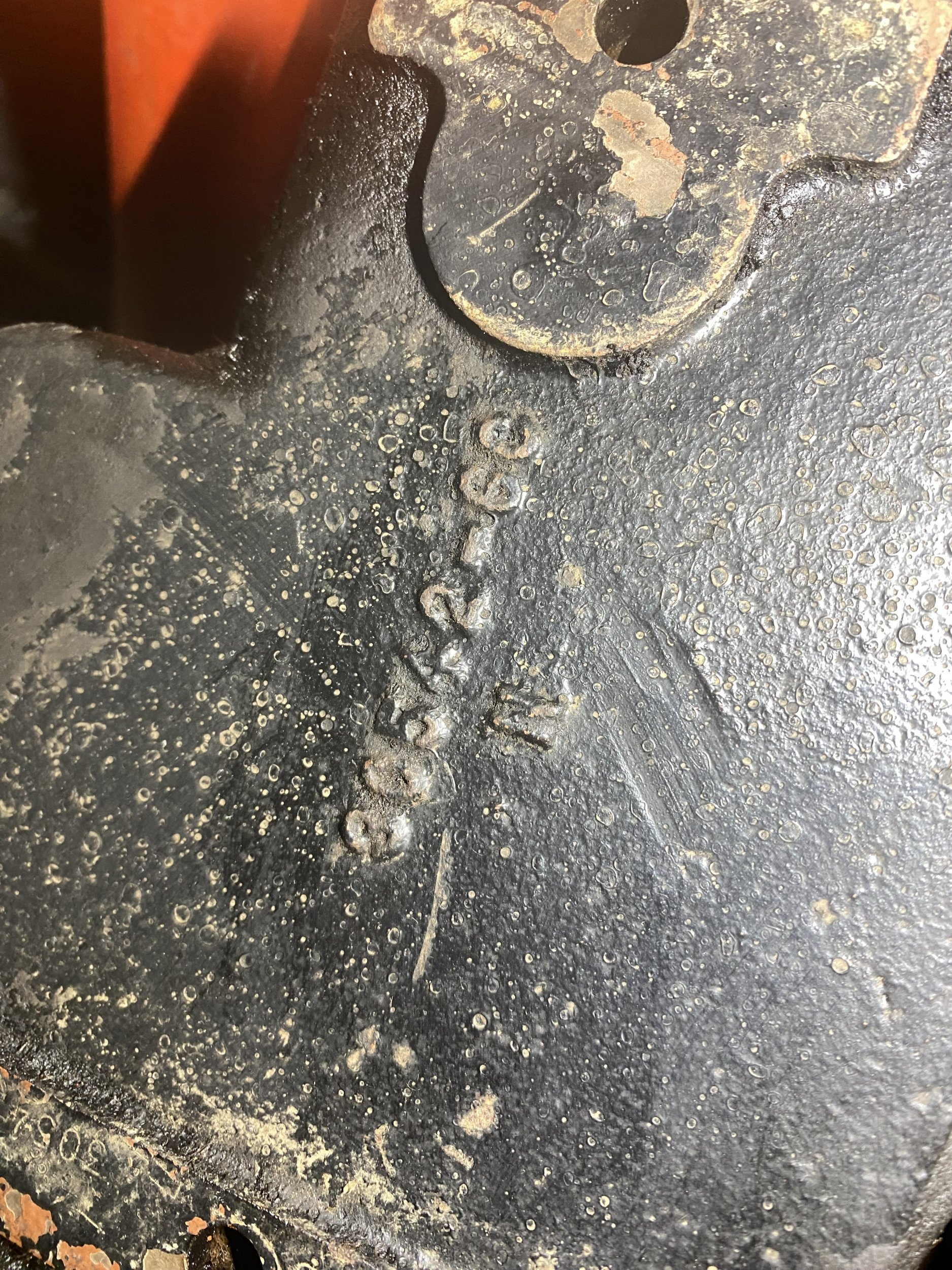

Could be danfoss (vickers) 30542-6C...
It's on a 650 FEL on a 186D looking for the spec sheet or information on relief valve.
Doesn't have a conventional relief valve.

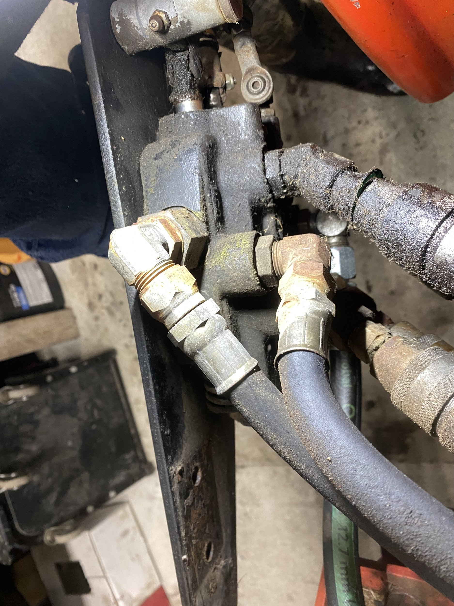

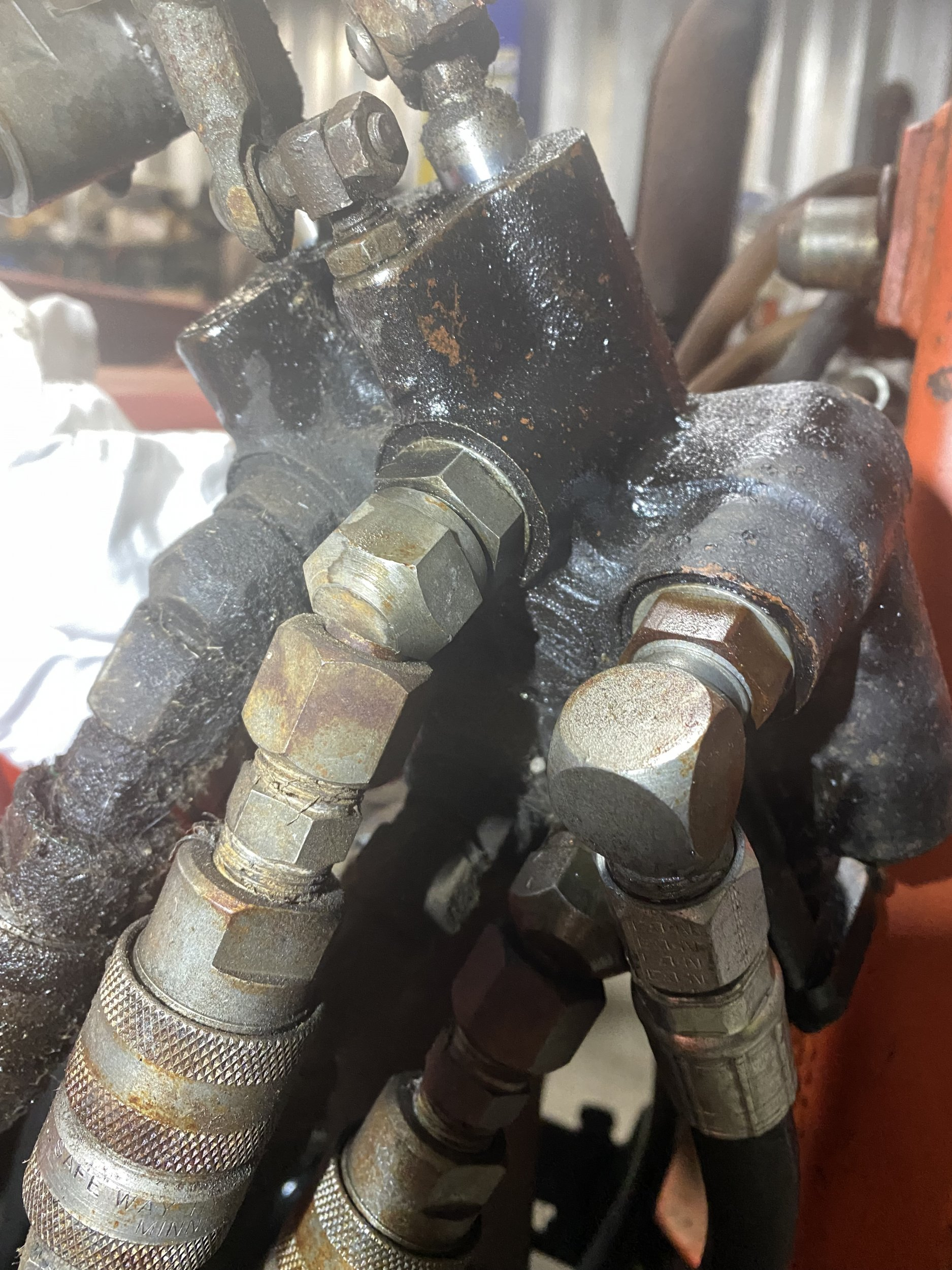

information plainly states set relief valve pressure 2000psi. Relief valve is on top right of first picture. Pressure can be adjusted with shims. Yes, your 3 point also has a relief valve.

Not so sure as it looks like a plug, rather than a relief valve, but can't hurt to unscrew the plug and find out.

It has always been my understanding that all loader control valves have relief valves. Maybe I'm wrong but do know the Eaton sight is showing a relief valve on the one that has been attached. I can't imagine using a loader without a relief valve. I cause my loader valve to relieve quite a bit when using my loader. Without one I am pretty confident my pump would be trash.

I agree, but looking at the literature and the picture of the valve, it appeared to be a plug. It could be a shim relief under there. Being it is an older Yanmar, anything is possible. They could be depending on the tractor system relief, but you are probably right.
