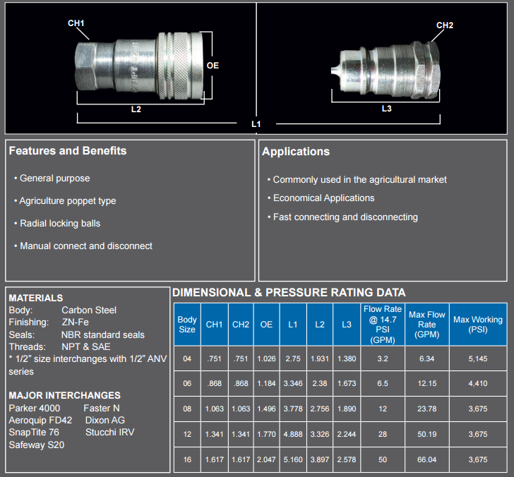

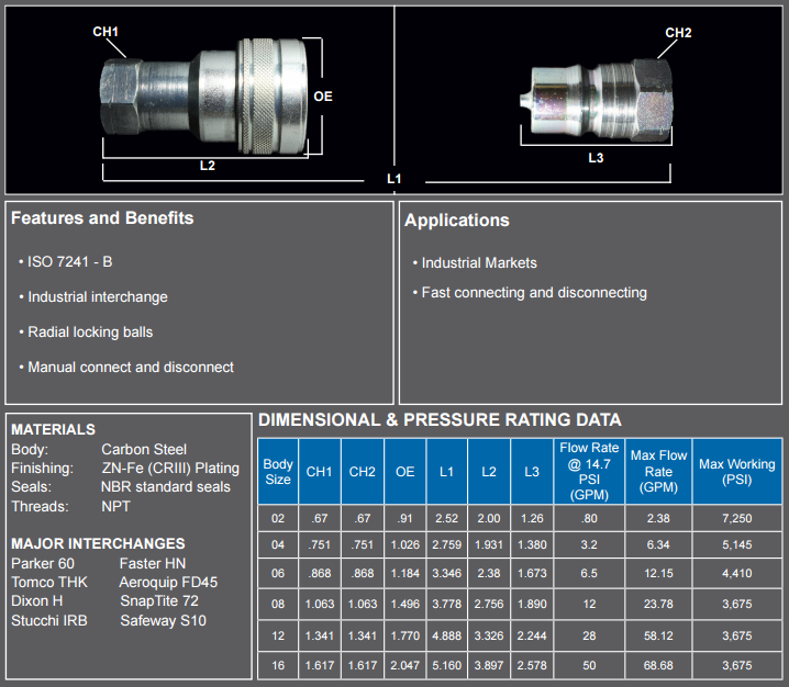

after a small bit of research it appears that the third function is probably a HNV series ISO B Quick Disconnects | HNV Series ISO-B it looks very similar.
I KNOW my style is an NV style. I guess they are not compatible. but nobody will admit to being the one not using the "standard" connector. Hate to spend money on something mail order w/out knowing for sure.
Both the NV Agricultural Poppet type and the HNV ISO-B are common quick disconnect hydraulic couplings.
If you are sure you have an AG Quick Coupler to SAE ORB, check out the size chart here http://www.hydraulichoses.com/v/vspfiles/assets/images/NV.PNG
If you are still unsure that the other quick connect is an HNV ISO-B , here's a link to the sizing chart that may help figure it out http://www.hydraulichoses.com/v/vspfiles/assets/images/HNV.PNG
Both of those quick connect coupler bodies have ORB ends. You should just need to swap one out.
