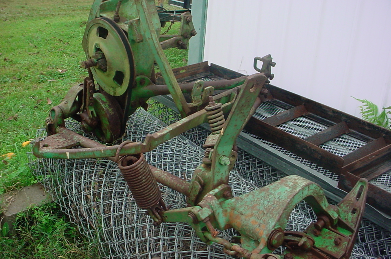

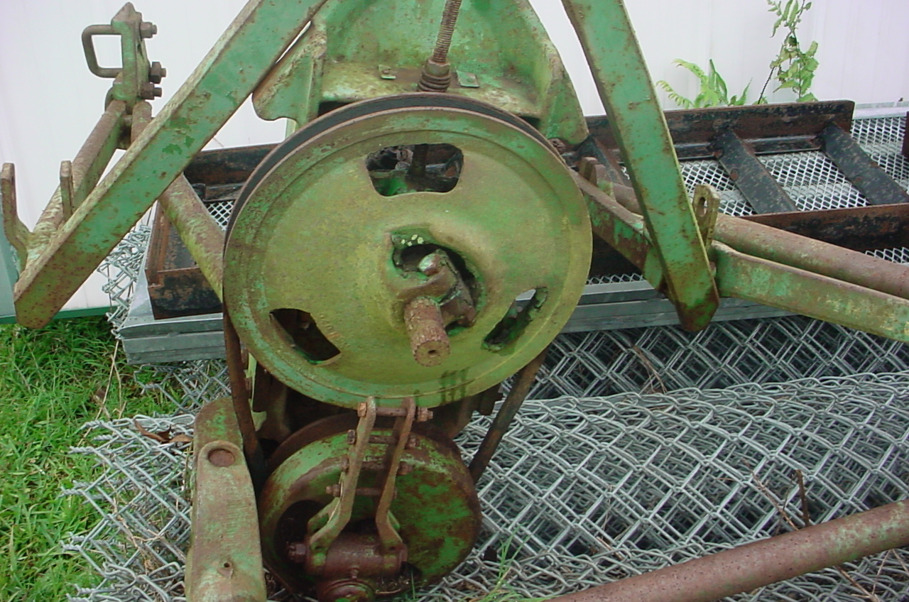

i picked this up recently,the model #/ s/n tag is missing.any idea what model this may be? one of the part numbers on a casting is:h1112-h.i appreciate any info you can give.thanks,revg62.

revg62, Good morning.
Can't be sure, but looks like it might be a model #39.

Go to Tractorhouse.com,look under sicklemowers.Someone selling #39 JD.(good pictures). I think Dave-O is right.Hope it helped ya.

There were 2 different 39 JD mowers...a 39N and and 39W...yeah, you guessed it one is for "Narrow" and one is for "Wide"...depending on the width of the rear wheels. Check how far out the shoe is from the centerline of the large primary PTO pulley. Depending on which type tractor you have whether you might want to check this out. The shoe should be just behind your rear wheel or a small amount out from it. PS: we had a 39N. BobG in VA

thanks so much for all the help.after much digging i found the id tag inside the housing.how it got there who knows? type e039m s/n 020535.looked on jd parts,nothing comes up.at least now i have a starting point! thanks again,revg62.
No ... there are only the #39 and the #39N ... have owned both and have bought parts for both ... the flywheel is an obsoulte part, can not be gotton from JD, if you plan to use it and can ever find a replacement flywheel BUY IT for future use ...
