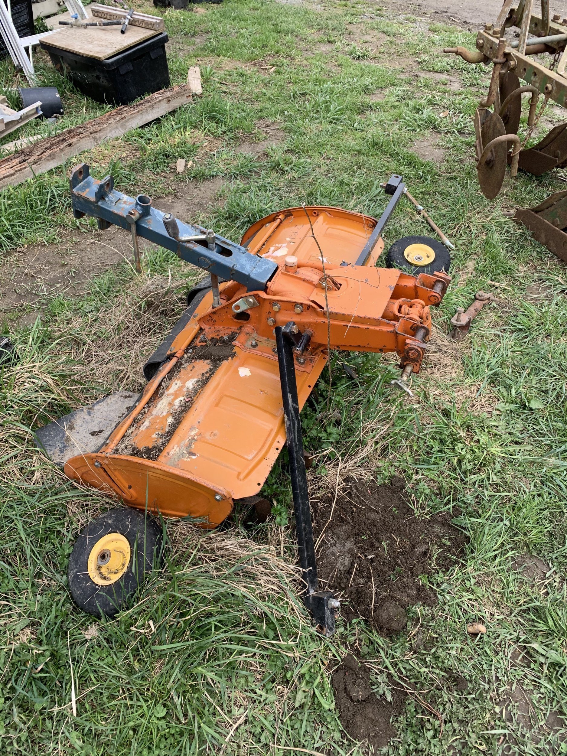

Help ID this mystery tiller
   / Help ID this mystery tiller #1
Littlecedarfarm
Apr 25, 2021
2
Yanmar 155d

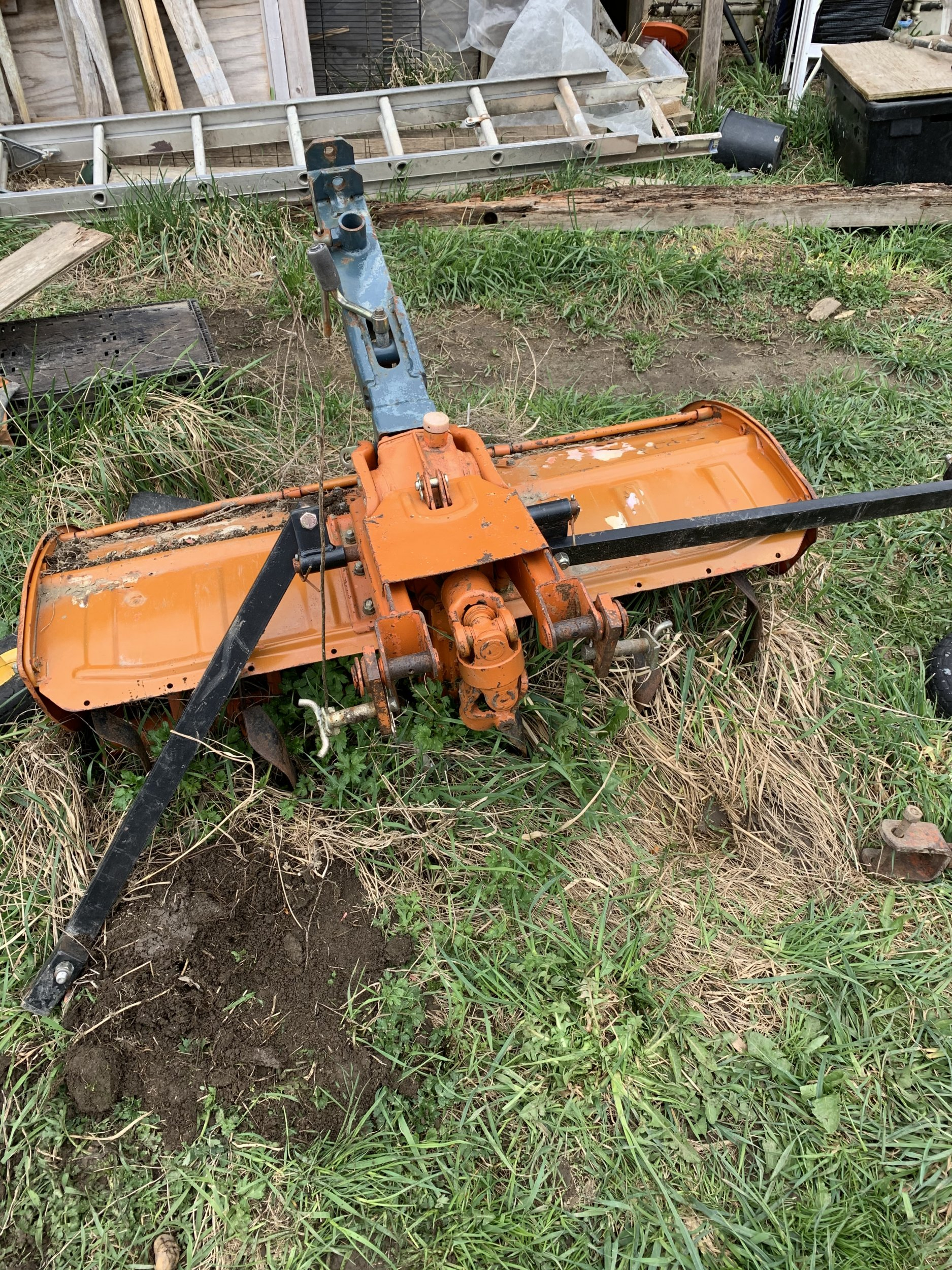

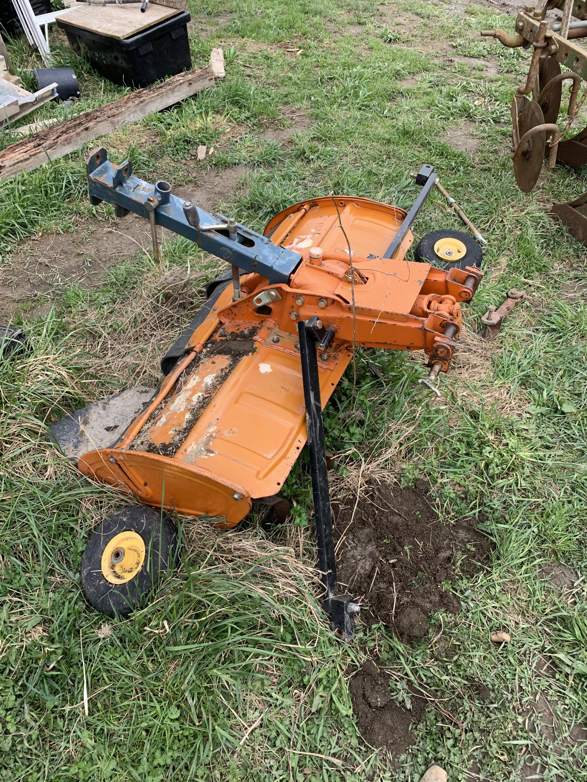

Hi All, wondering if someone can help ID this tiller and more importantly assist a newbie attaching to 3 point on my Yanmar 155D tractor. I’m confused because it doesn’t look like it has a top link connection... any help would be amazing.

It's a Kubota tiller made for the B7000, B7001, etc series. It uses a proprietary 2 point mount with the short PTO shaft in the middle.
It's actually missing the original lift arms.
You can't use it as is on your Yanmar. It will need modifications and a new PTO shaft. Basically needs a triangle to provide the two bottom pins and top pin for the 3 pt hitch of your tractor.

Thank you! I was thinking of trying to find some shorter lift arms and a pto shaft extender as a modification
   / Help ID this mystery tiller #5
Think you will find that there is a rear wheel that can be adjusted for height. There is no top link.
The bottom arms are attached to the tiller. The lift arms are not attached to bottom arms but rather to the tiller. This makes a type of three point connection.
