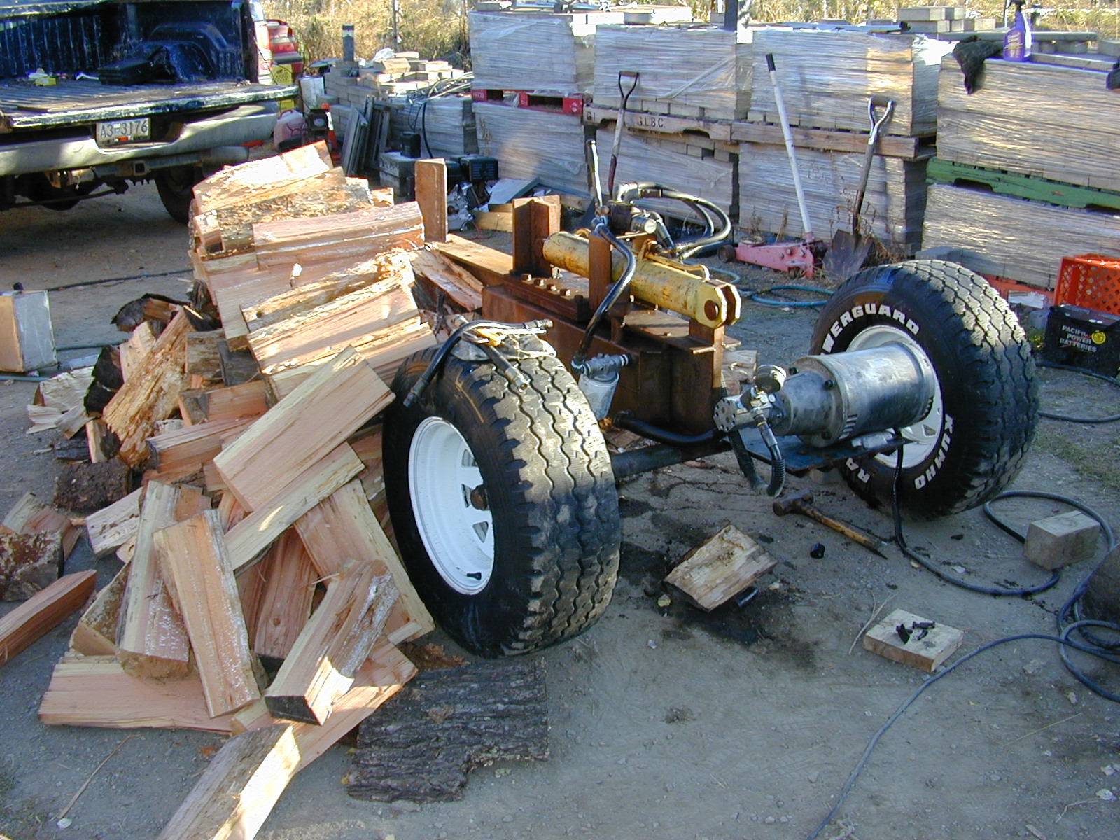

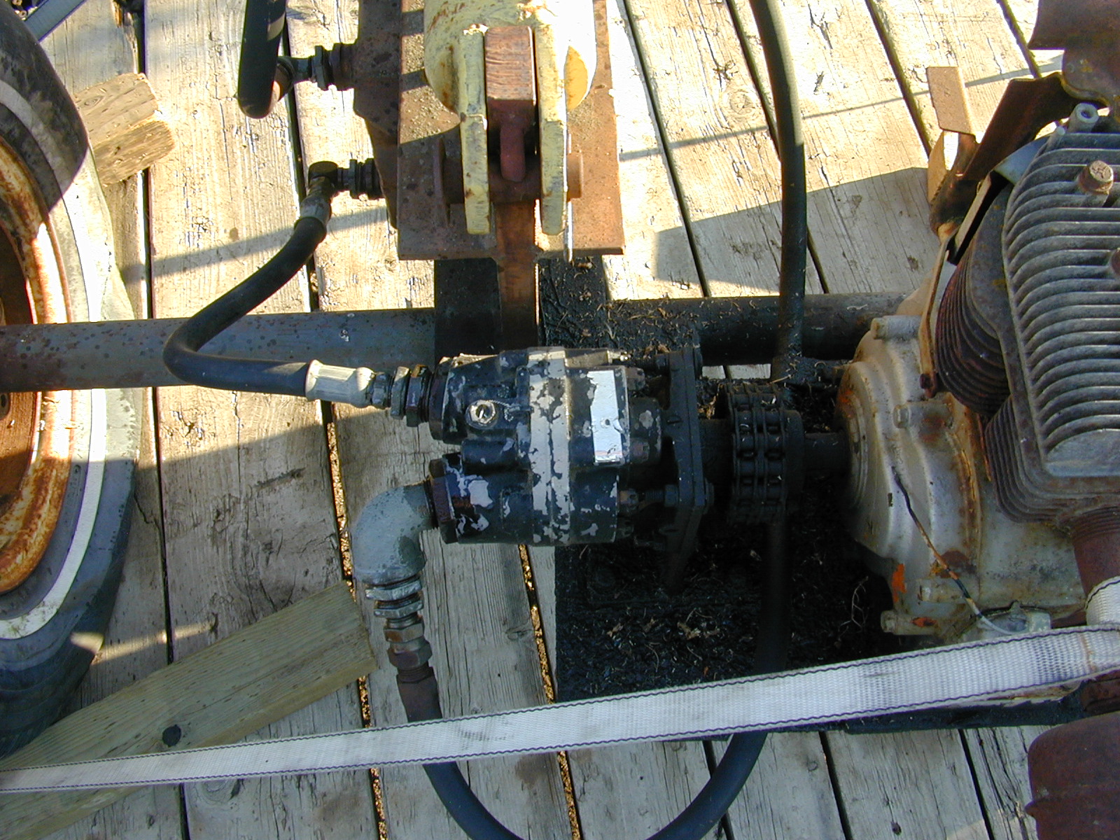

Help ID this hydraulic pump please....my new log splitter project
:confused:

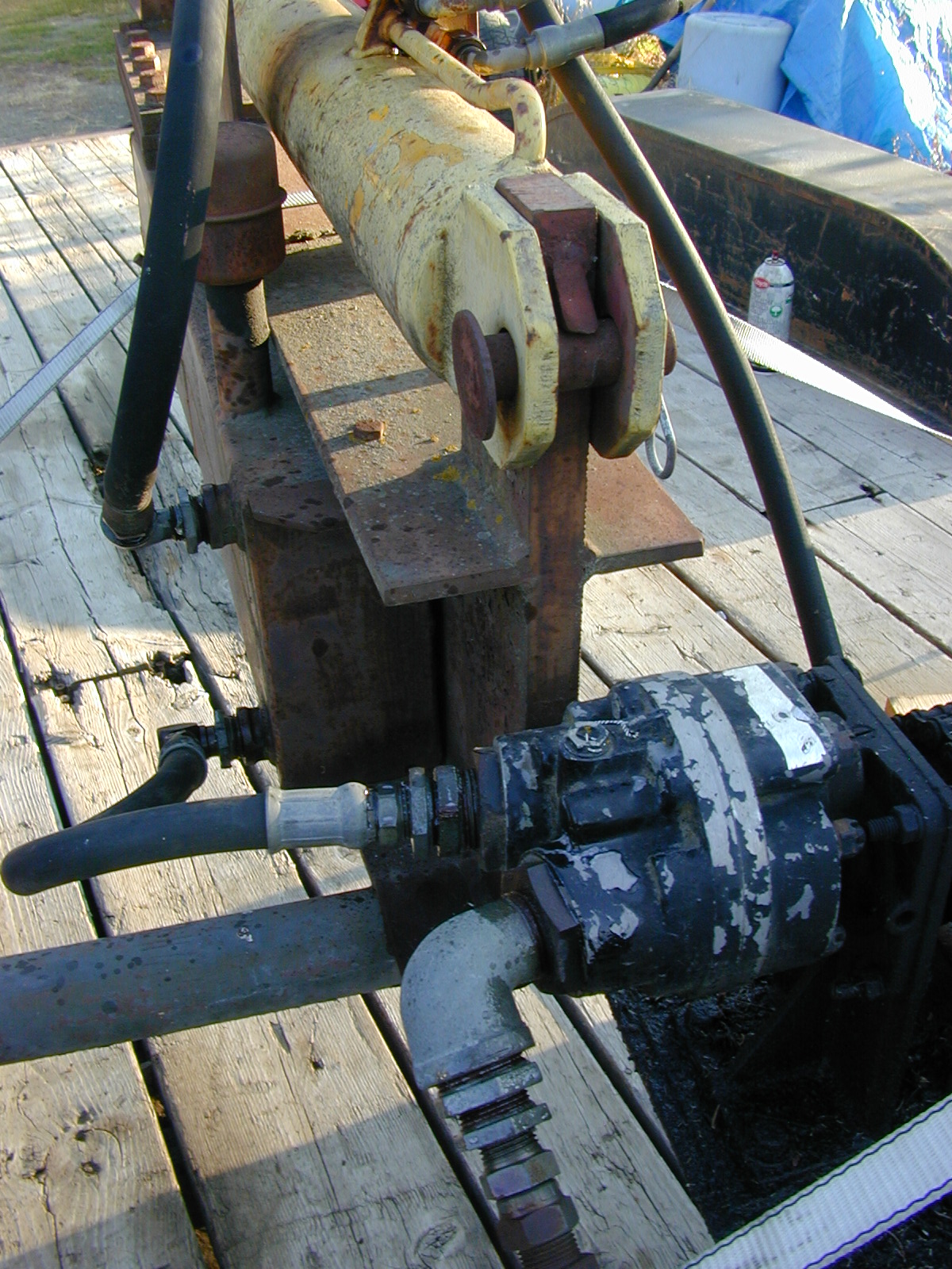

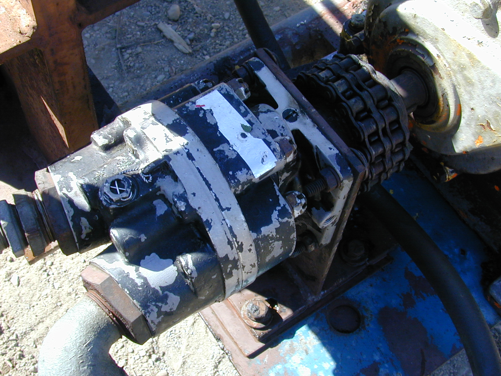

I bought a new to me, very well built splitter, in need of a new engine...and I can't figure out what this pump is. It has 739-18 stamped on the side but no other mfr or p/n that I can find. Can someone step up and let me know what I have here? I have a Kohler 14HP that will bolt right in, and want to make sure I am moderately closely matched to what the pump needs. It's a 3.5" cylinder with an Energy C-908 kickoff valve.
Cheers
Paul
   / Help ID this hydraulic pump please.... #2

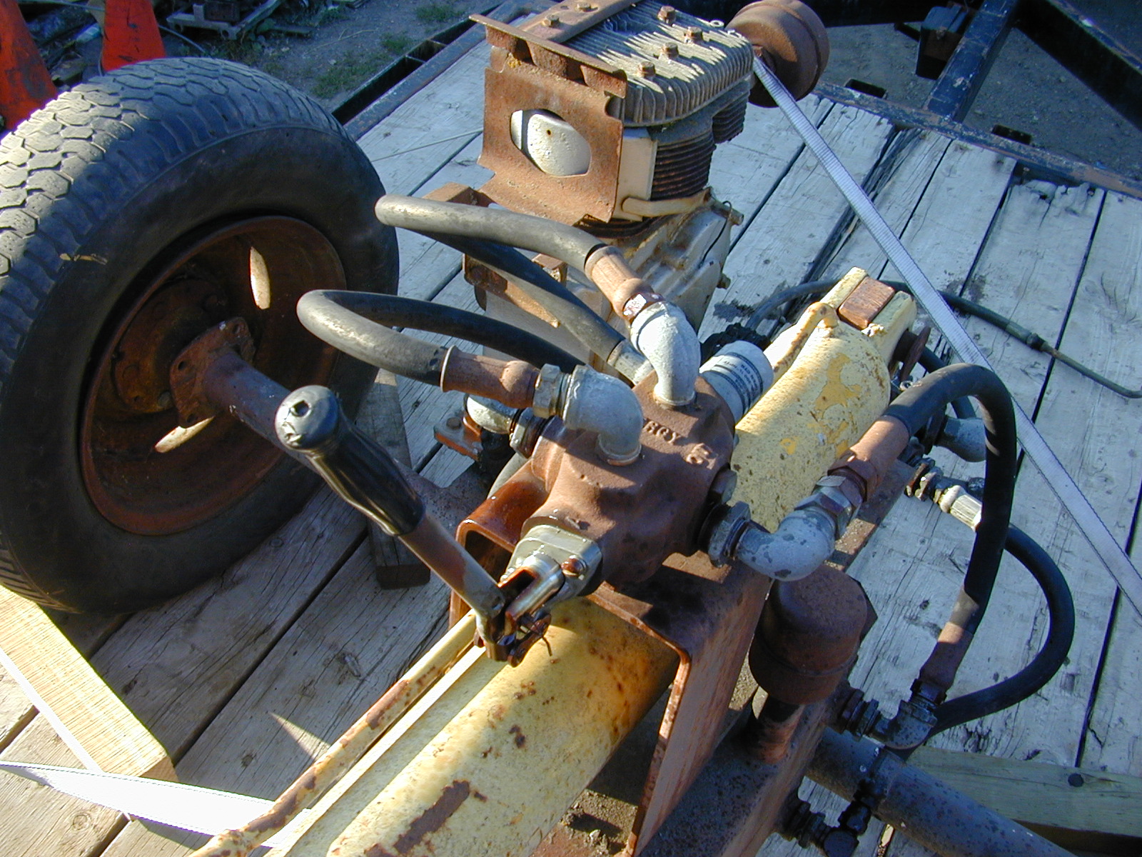

Sorry I can't identify the pump for you but if I had to take a gues it's a gear pump, 10 gpm or so, hard to tell from the angle of the pics. Have you considered a two stage pump, you could go with a good size one running it with a 14 horse.
A couple of suggestions. Since you're replacing the pump upsize the suction line to at least 1" minimum. Get rid of the black iron fittings on the pressure side, they're no where high enough rated pressure wise not to mention they look as if they're galvanized, a no-no around hydraulics....Mike
   / Help ID this hydraulic pump please.... #3
No idea on the pump. But if you already have the 14HP that will bolt in, go ahead and do it. Then with no load, time a cycle with the cylinder. Aside from any loss from hose restriction, with a little math, you can get a close estimation of how may GPM the pump is. Then yo can figure weather the 14HP is enough.
And definatally get rid of those pipe fittings. They have no business in a hydraulic circuit.

Thanks guys! Yes, I spotted those pipe fittings as well. Interesting that the fellow I bought this from, owns a machine shop and that is where it was built. Nice heavy duty build but a few hydraulic no-no's. Good thought on testing the pump. I made measurements last night and the Kohler 14HP will bolt right on. The plate bolt pattern is identical, as is the crank spacing from the deck and the shaft size. Like it was made for it!! I guess small engines have a pretty standard layout for mounting. Depending on test results, I also have a nice 4" cylinder that I could install.
Yes, 2 stage would definitely make a difference and I am watching ebay for a deal on a Haldex type 16GPM, which I think would be perfect for this. Maybe even a 22GPM but they seem to double in price over the 16. Do any of you have a 2 stage pump you want to sell?

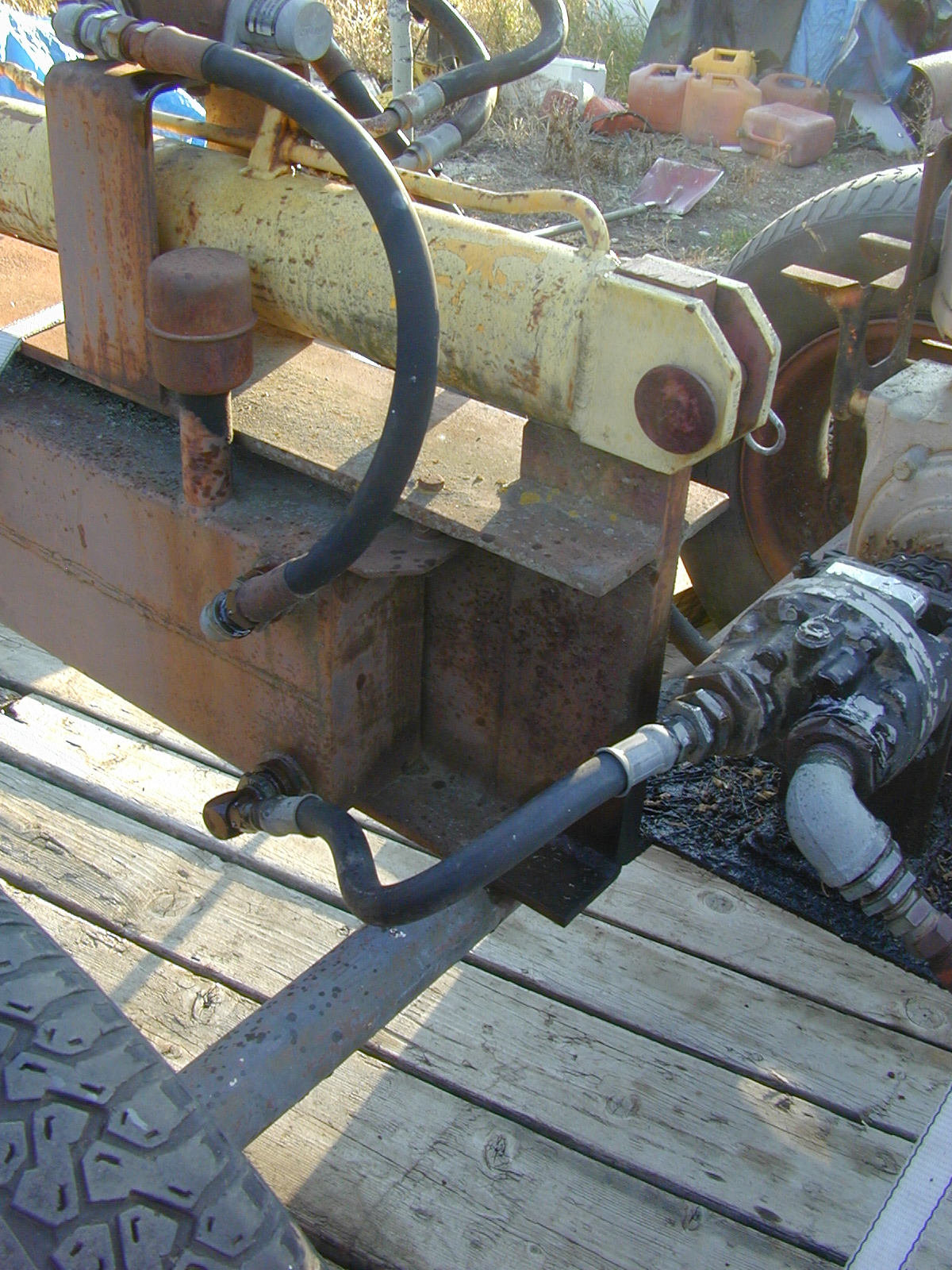

Wow, even more pipe fittings than we could see in the first post:confused2:
Deffinatally get them taken care of

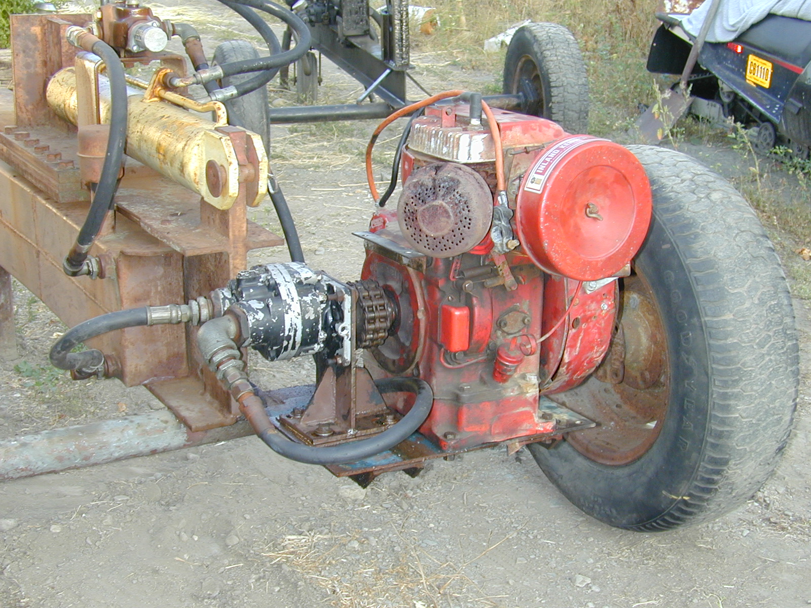

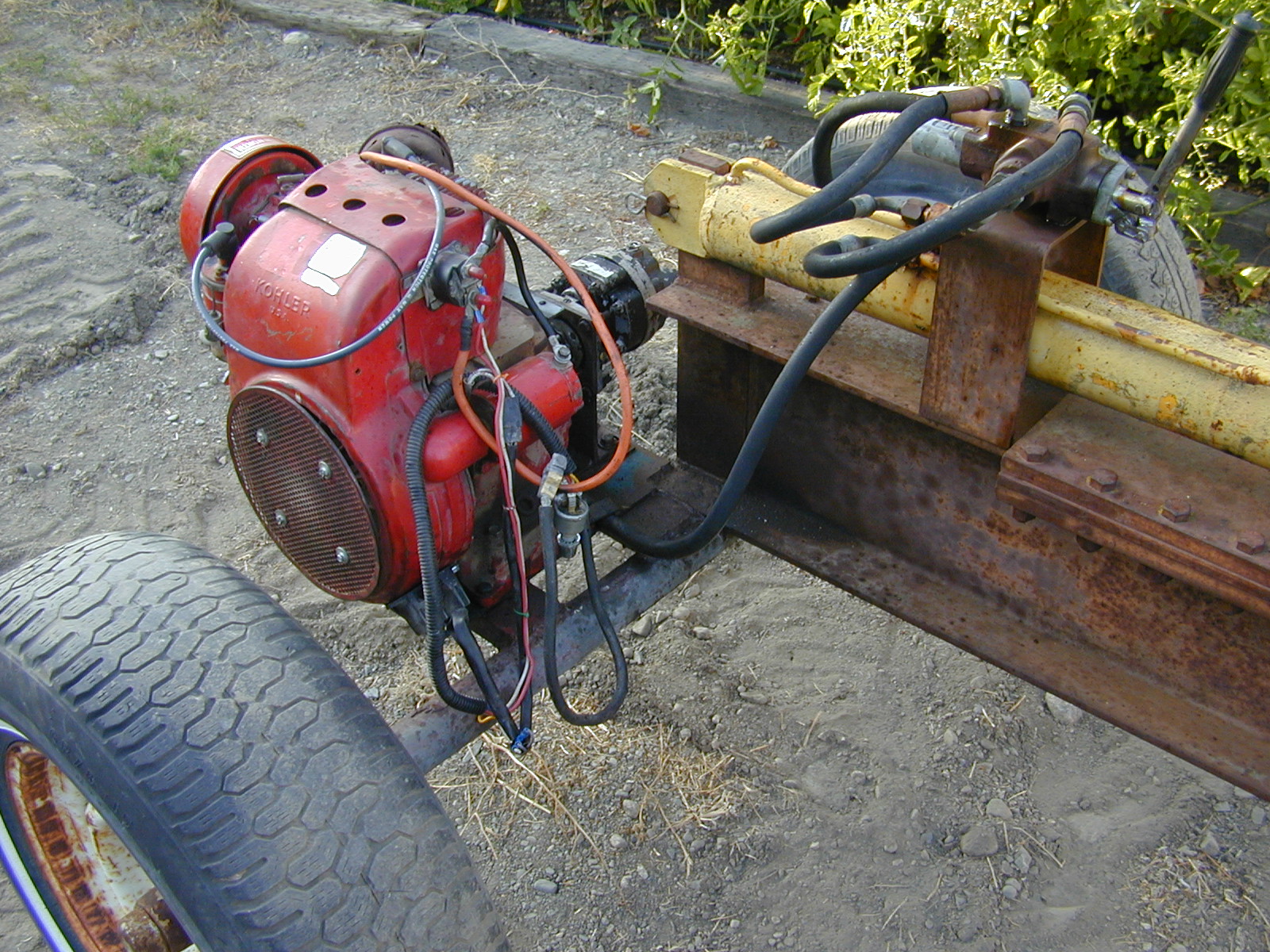

Update on today's progress....
Installed the Kolher 14HP today and had the splitter running (haven't updated the fittings yet but it's on the list, once I confirm what cylinder, pump etc I'm going to use.)
It ran fine, easily split Fir, but crapped out and would have stalled the 14HP on the Maple. Just ran out of jam. The pump is obviously over sized for this engine. I forgot to time the cylinder extension time, but it's now irrelevant. On the hunt for a 16 or 22 GPM 2 stage pump. I may also put the 4" cylinder on it..before it gets the paint job. :thumbsup: I am thinking the 16GPM 2 stage as I may want to go electric, and find a nice 5-7 HP electric for this. The 14HP is from my Go-Cart, which needs a clutch and won't be doing anything now until spring...

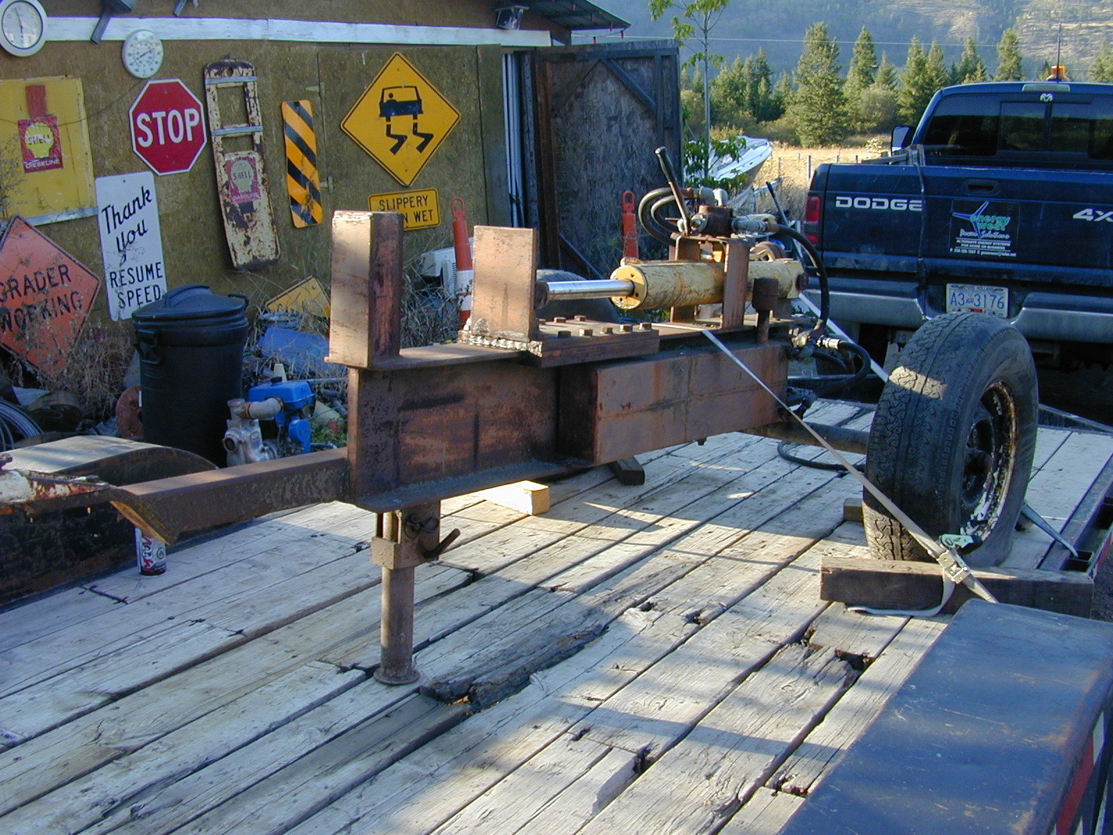

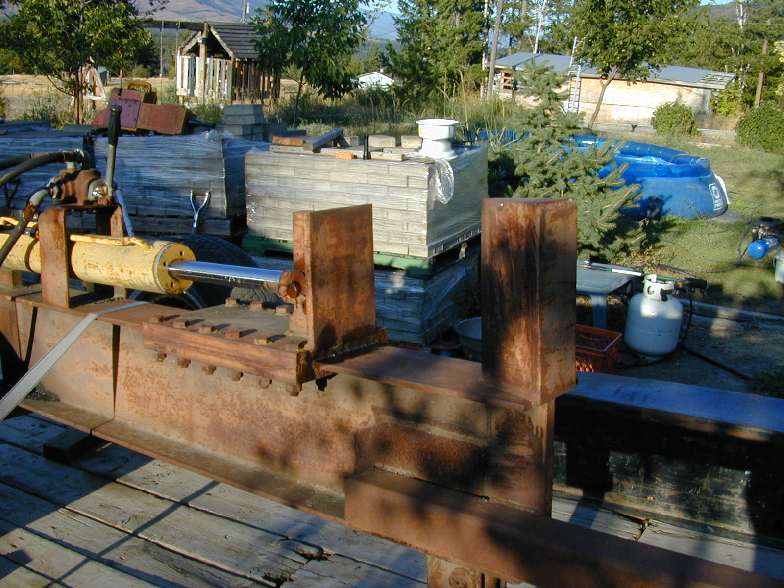

In my opinion the splitting wedge is rather abrupt, should be a longer taper in my opinion.
Also, as mentioned, pipe fittings a NO-NO on the pressure side but OK on the return side.

Another comment , I just realized the return is directly above the suction. If you're going to that amount of work to fix it up, move one or the other to the opposite end as well as put a downpipe on the return (I'm assuming there isn't one). The reason for the first is it gives the oil a chance to cool down before it's recycled thru the system. Reason for the second is that it'll prevent aireation of the oil.

The reservior looks like 2 pieces of square tube stacked. The fluid comes in the top return end then travels to the other end dropping into the lower tube and back to the suction end.

Thanks for the suggestions on plumbing. Good observation. I was also thinking of making the tank bigger as this is only 3.5 GAL.
As for the wedge, I'll find another pic, but it looks good from the top. It has a very slim sharp leading edge that moves to a wider wedge shape. I think it's fine.
You must of been typing this as I was typing...missed it. I'll check it out closely, and try and confirm. If you're right, I'll just leave it as it should have plenty of cooling surface. Will add the filter though.

Update! Just bought a new Speeco 16GPM 2 stage on the bay for $100. Yeah! On it's way here tomorrow. I would like to use the coupling I have already, just need to find a 7/8" to 1/2" keyed bushing. Are these things made?
Cheers
   / Help ID this hydraulic pump please.... #15
Cheers
Get a lovejoy coupler. Thats what it should have anyway. And each half can be whatever size you want. I think our 6.5HP/11GPM combo uses a L095. (I think). With a urethane spider they are good to around 15HP IIRC

Well, the splitter is finally done, except for updating the pipe fittings. I'm starting a separate thread as it is now a completely different splitter...well at least different power. :cool2: Think I'll put it in "hydraulics" as this is more of a technical hydraulic post now.
Sneak peak...
