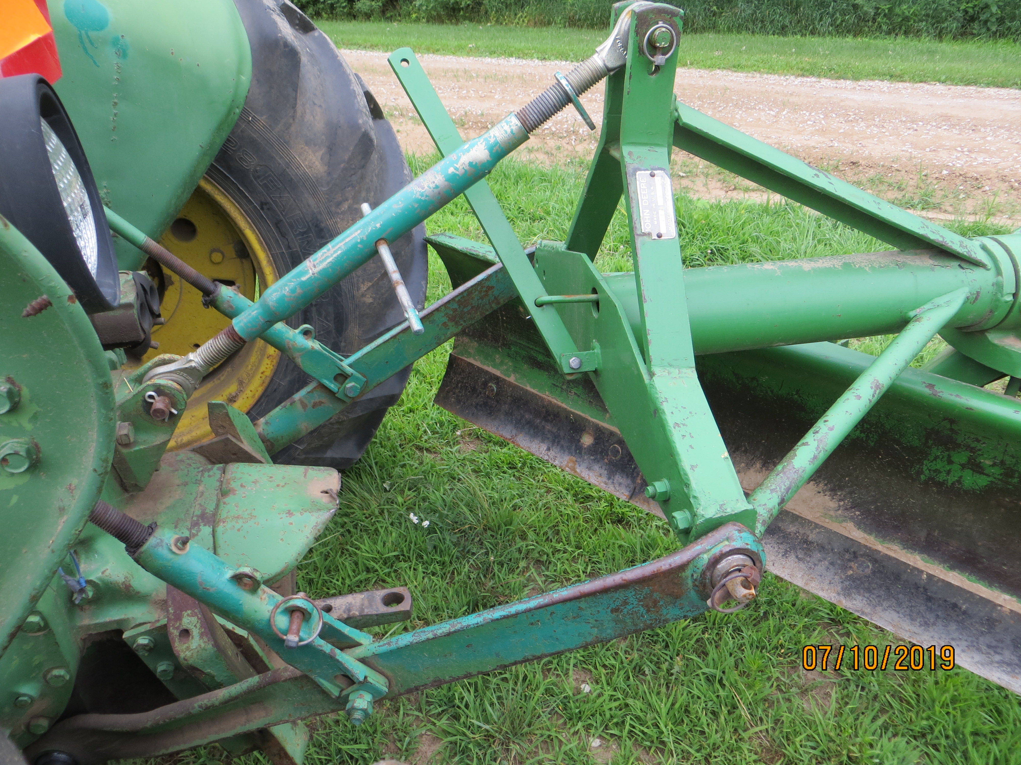

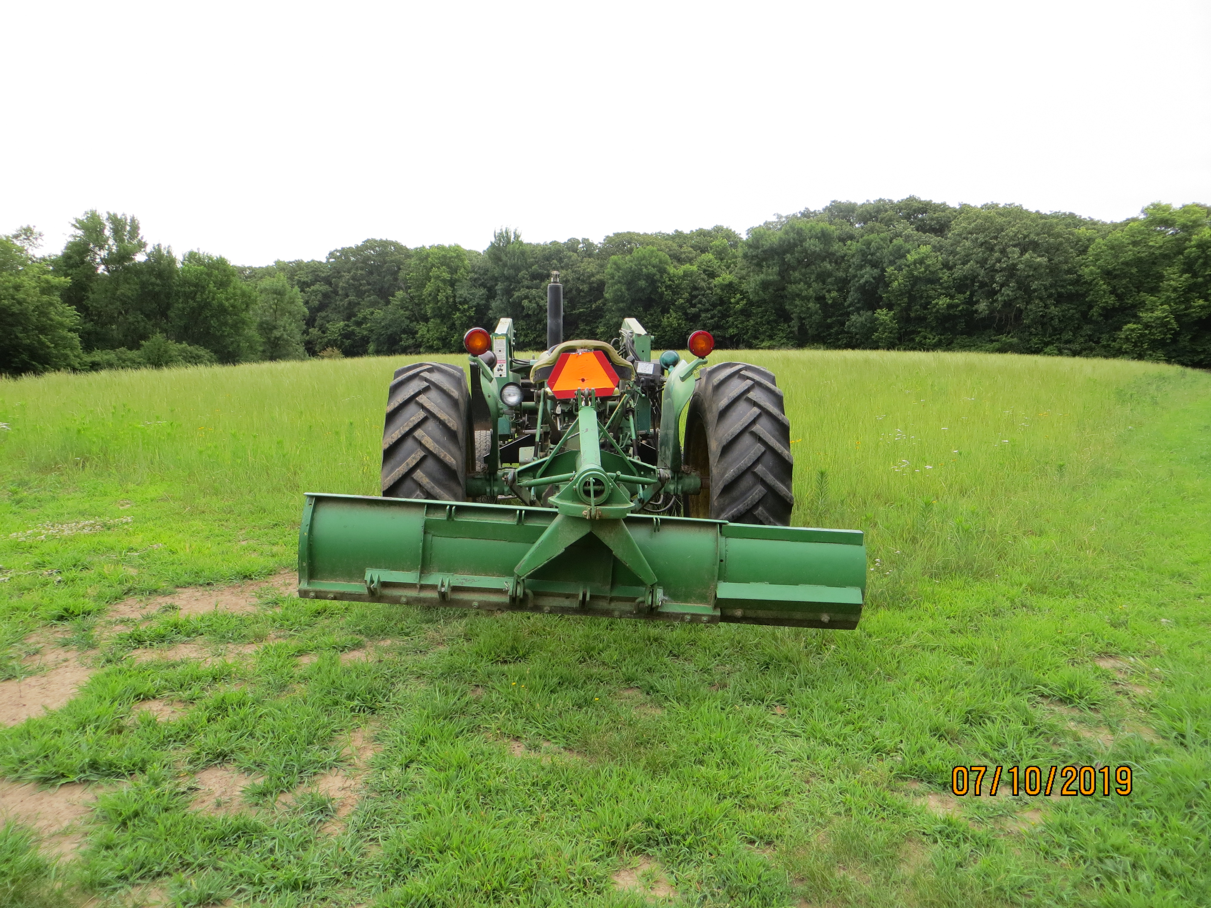

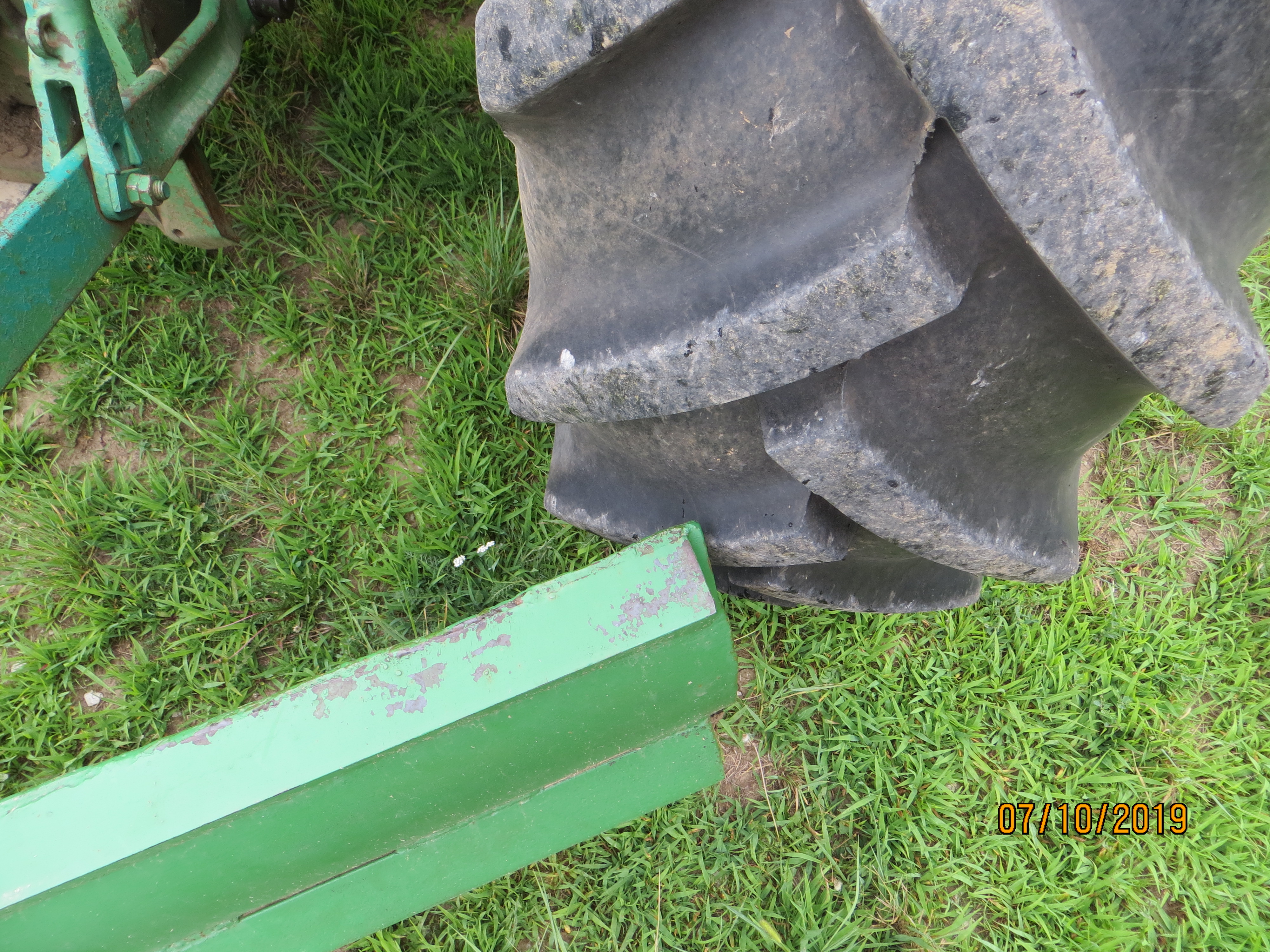

Here's what I've got.
The one picture is just to show the welded on part from behind.
Then one shows how it hooks up along with the lever used to adjust angle. (I was sort of liking the idea of just extending the frame some, but that adjustment lever looks like a show-stopper for that idea, but maybe not?)
The other one is just a closeup of how it hits the tire. As you can see, not a lot - maybe a couple inches? I mean I could take that off I suppose, but if the Quick Hitch would remedy that I'm all in!! IMG_0100.JPGIMG_0096.JPGIMG_0097.JPG

Yeah, you'd have to extend that hitch out quite far. It will also hit your drawbar/PTO area too.
The only option I see, is to disconnect it and turn it around. Though I dont use them, I would recommend something like the quick hitch if you're going to be doing this a lot.
Nice blade though! Kinda jealous!
