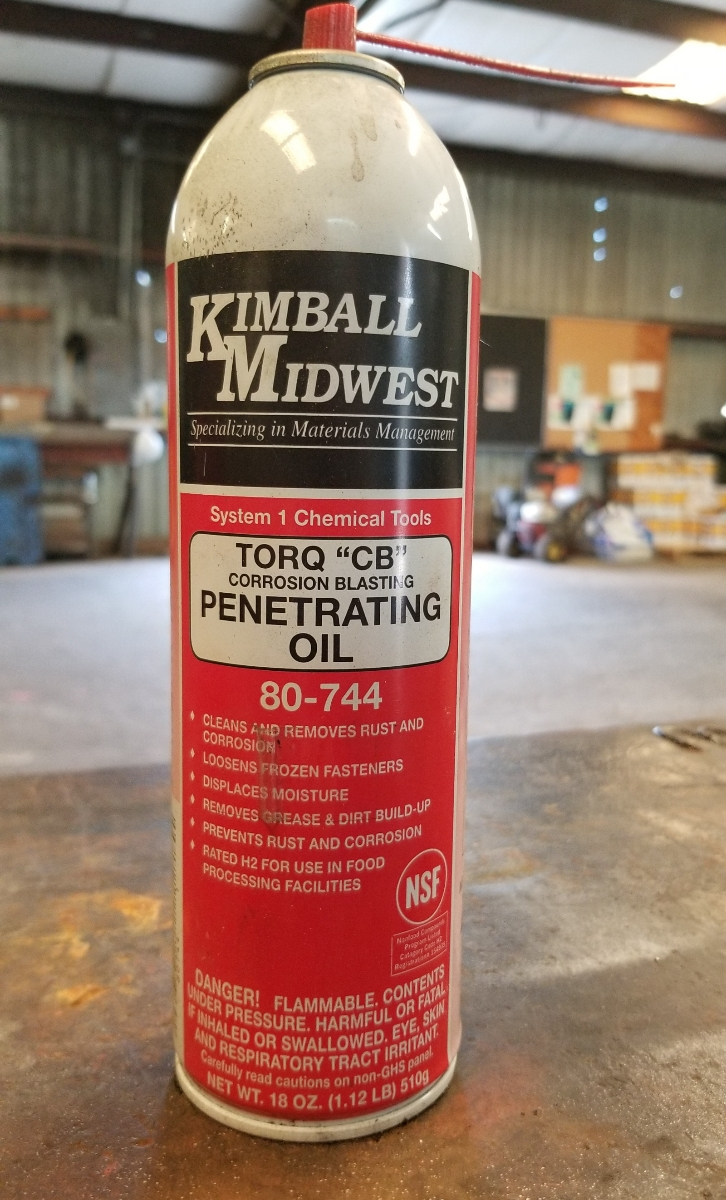

They work for me. I had a 1950 Ford tractor that sat out in the humid weather for decades. It had a locked up transmission and I bought it that way. I wanted to give my father the front axle, so I put penetrant on all lug nuts - front and rear. A day later, added a little more. A day after that, more. On day 4, I put a socket wrench to them and they all acted like they were installed the week prior. If there is movement, my experience is that there is faster action, but even without movement there is success because it penetrates just like the water that entered in the first place. Like you say, sometimes the approach used requires consideration of available time.

This stuff if you can find it, is amazing. As said earlier a couple squirts in morning and again at night. A couple days and it's free. Not as cheap as WD-40 but works tons better.
