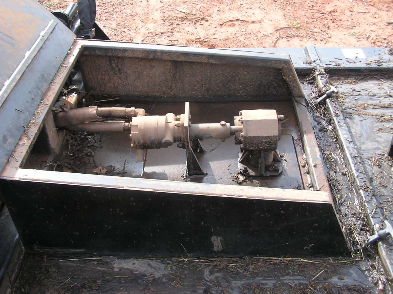

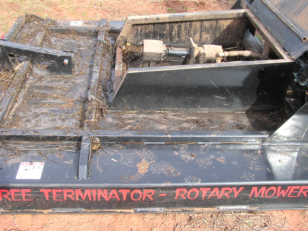

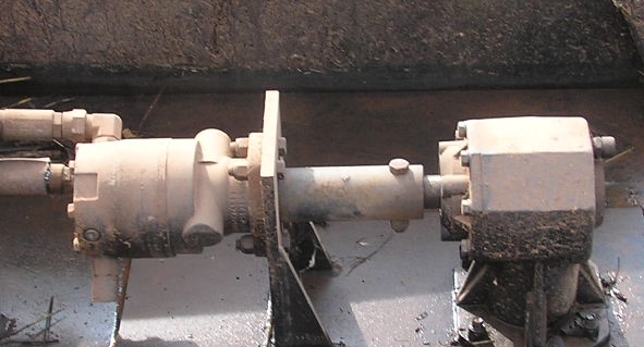

This is what is on my 7' brush hog.

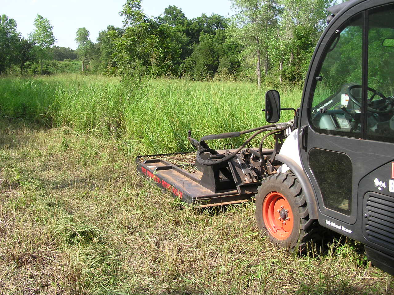

On the Toolcat.
Give them a call, 417-458-4350, see if they can give you a source for the coupler.

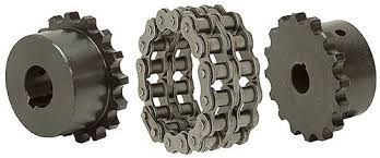

we have used a chain coupler basically two sprockets and a double chain, and allows for minor miss alignment. I think surplus center sells them.
and there are a few company that make weld a sprockets, where one can get various hubs, and weld them on the sprockets so Odd hubs are not that hard to come by.
http://www.ggmfg.com/

I measured the coupler, It is 6" long. The gearbox shaft is 1 3/8". Can't see the motor shaft.
Hope their motor shaft size is what you need.

Jenkinsph has an easy solution. And Tractor Seabee is correct that the relief valve eliminates the need for a shear pin. I had almost exactly the same problem. I used the chain coupling from Surplus Center. The hub was not long enough for a drive pin hole in the proper location to line up with the hole in the gearbox shaft, so I welded a collar of the same size onto it and drilled the collar for the drive pin (actually I drilled the hole on the line between the collar and hub, and left a gap in the welding where the hole was to be). The chain coupling sprocket and the collar will likely be a leaded steel to facilitate machining, so the weld will not be full strength due to the lead content, but mine has held up for eight years of fairly heavy use.
I think the current SC chain coupling uses a double row chain, which may have a longer hub than the single row chain coupling I got from them eight years ago.
