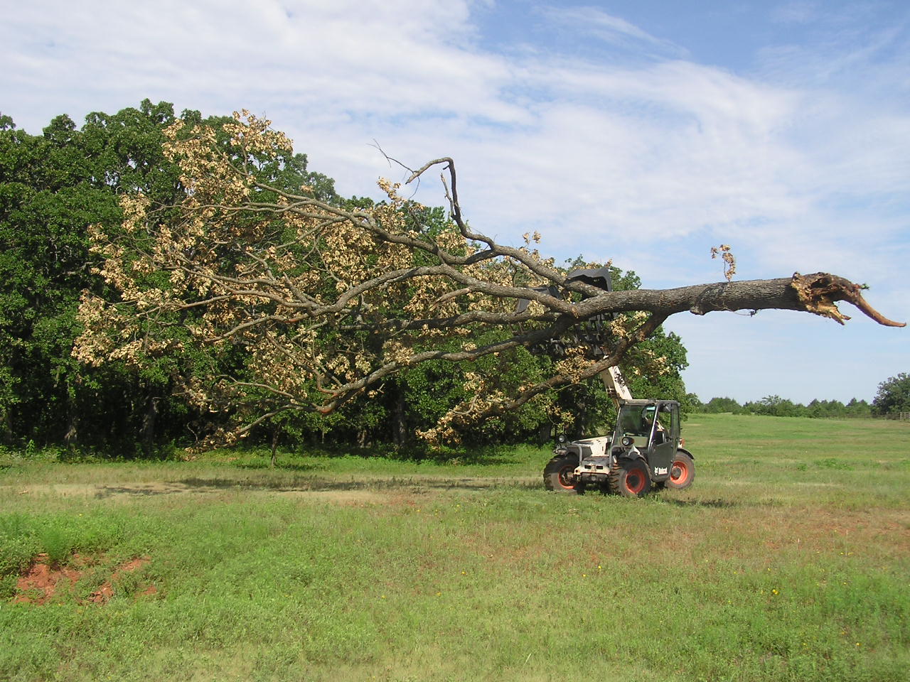

Are you sure about the weight? How many cubic yards of dirt in the 6' box?
This 42', 18.5" DBH oak weighed less than 3,000 pounds:
   / Help finding an appropriately sized FEL or large TLB
No, I'm not totally sure. Weights were based on the 544 our contractor was using that was easily picking up things we needed to move. And a skylift which picked up some trees for us that had a 16k capacity.
Its more that we frequently need to move rocks that our SVL won't pick up and we need to move enough dirt that the bucket capacity is getting frustrating on the SVL. So, I don't need to necessarily do everything the 544 can, though if I could find a decently priced machine in that size range I'd jump on it. But I'd just like most manageably sized machine that can push a 2.5-3yard bucket and has a good lifting capacity.
