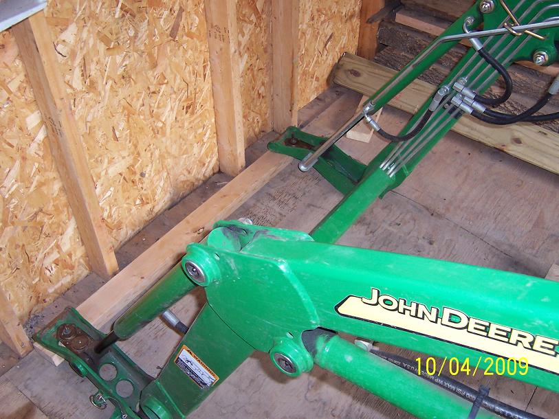

Has anyone detached the loader WITHOUT the bucket on it?
The manual says "Be sure loader is equipped with a materials bucket."
Here's my problem:
I have the loader and bucket detached and as far to the back of my shed as I can get it. I lack about one foot of space to be able to get my gator in the shed and close the doors. I measured and I can see that the gator would fit inside behind the loader if the bucket was not on. I don't mind leaving the bucket out all winter, but I hate to leave the loader out if I can avoid it.
Here's my plan:
I'm thinking about taking the bucket off and bolting a 2X6 across the loader arms in the bucket's place, to distribute the weight while detaching the loader. The shed has a solid, level floor, and using a 2X6 instead of the bucket will give me enough space to get the loader and the gator in for the winter.
Has anyone tried anything like this?
Do you see a problem with it?
Thanks

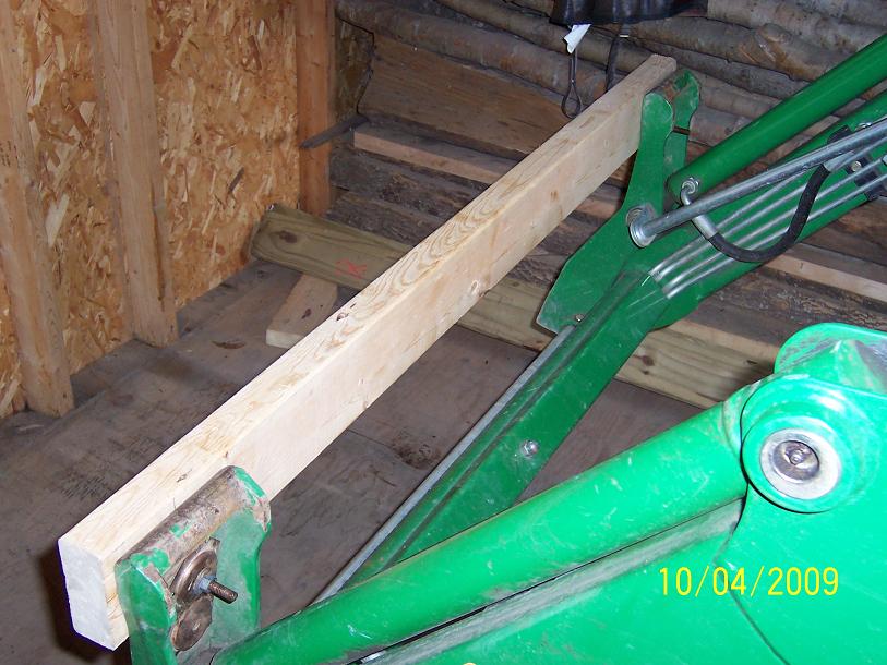

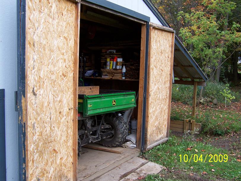

Well, I got the loader and the gator in the shed.
I used a 2X4 (instead of 2X6) in place of the bucket. Gained less space than I thought, because the bucket holders on the ends of the arms are extended, but it was enough to get everything to fit.
Drilled holes through the 2X4, ran bolts through the 2X4, the bucket holder, and metal pieces on the back side of the holders with flat washers.
Worked really well, no problems, in fact it might even be easier, because of visibility in getting as close to the back wall as possible.

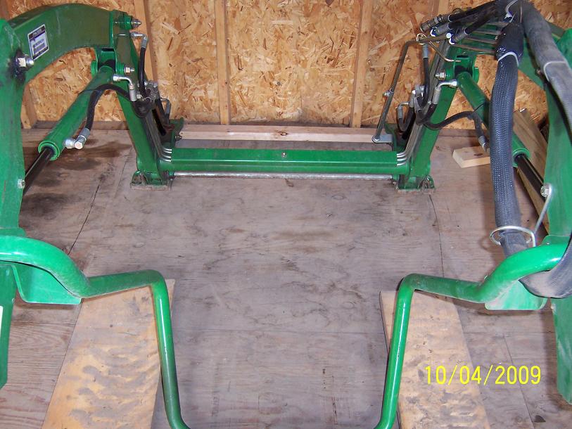

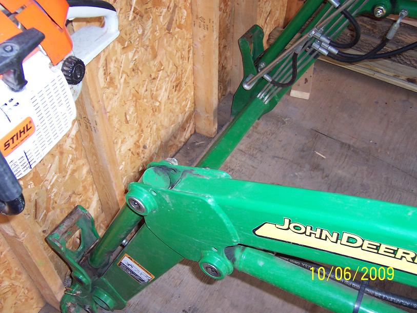

Maybe I need to give this another try?!
I had the holders (with the board attached) pointing straight down and against the back wall. When I moved the SCV through all positions to relieve pressure, the holders settled to horizontal (flat on the floor) and the loader moved backwards.
I think I'll try it like kenny suggested, board attached to loader arms, instead of holders, with holders retracted (pointing up). With no weight on the holders, they should stay up when I toggle the control stick. If that works, it would give me another foot of space.
I might even get brave and try it without the 2X4.
I'll let you know how it works

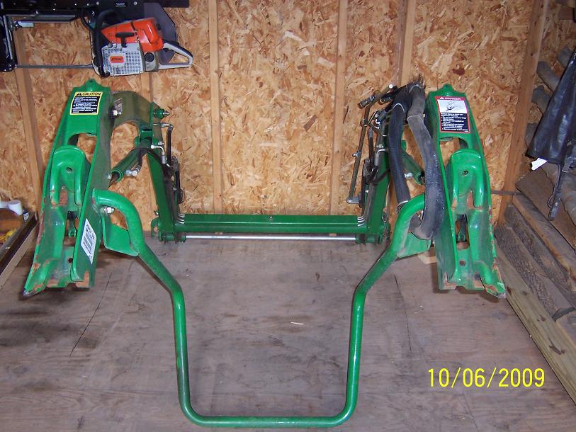

Holders up, no board, gained about 14", no problems.

I had the opportunity to try this today with my 410 loader, I can assure you all this will NOT work well-at least with the 410 on my 4110.
First issue was I could not get the loader arms to go down far enough to lift the front wheels to take the pressure off of the latch mechanism. So I put wood 4x4 blocks under the arms so solve that problem...Next there was not enough weight to "pull" the loader free from the tractor. So instead of just stopping like a smart person would do...I got off the tractor and pulled on it to start it up and off the mounts.
OK, so now I got the loader off and go to re-attach it-should be easy right? Well, the loader shifted, then fell off of the blocks! Now I get it back close to aligning with the tractor and use the hydraulics to pull it on as usual but since the arms are now on the floor the latch mechanism won't engage because it's not high enough!
I struggled (and cursed once or twice) for about 1/2 hour till I finally got it back on!
So, for all you 200CX loader guy's-go for it! If you have the older loader's keep the bucket on just like the instructions say!;)
