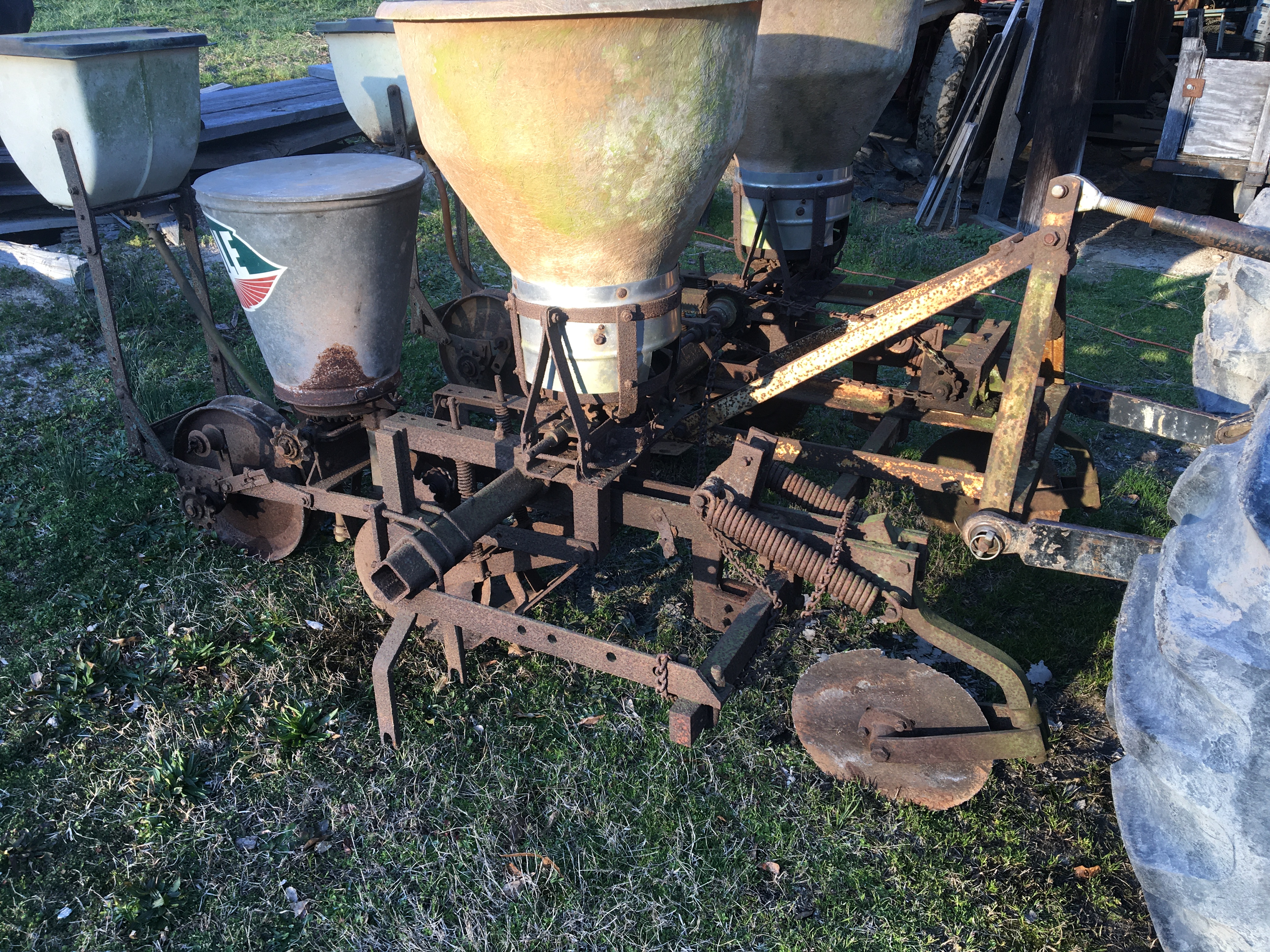

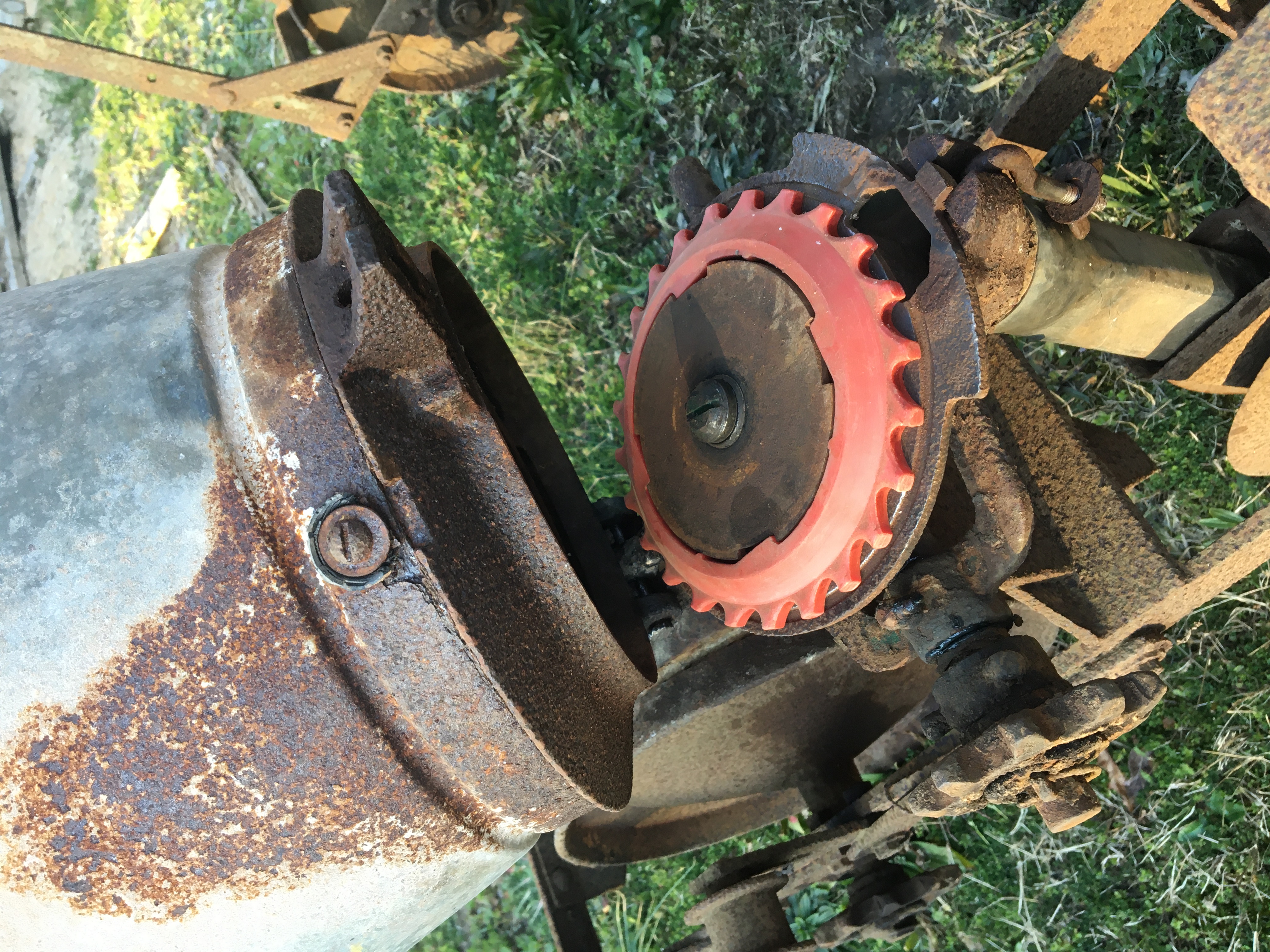

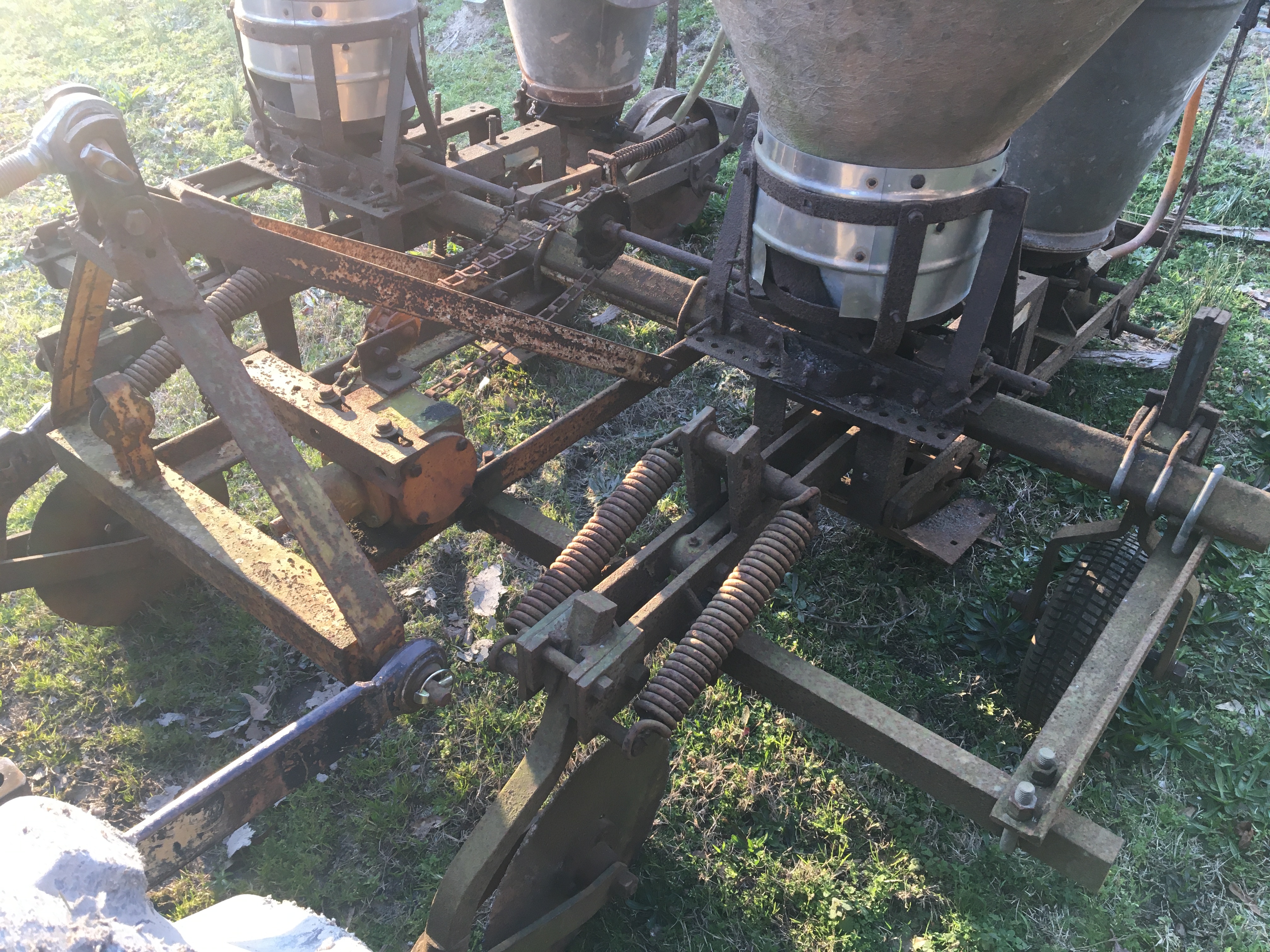

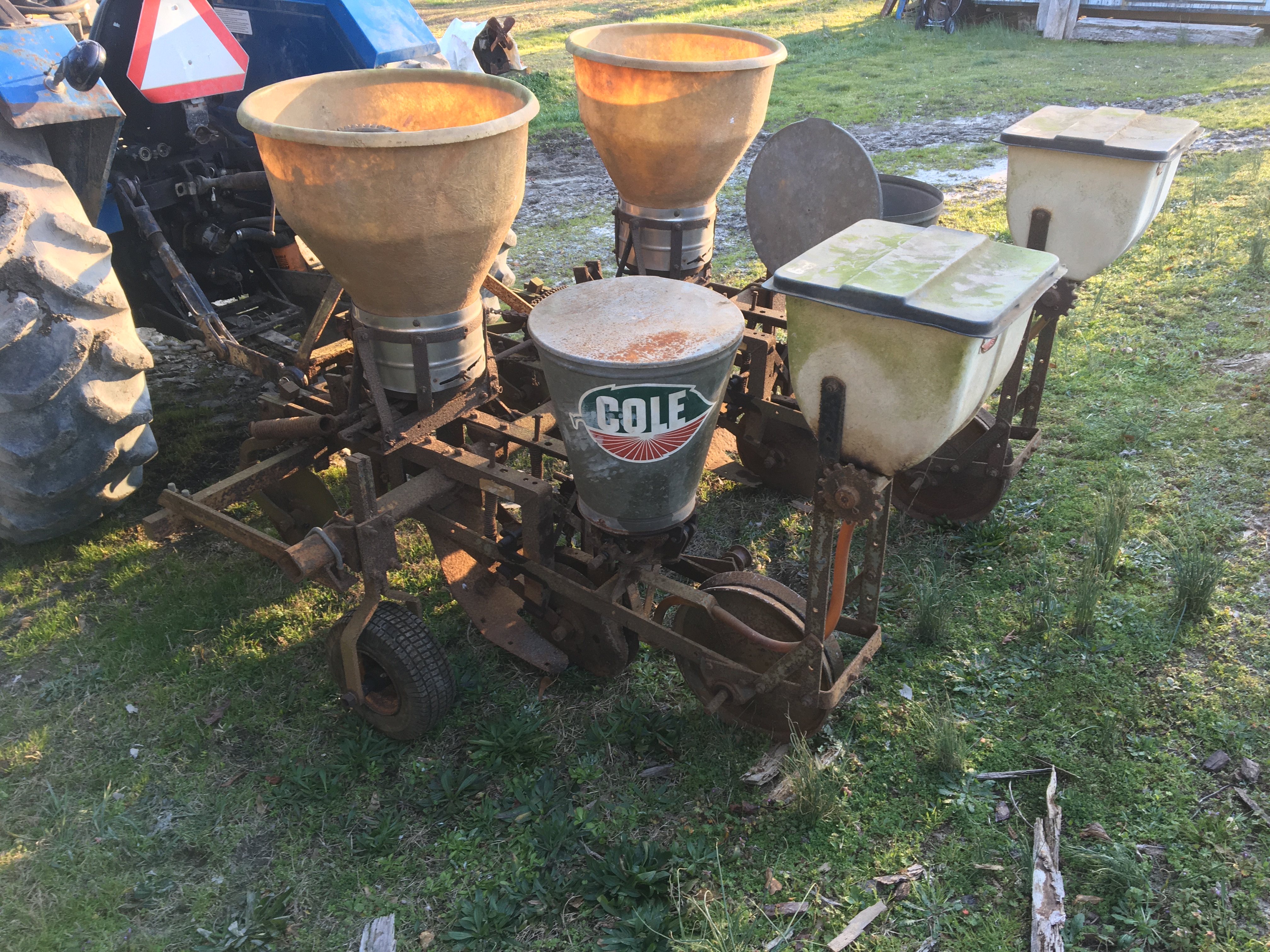

I recently acquired a 3 point 2 row planter from my uncle. He used this planter in the late 70s and early 80s to plant corn and it has been in a shed ever since. I had just assumed since it is printed on the seed hoppers that this thing was a Cole. However, after cleanup and a few minor repairs I'm not so sure. This thing uses John Deere style plates and I was unaware of any Cole planters doing that. Does anyone have any idea what make/model this thing may be? Hopefully there will be pics attached to this post. Thanks in advance.

Sweet little unit..!! Could be those Cole hoppers just happen to be the same size, as that unit used before. And those definitely aren't Cole style plates, at least that I've seen, and that was only 2 styles.
Personally, I'd be looking real close on the cast iron parts, for part numbers. Seed hopper bottom assy., seed drop foot/shoe, things like that. Then use Google to do a search on those part numbers. It may lead you to a parts list somewhere.

Thanks for the insight! I had not even considered looking for part numbers in the cast pieces and I will definitely check on that. I appreciate the reply back and if I'm able to figure something out I will post back and let you know.
Thanks again.

Any chance you found out what it was. I just acquired same planter and im trying to figure out what it is as well
