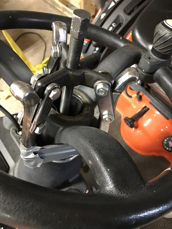

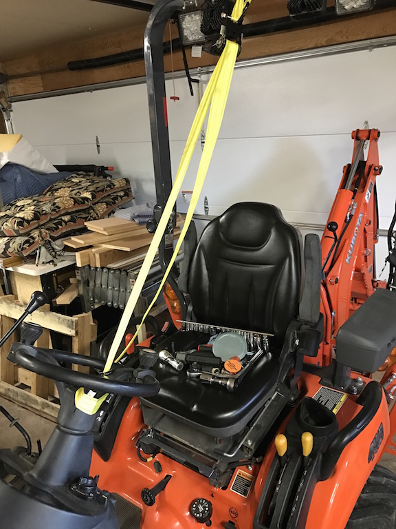

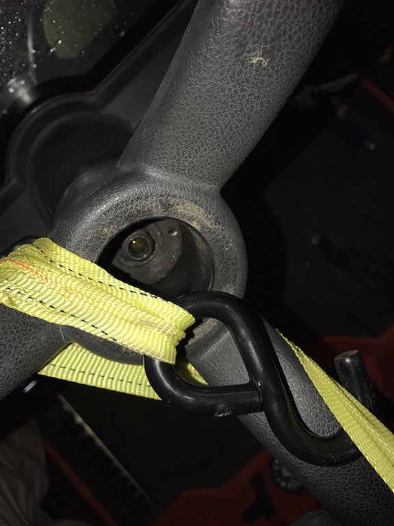

Yeah I have the WSM and no help there but I can see it looks to be a spline gear that should slip off. I did some tapping on spindle (or whatever you call it) while trying to pull the wheel off. Put a come along strap around the ROPS while tapping. No luck. Saw on Youtube a guy use a U bolt that snuggly fit around the wheel column base and then use a two jaw gear puller on what looked to be an older JD tractor wheel. Going to try this method this afternoon. Let it sit overnight with a couple doses of WD40.
Doubt the attached pics help other than maybe give you a laugh.

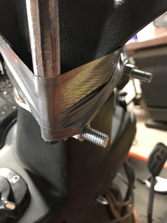

Good news! Got the steering wheel off. Used a three jaw gear puller with a 2-1/2in U bolt. The jaws would not engage the column without the U bolt around the hub. Duct taped the jaws to help keep them from slipping off. The spline gear was dry and seized so I lubed it with some Permatex anti-seize so hopefully I don't have this trouble again.
