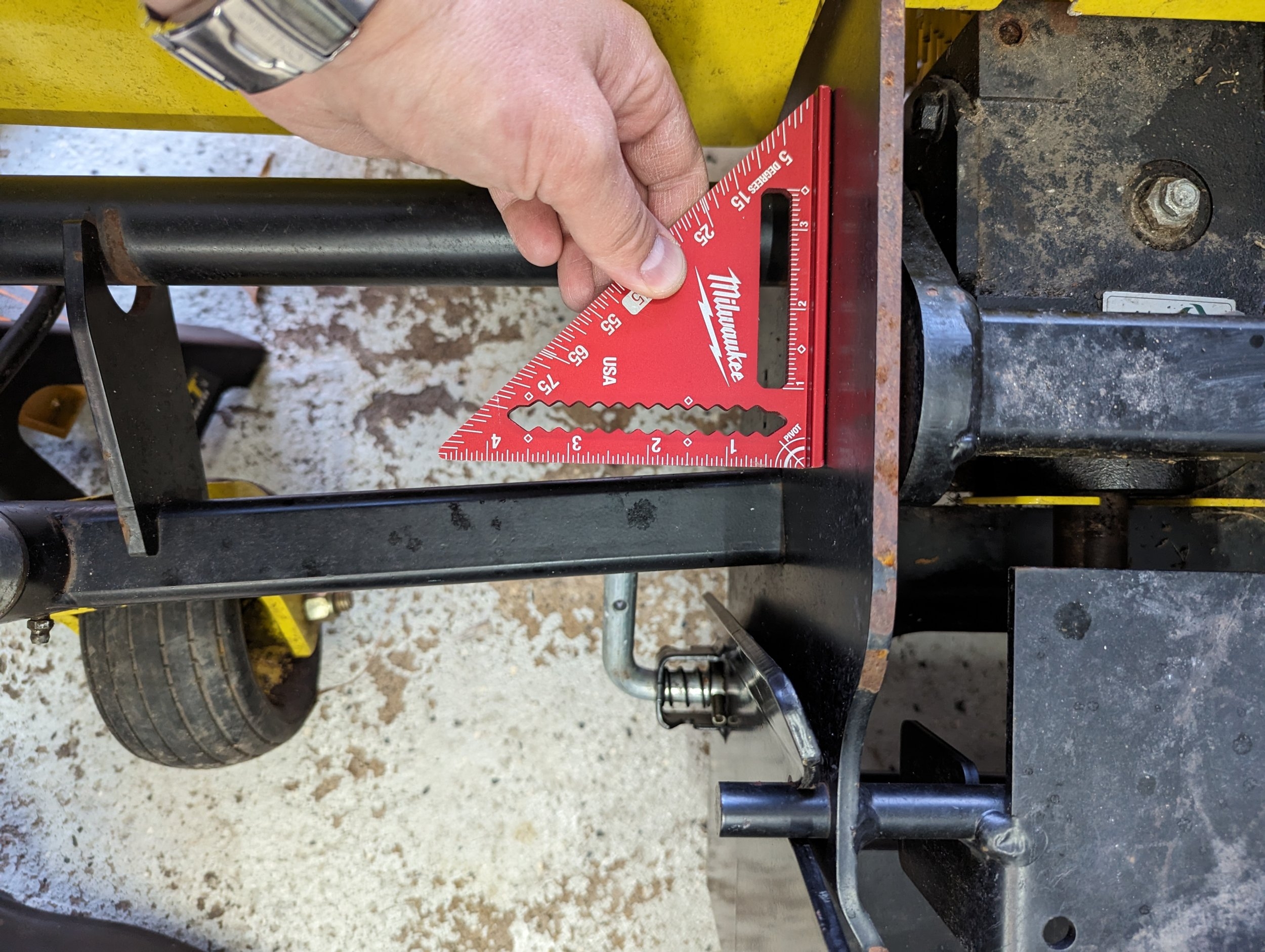

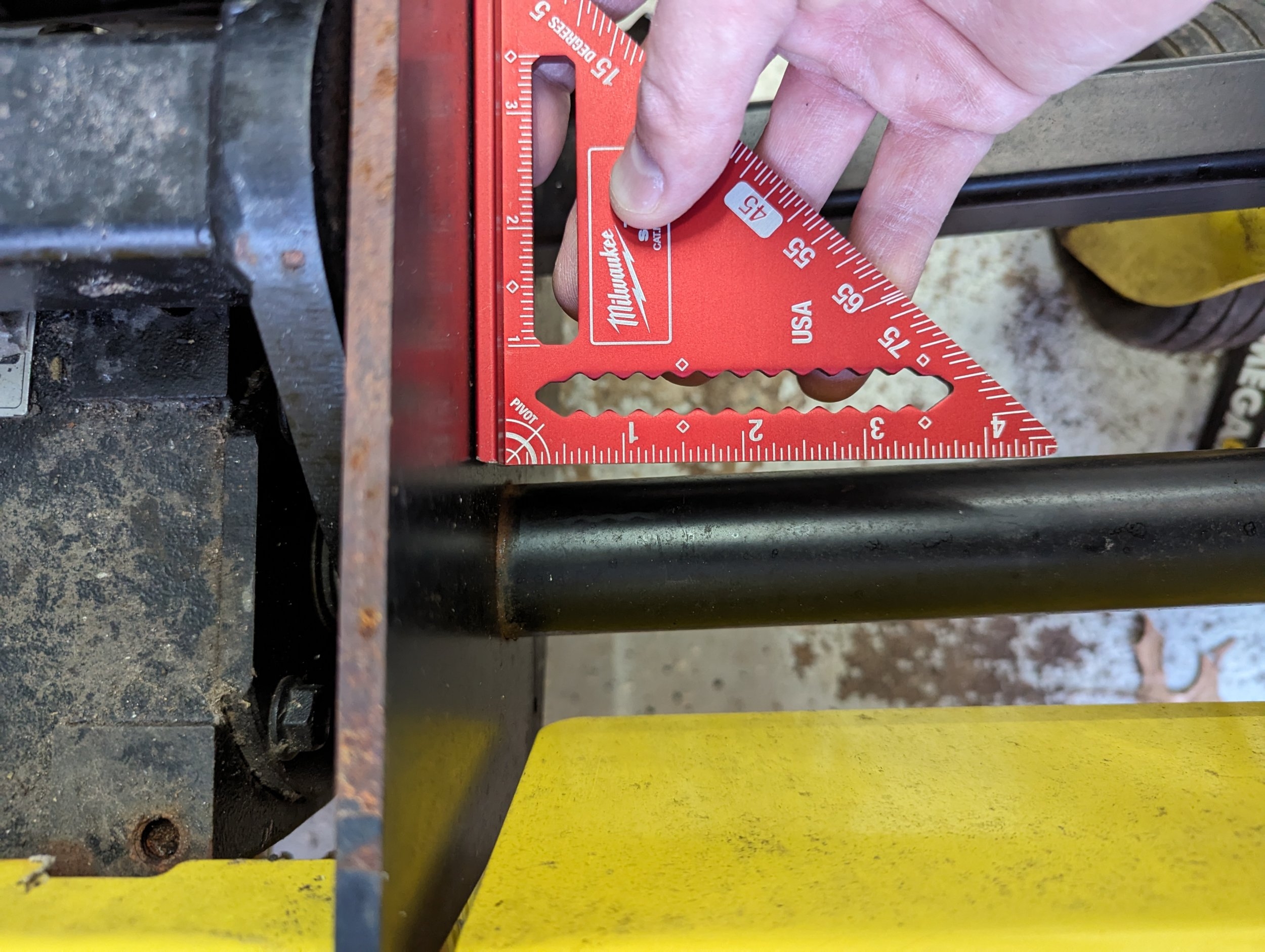

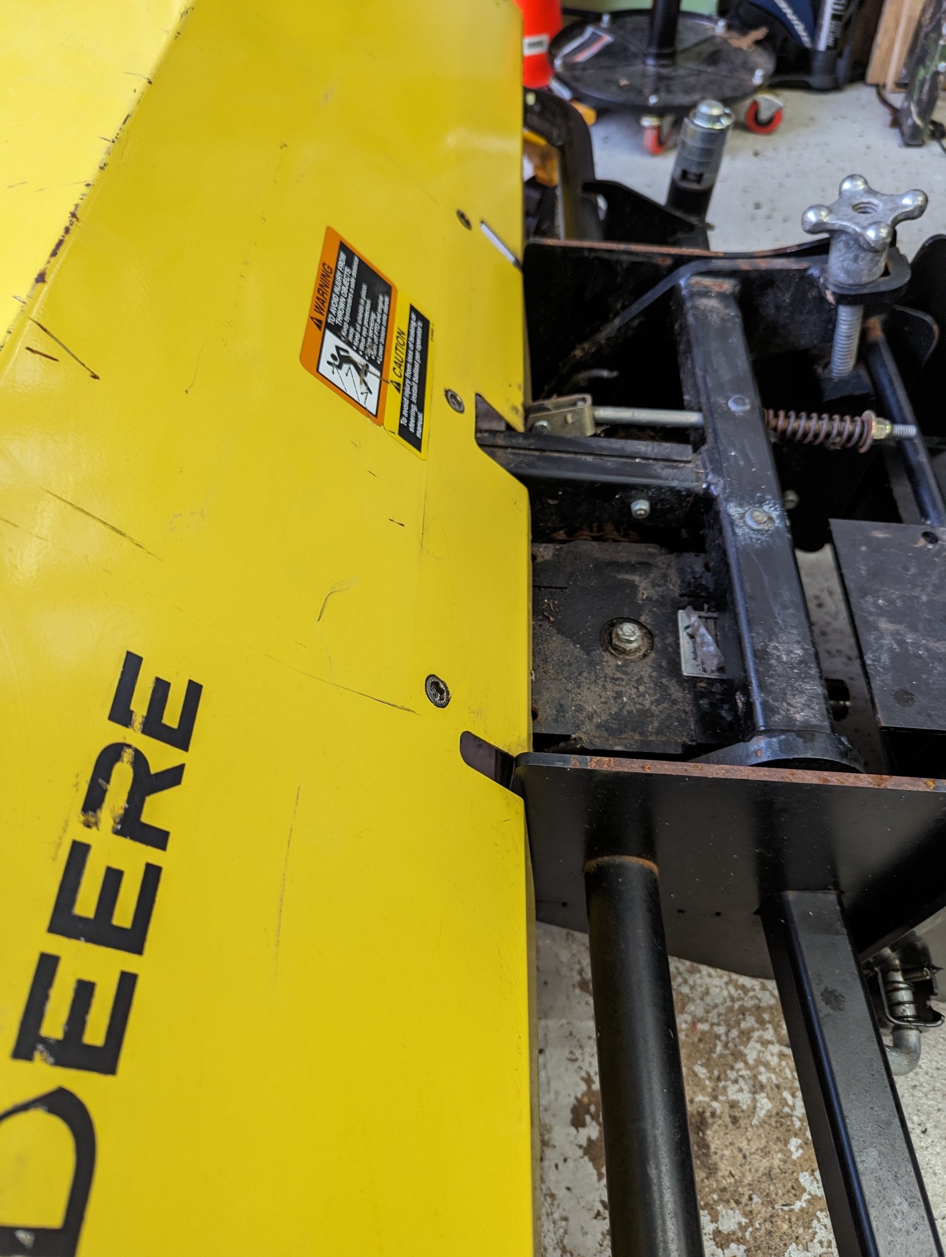

So I bought a front broom, unfortunately it is bent pretty bad, see attached.
What's the best way to Bend it back?
Can't use heat, too many pivoting bushings.
I was thinking a jack, but I can't figure it out
Any thoughts how to bend it back?

   / Help Bending Metal Back #2
Do those bends impact the sweeping?
On the left side of the first photo there appears to be a flat bar that cups around a round bar. Is that supposed to be welded?
You can purchase hydraulic rams and pullers. However, you would need a solid place to secure it to.
A come-along or winch may also work, but could be more dangerous and you would pull strength issues.
To be effective cold bending a joint, you will also have to over bend by a few percent and then let it relax back. If the machine design is such that you can't fully bend past your desired stopping point, then you will have difficulties relieving stress from the joint without heat. And if you have to weld a joint like the flat/round joint above, that will remain under stress unless the primary bend is also fixed.
So I'm not entirely sure you'll be able to avoid heat and bending or cutting and re-welding the joint.

Are both bent pieces on the same side? From what I can see, I would put the front of the broom against something that wont move (tree, telephone pole, etc) then use a come along, chain and binder with big pipe (etc) wrap around post and bent piece, pull back into place, reweld

if you could tie it to the ground level then jack it up from underneath to straight it out, or hook it up to your tractor engage the breaks and chock the wheels and used a come along to pull it forward. In order to bend something back in place you need to go past the center alignment point and without heat there is a chance for something to break. ... It is very hard to get something bend back to its original location sometime it is better to leave it as is.
   / Help Bending Metal Back #5
Wish you were nearby. This would be an interesting project. I'm not familiar with that implement and would love to see it in person. It appears the coped plates on the square tube only contact the round tube like a guide and were never welded to it? Both the round and square tubes look bent to at least some degree.
How difficult is it to get that yellow shroud out of the way? To what extent can the implement be disassembled? It is often easier to work on individual pieces. Should be fairly simple to make a jig or two that can be used with a portapower or even a hydraulic jack.
Depending on how accessible pieces can be made, springback from bending can be an issue. This is where it would be handy to do disassembly. For example, if not taken apart, I'd straighten the round tube first. No problem there because there's room to "over-straighten" it so when it springs back it is in the correct shape.
Problem that I'd expect is that when working on the square tube it will bump into the round tube before sufficient overbend is made. A possible way around that would be to get the square tube bent as tight to the round tube as possible and while keeping it clamped apply generous heat to it and keep it clamped till cool.?

   / Help Bending Metal Back #8
Gonna be nearly impossible for us to either; one, tell exactly how to fix it based on pictures and two, relay that to you via the written word. But, just to put in my two cents, it does not appear to me that the square tube or round tube are actually bent. It looks like they're pulling out of the holes that they secured to. I'm not seeing any weld securing them to the plate that they penetrate through. Are they bolted in some way on the other side where we can't see or are they welded? Almost looks like they may be removable.

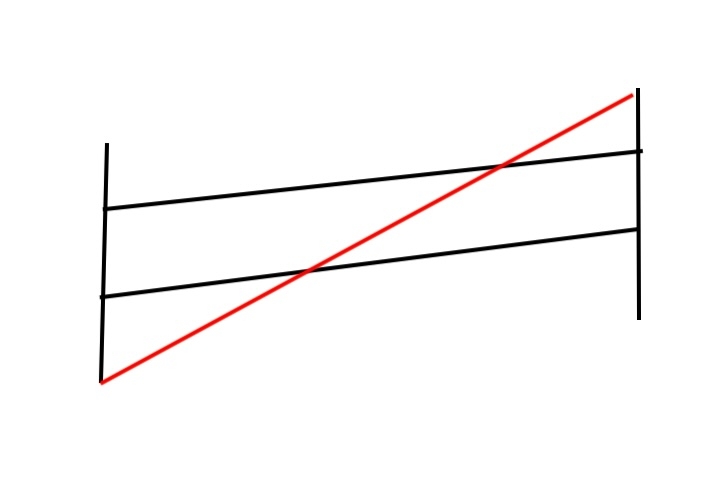

   / Help Bending Metal Back #10
We often think of pushing something to straighten it, but this requires a solid base or anchor. Sometimes pulling works better.
in a case like the diagram, pulling along the red line makes the implement its own anchor. You might use a hydraulic cylinder hooked to your tractor, or a ratchet binder.
Bruce
