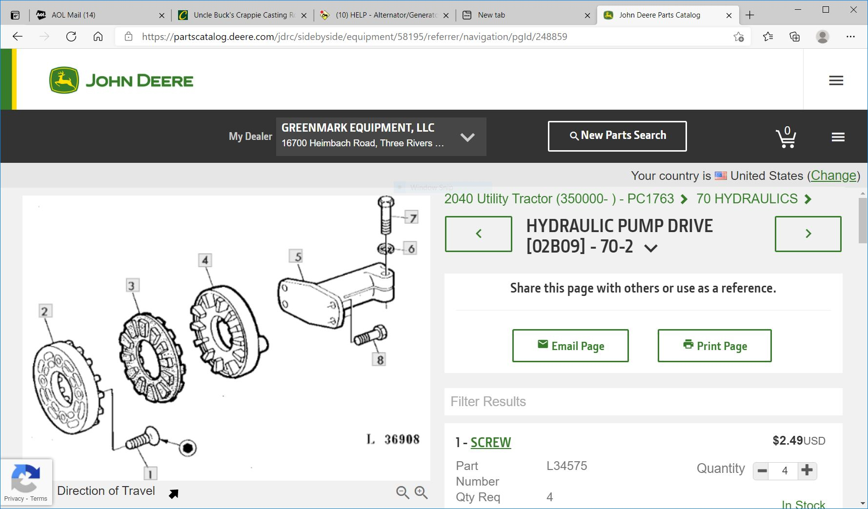

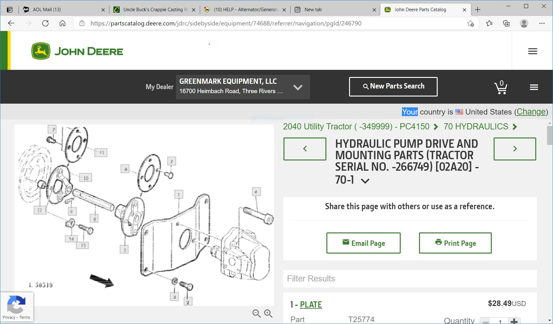

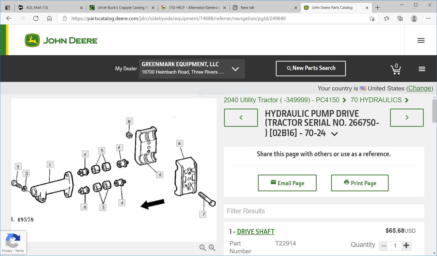

JD used three different pump drives. I have #3 on my 2030, (last drawing) for it, remove the two coupler halves key 6. Then you can remove the belt. Check the rubber bushings, key 5, replace if worn.

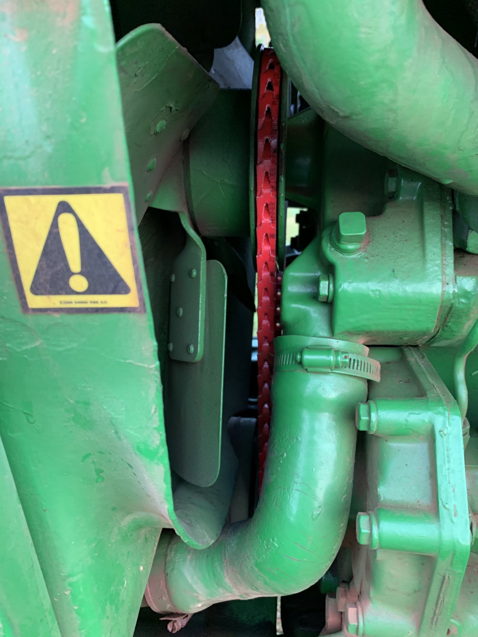

I have a 2440 and when the belt on it started to fail I removed it and put in a sectional drive belt. Took 20 minutes and saved a bunch of work. A year later still going strong.

I have a 2440 and when the belt on it started to fail I removed it and put in a sectional drive belt. Took 20 minutes and saved a bunch of work. A year later still going strong. View attachment 700164
Which drive does yours have? I've only seen the one shown in the last drawing in post #4

The "link belt" shown in post #5 would be the way I'd go. I put one on my lathe and it's held up for years. Having to disassemble the head on a lathe to change a belt convinced me. HF used to carry them for about $20 as I recall.
Otherwise, you have to unbolt the pump and slide it back (foreword) enough to open a gap.

JD used three different pump drives. I have #3 on my 2030, (last drawing) for it, remove the two coupler halves key 6. Then you can remove the belt. Check the rubber bushings, key 5, replace if worn. View attachment 700159View attachment 700160View attachment 700161
My tractor uses the center type pump setup. IF I don't go with the option presented by 'tinhack' I was thinking of removing the radiator, undoing the two nut/bolts at the coupler on the engine drive plate and then 'snaking' the belt in that small area then reassembling. A lot of work at best. I had read that to remove the pump I could remove the cotter pin #9 then slide the shaft back. GREAT if the shaft isn't rusted. IF it is, well good luck...
