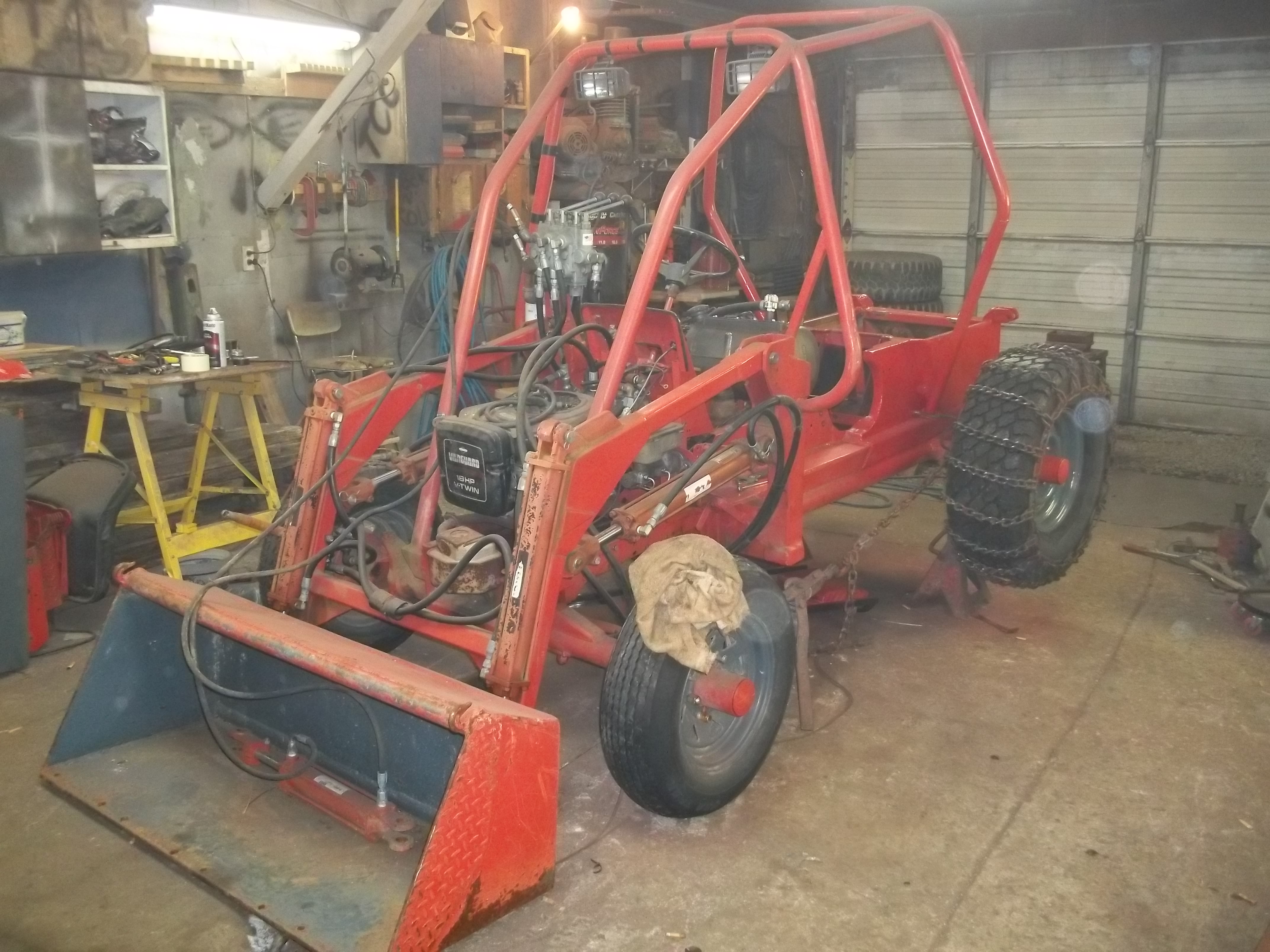

here is my homemade tractor, thanks godbless
   / hello from ky #2
welcome!!! What did you use for a clutch and Trans?
   / hello from ky #5
Love the name! Welcome!
Special use tractor?
   / hello from ky #8
Nice job. Did you build it for a special task or just because you had the ability to do that level of a project?
   / hello from ky
#9
thanks guys,,not for a special task. it started as a cheep mtd, not much mtd left as i kept breaking it
im running a half ton chevy front end that i narrowed welded solid for posi in the rear, and half ton axel for the fromt with the stump cut out, a 4 spd bulldog trans and a case hydro motor , chain driving the 4 spd,
and a 18 hp vanguard to run the pump, my only trouble now is leaking hydro npt fittings , soon to change over to steel lines,lord willing , i couldnt afford a new tractor so i had to build one, one piece at a time lol,, thanks godbless
