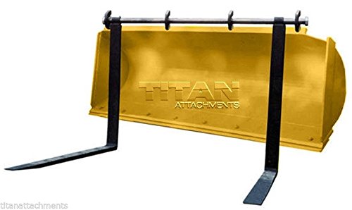

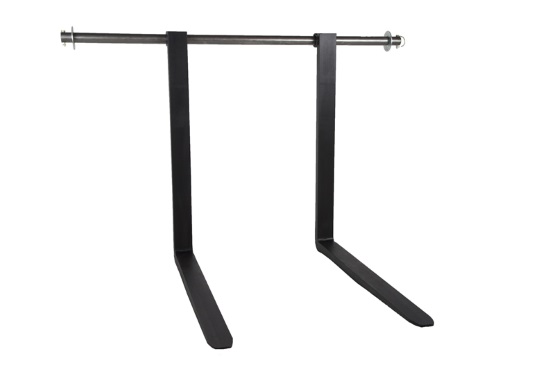

You could also have the welding shop make a set of forks for it.
   / Hello all and I need help! #4
I have a set of Ford factory loader forks sitting in my barn.
They are not quick attach, and have been in the barn for 30 years!
30 years ago I had a welding shop make me a set just like these.
I have used, and loved them for 30 years.
Forks are the absolute handiest tool to have, and I do not need to leave the seat to hook them up.
The capacity of my factory forks is 2000 lbs., the capacity of this type, out beyond the bucket, is only 1000 lbs.
Works for me though!
