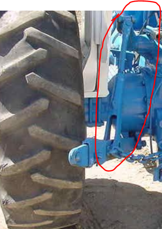

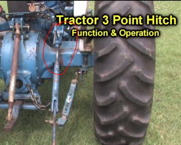

Adjustable length lift arms? Can you post photos of them? I have seen extendable lift arms, however they are for hooking up an implement and will retract if compression is applied to them. They are not designed to be used extended. However adjustable length lift arms are something I have never seen before.
This is from everything attachments. The vertical lift leveling assembly is the correct terminology. I should have said vertical lift arm to be clear.
   / Height of 3 point hitch
#12
I understand this as the vertical lift arm.
   / Height of 3 point hitch #13
The fixed side is known as the side link, the adjustable side is the leveling arm or leveling box assembly. Not sure why one side is a link but the other is an arm. I am sure there are other regional names. The lift arm are the two lower horizontal pieces that attach to the implement.
   / Height of 3 point hitch #14
Some of them dear Johns had square tubing with a solid bar inside it and the lift arm balls on the end of it. I never owned one. They did extend.
The 20 series and later had this, this was just for hooking up with. There was no way to keep them extended.
