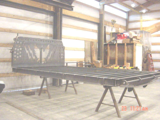

I had a 2004 F-550. I built a 14-feet flatbed dump. The dump unit was rated at 10-tons. But with an extra fuel tank I had to mount the dump unit closer to the rear axle. So it would only dump 5-tons. First trip to the gravel pit. Guy was loading the truck with a 988 CAT loader. I was watching the truck to see it squat. After a while I walked up to the operator, and ask how much weight he put on the truck. He didn't know. I went to the scale. 7 1/2-tons! Boy it's so nice to have a dump bed, but have to unload 2 1/2-tons with a shovel! :rolleyes:

Yeah SA, but you sure have a good dump angle on that bed by moving it back! If you can get it up, it's coming out, wet mud or otherwise!

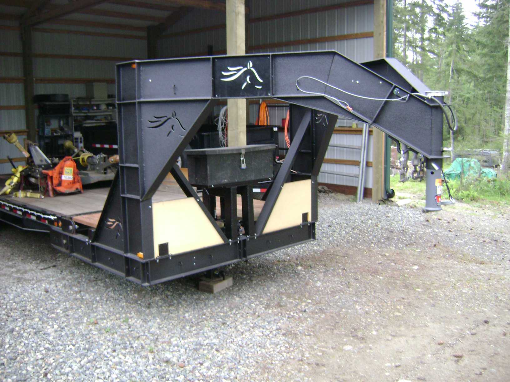

5th wheel equipment trailers are rare, can you post a picture of it?
I have a 18' deck, 4' dovetail, 14K, steel deck trailer that weighs 5K with 1K on the gooseneck ball.
My 3/4 ton 2006 GMC diesel handles it just fine. Heaviest load was 12,640 on the deck, 3440 on the ball, 14,200 on the axles, for 24,940 GCVW.
This load is only 12,660 on the axles, 2,300 pounds on the ball.
