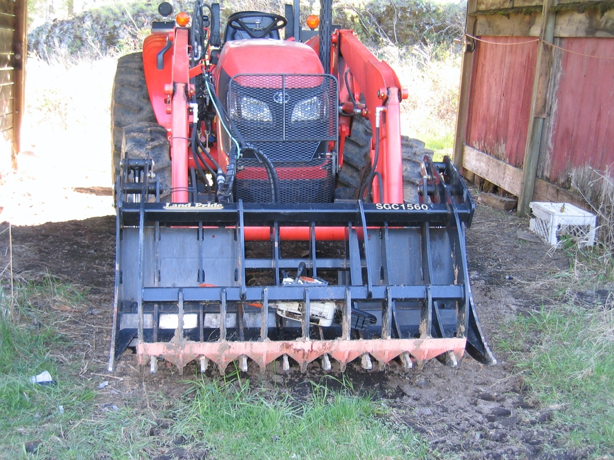

My grapple is 60". It's basically the same width as my front tires. I did not get the 72" or 84" because I could see no benefits to wider and heavier. In this Land Pride model ( SGC1560 ) - 60" is the narrowest they make.

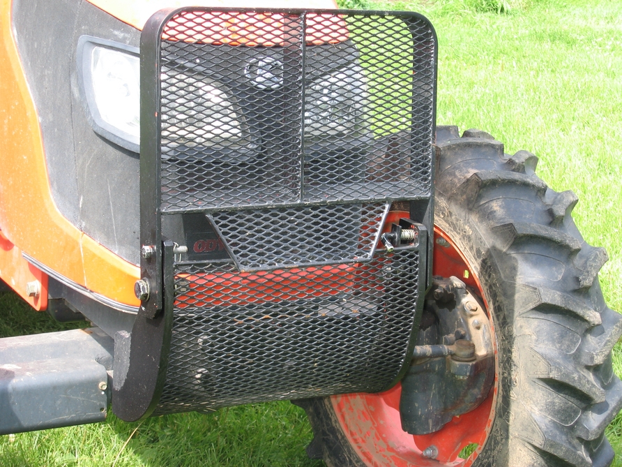

Somebody - back there in the dark - mentioned the grill guard. Anybody with a grapple should consider modifying the guard to repel stick, stobs and limbs. You will be surprised how much damage can be caused to your grill, radiator or battery without some form of modification. This is what I had done.........

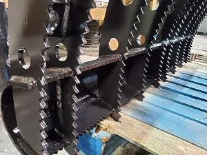

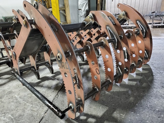

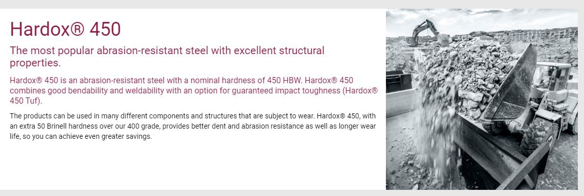

Hardox AR...
The reddish coated material you see here is Hardox 450.

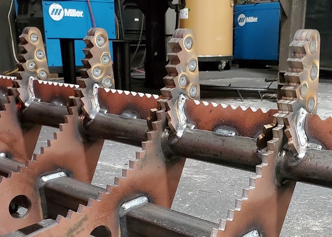

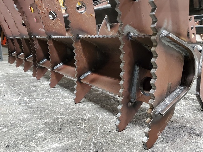

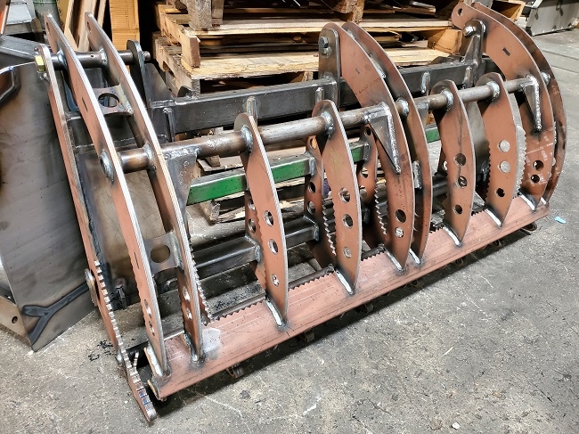

Wicked 55 and Wicked 60
Check out how much this is bent, to create the horizontal Wicked TEEF, and keep in mind that it has to be bent more than this, due to the bend memory strength!
Wicked 66
And it now has the horizontal Hardox channel for better grip and raking backwards.
