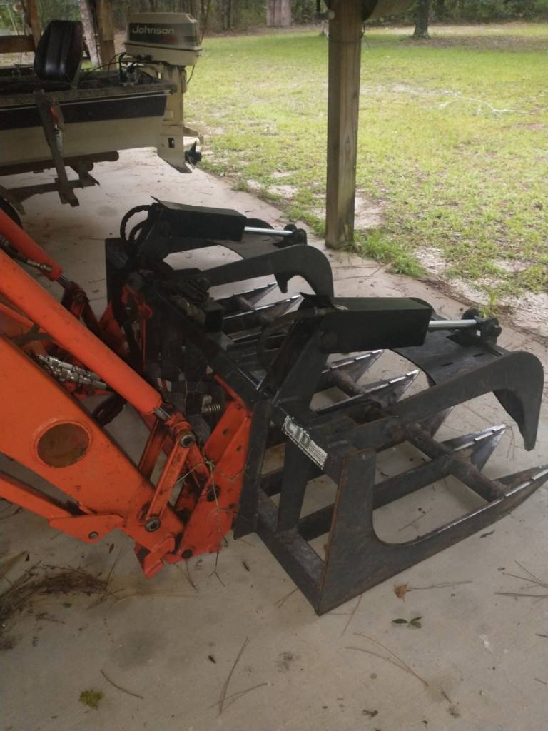

I am looking at buying a double claw grapple for my L47. I have my eye on two grapples weighing in the neighborhood of 1,000 lbs. The L47's lift at pins to full height is 2,800 lbs. Does anyone have experience with a heavy grapple on an L47 or similar spec tractor they can share? Just don't want to regret the grapple weight later, although I don't expect to lift more than 1,000 lbs with it. The L47's backhoe will serve as my ballast. I do want the construction features of a heavier grapple. Thanks

A grapple is an easy thing to abuse. I don't have experience with your machine but understand it's very "robust" and I'd possibly sacrifice some grapple WIDTH before strength in its overall construction.
Put a ton in your bucket or pallet forks and put the tractor through some maneuvers that might either test the stability and spare capacity.
Short of an actual loaner/demo or finding someone with the same combination, I'd think that's about as good of a guess as you can expect.
Good luck. 👍
   / Heavy Grapple on Kubota L47? #3
That's a heavy grapple I would not put that on my tractor.. You can find one half that weight that will work and last...
   / Heavy Grapple on Kubota L47? #4
A 1000 pound grapple is a lot for that size machine. I’d look for something lighter.

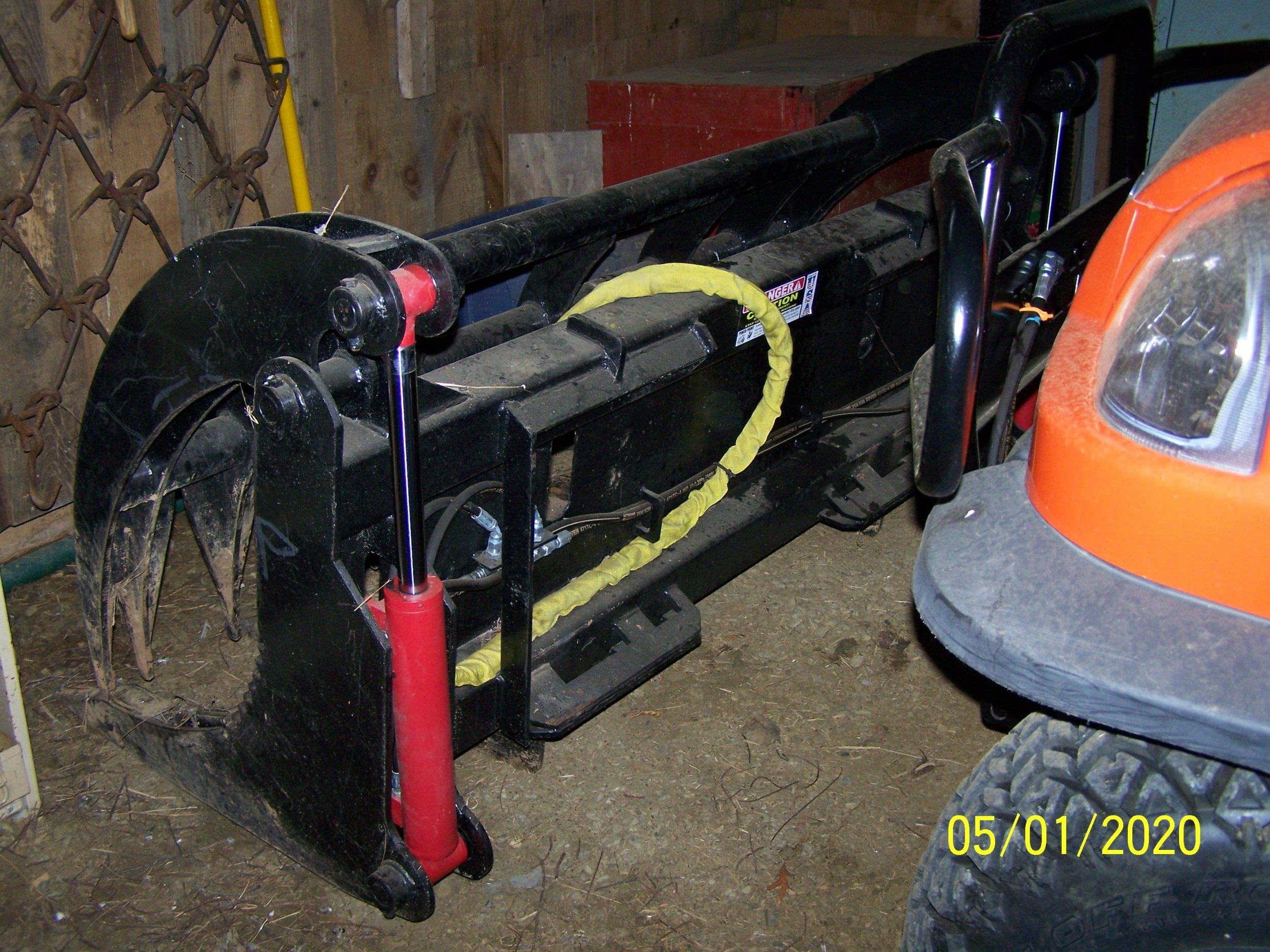

I run a 6ft cid grapple on my MX, yeah it's a little heavy at #950 but it handles it fine. I use a backhoe or rhino blade as ballast.

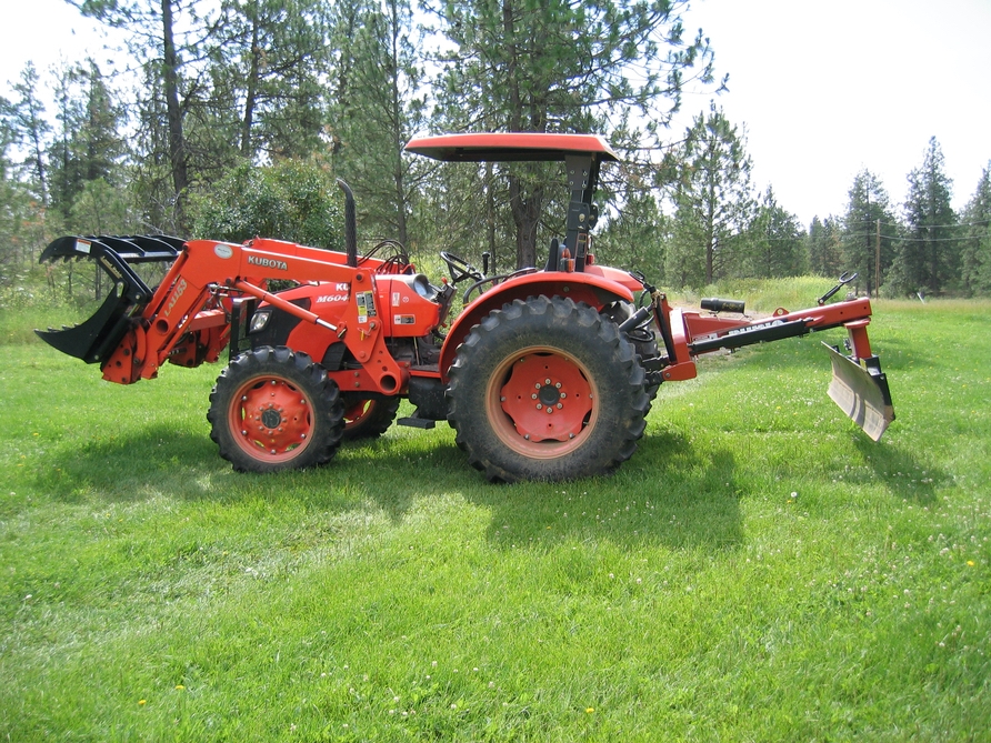

I have a six foot - 800 pound - Land Pride grapple on my Kubota M6040. I've had it nine years and love what it can do. I have a 1000 pound Rhino blade on the 3-point and 1550 pounds of RimGuard in the rear tires. I can safely lift 3000 pounds. At this lift weight - I move in a "form" that I call - knuckle dragging. Just high enough to get the load off the ground. Check the weight lift charts in your FEL manual. You will find this - the lower the load, the more you can lift. The closer the load is to the lift pins - the more you can lift.
The ONLY thing I EVER lift to full height - an empty grapple. I simply have no job/or reason to lift any size load to full height.
The heavy loads I lift - chunks of pine tree trunk - LARGE rocks. On the internet I have found weight lift charts for logs( most all species ) and rocks( most all types). I use both of these charts extensively.

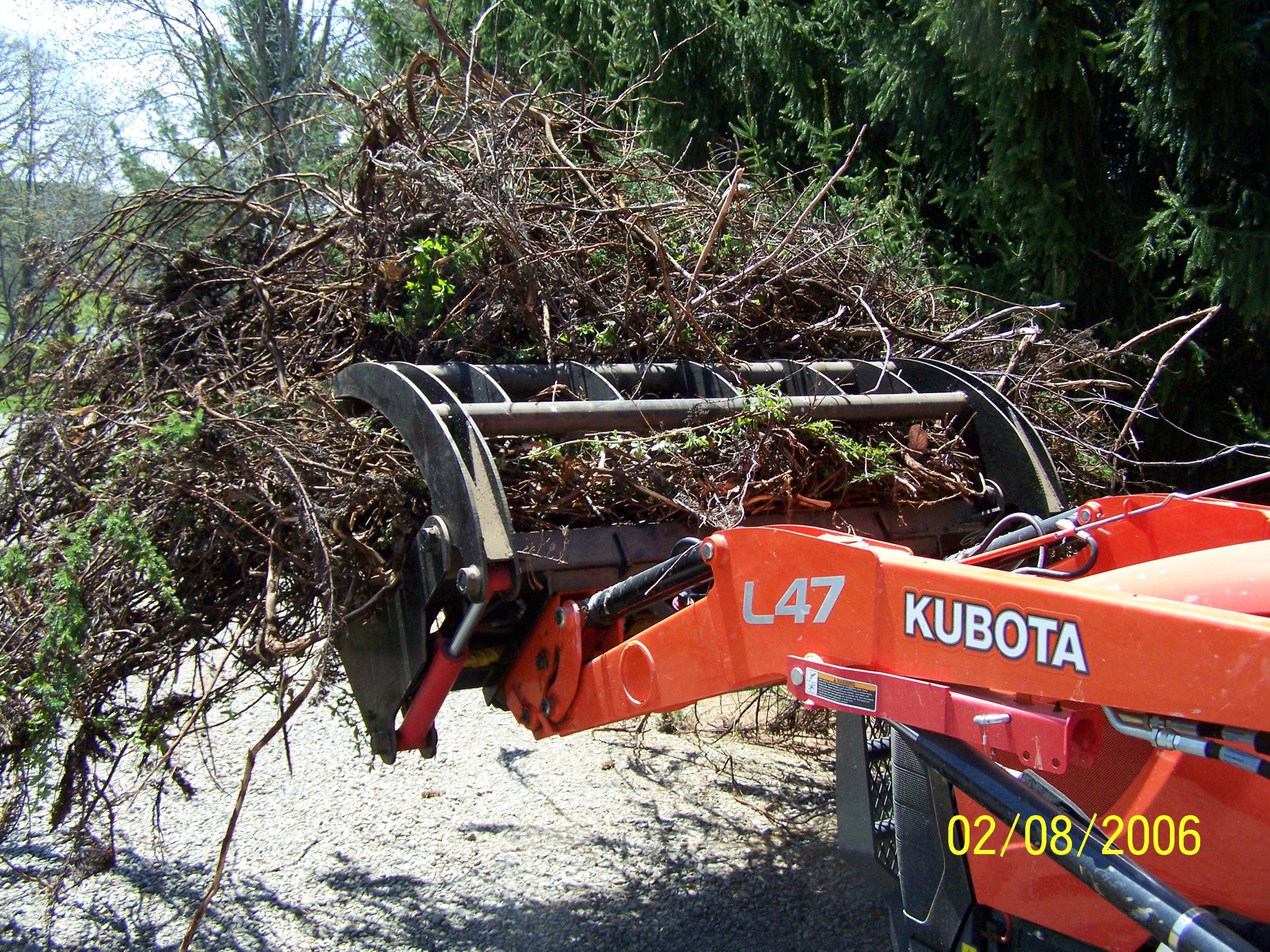

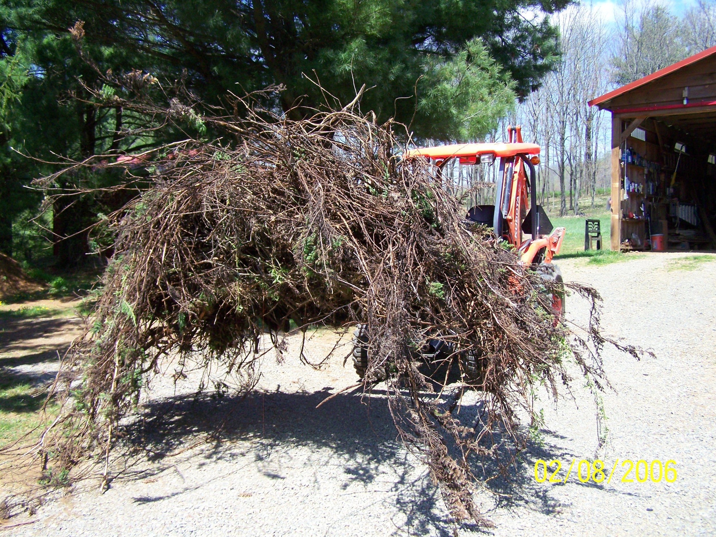

My 66 inch root rake/grapple runs around 800lbs. I no longer have the spec sheet, so that is a SWAG.
I originally bought it for a tractor I had that was larger than my L47. Sold the tractor, kept the grapple.
I have had no issues with the combination, but if I was buying a grapple with the L47 in mind I would look for something lighter/smaller, maybe a 60 inch.
I've picked up some good sized logs and rocks and really have no complaints. Those L47s are powerful machines for their size.
