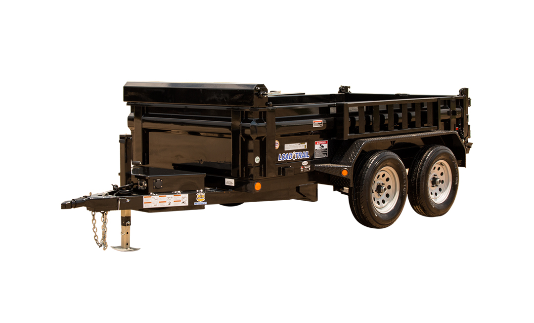

My 10 foot dump trailer is 20 years old,,
and,, I am positive that for 17 of those 20 years,, at least one of the incandescent bulb has not worked,,
The lights that I have always used are the typical multi-function trailer lights,,
they really do not suit a dump trailer,, something always falls on one of those lights,, GONE!!
I am going to start with these steel box, grommet mounted LED lights.
I will probably add some more steel above and below these boxes for extra strength.
I am still looking, but, I have not found a similar system for the front amber lights,,
I may have to DIY the amber lights.
Any pics of guarded amber lights?? Some ideas of a successful light would be helpful!
Also, I believe I am supposed to have three lights centered in the back of the trailer,,
are theses supposed to be red or amber?
Any pics of guarded three rear center lights??
Help me do this right,, so I am not doing it again in 12 months,,, :thumbsup:

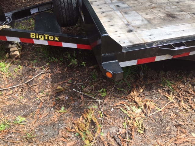

This is the front amber light on my equipment trailer. In a protective housing. My dump trailer is at another location but it has the same sort of thing except the back edge of the light housing is integrated into a step at the front of the fender.
The equipment trailer has three lights in the middle all red.

I think I will try this,,
a 6 inch length of 4X4 square tube, 3/16" wall,,
The amber light will mount inside, I have the 3" hole saw shown,
so, as well as light out the sides, the light can get out the 3" hole,,,
That bracket should be strong enough to be a point to jack up the trailer ,, :thumbsup:
