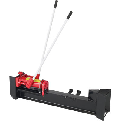

Back about '09 I was burning wood in Virginia. This was just for supplemental heat in a cold basement rec room. I bought one of the Northern Tool manual nordic track style woodsplitters.
I'd split wood while watching football. Warmed me twice.
