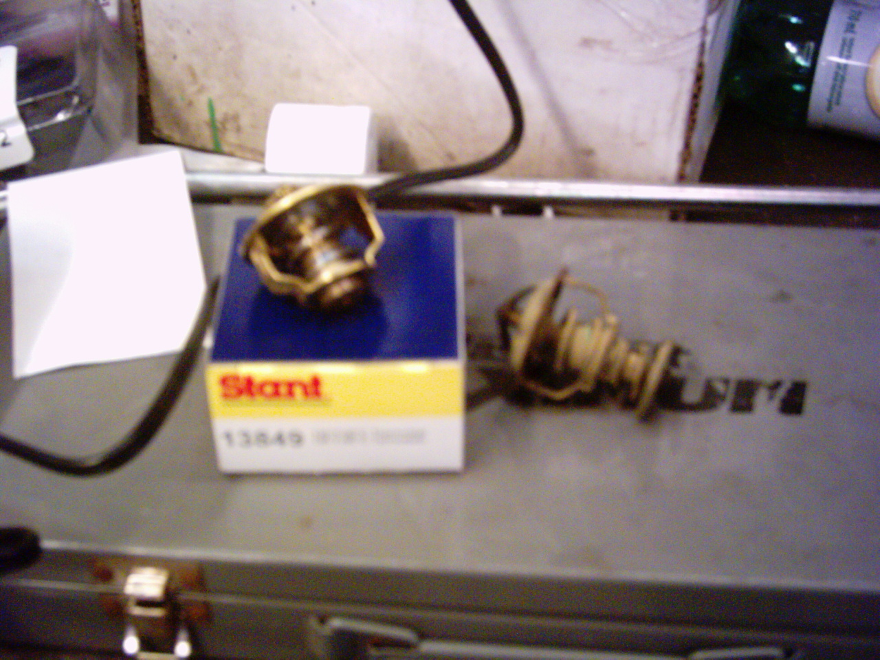

I had a window fogging issue on my DK45SEC, to cure the problem i went with an aftermarket thermostate, since kioti has only one model which is a 180. Now i must remove my coat and put down the heat to stay in the cab, even in the freezing winter days of Quebec.

I do not know if this is is from a change Daedong made or just Bobcat, but Bobcat's parts list shows a different part number for thermostat on tractor with cab vs open ROPS machine. I can find no specifications that list the different temps on the thermostat, only one in the manual is 185 F. Anyway the Part Number from Bobcat is 7010319 and Daedong/Kiotoi P/N is E5853-73011.
Check the heater valve in top of the cab to make sure it is going to full open, if OK then look at thermostat.
   / Heater issues #9
My kioti parts book only lists 1 thermostat and doesnt show a difference between open station and cab. they list part # E5800-73011
hmmm, you would think a cab with heat would be different, wouldnt you?
   / Heater issues #10
That part number you have is the one that Bobcat number crosses to for the open station. I think this thermostat change occured a year or so after the cab came out for the new DKs & Bobcat tractors, you may have an older parts manual. Check with your dealer and see if they list the other one. If not call aa bobcat dealer and give them the part number I listed before.
