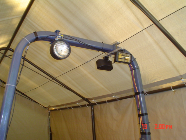

I mounted 2 tractor work lights (4411 bulbs) on underside of rops , and 1 behind seat . Fabricated switch plate with pilot lights , that burn when swich is on .

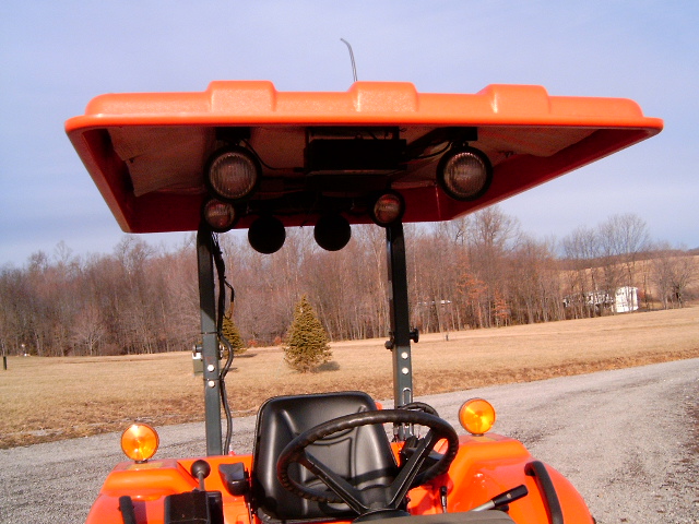

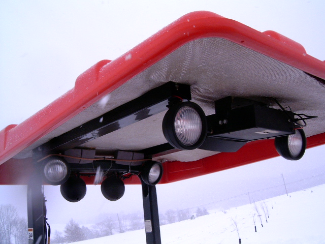

I mounted my lights under the conopy.

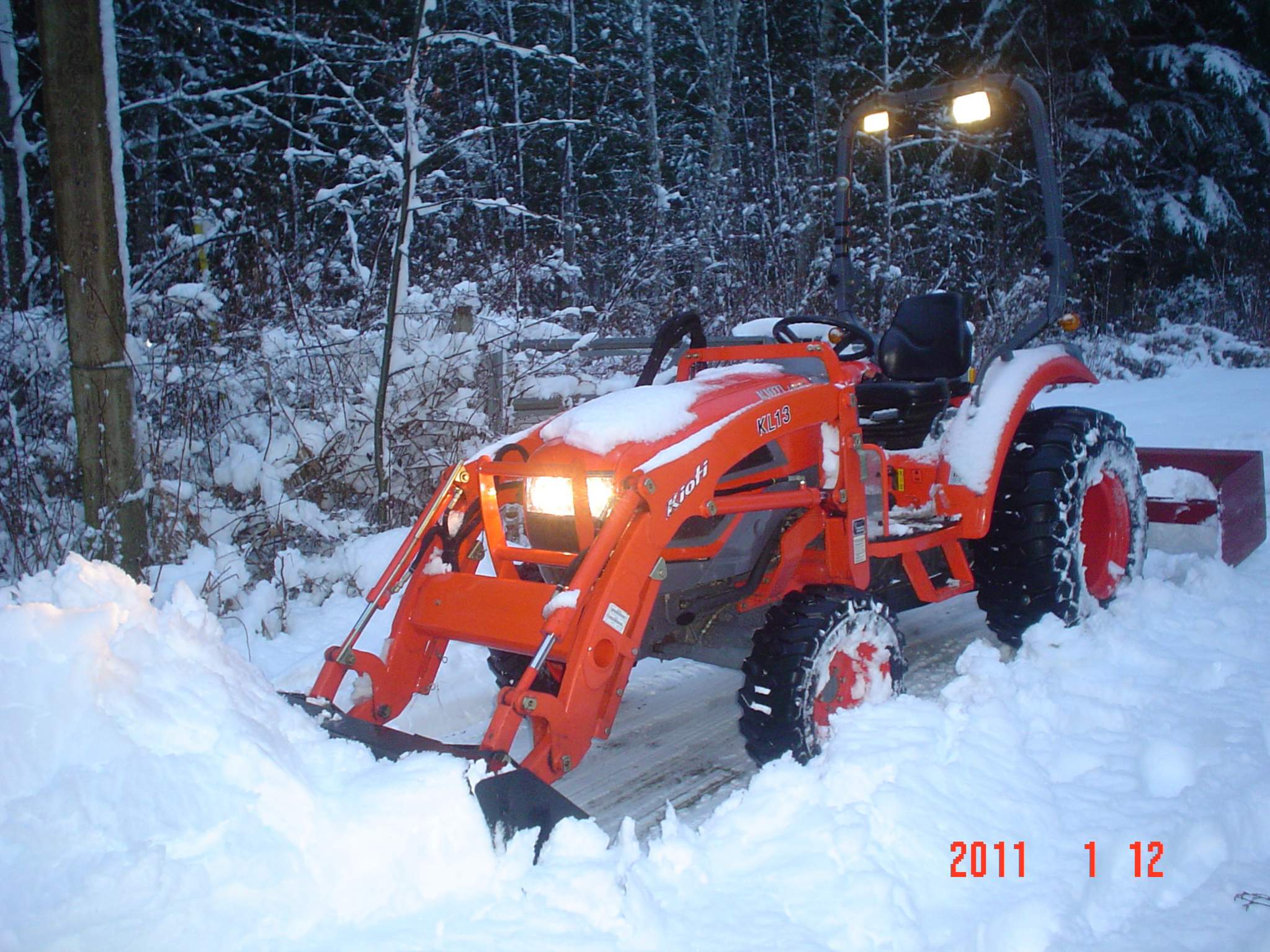

Had the dealer put on one facing the back before I got it. Found the same problem, bucket full of snow and it blocks the headlights. So put on 3 more, 1 more facing back, and 2 forward. I did not drill into the ROPS, used a bracket with bolts to mount the lights. Put in 2 toggle switches behind the seat, so one toggle does the front lights and the other the back.

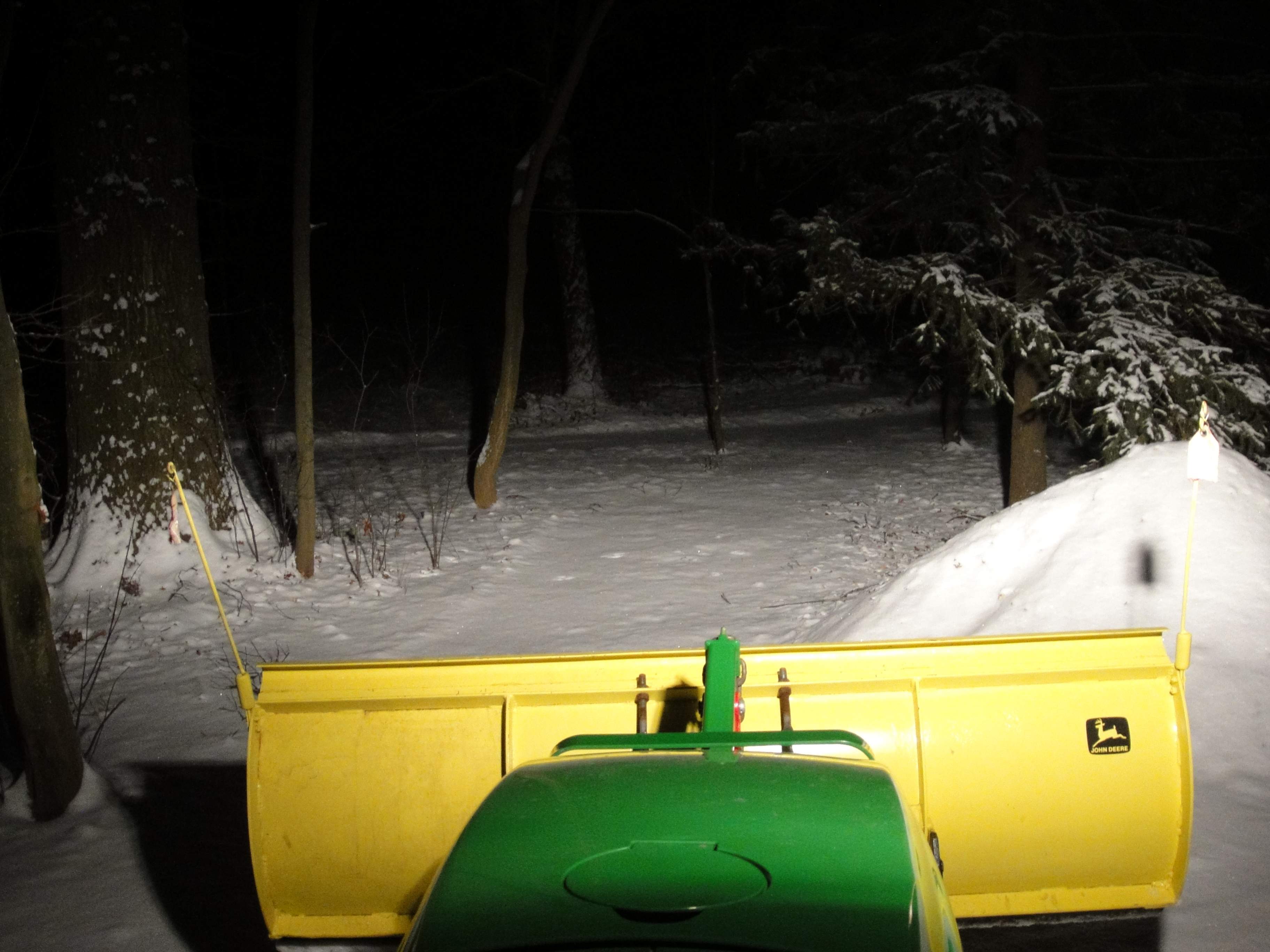

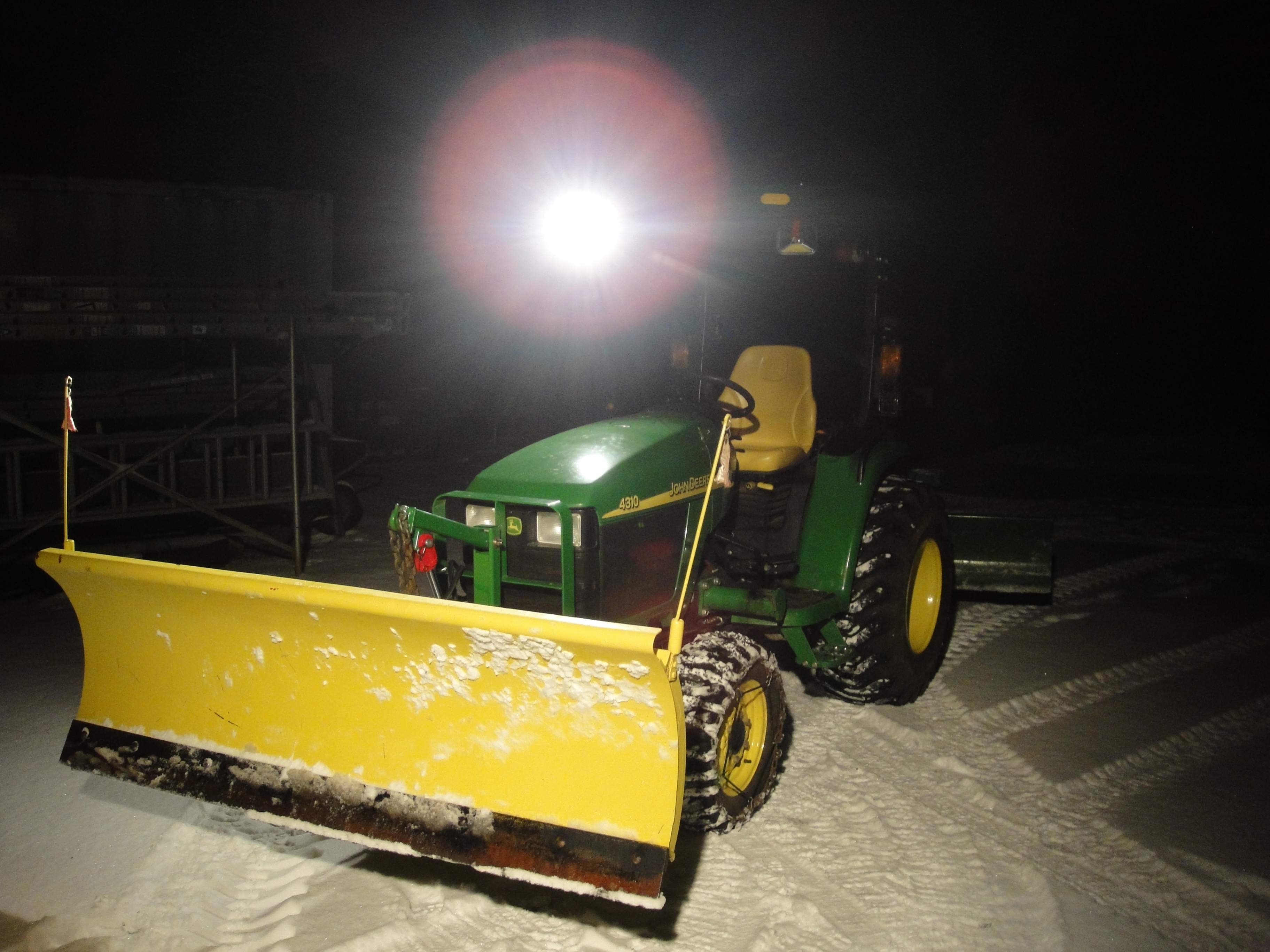

I put one very bright one up on the canopy frame, way better than the factory lights. Helps tremendously for snow plowing.
The kicker is I found 2 of these in a dumpster :)
Do I see sound deadening material on the underside of your canopy? What did you use?
/ Headlights with a loader? #17
Yes. It is heat and sound insulation from LMC Truck parts.
Adding the canopy made the tractor noticeably louder. The noise would echo down off the canopy. Adding some insulation helped reduced some of the noise.
I also added an AM/FM stereo with headphones to the canopy so I can listen to the radio while mowing instead of tractor/mower noise.
