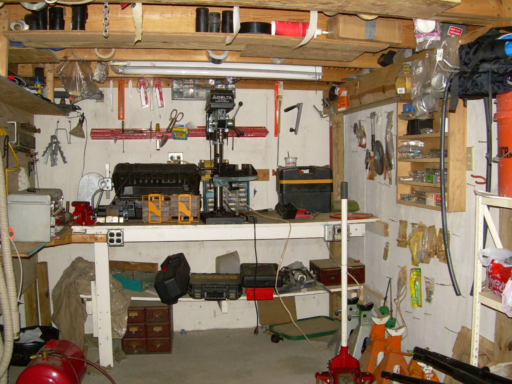

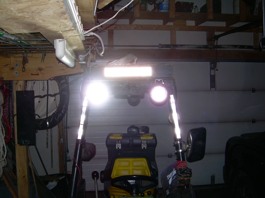

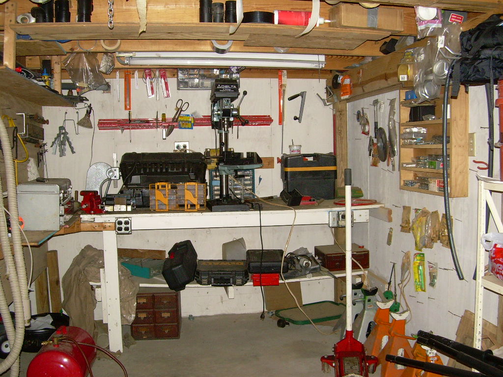

It's working fine. So the polarity issue is over, but it would have been nice to hear from the company. I took some pictures, but have no way of setting my camera. The first three pictures look the same to me. The first picture is the low power LED only, the second is the Autolumination only, the third is both and the fourth is a looking at the lights. You can see the difference here. Of course I have one type on one side and a different type on the other. The Autolumination light is on the left side of the picture.
I have a separate switch on each light. Probably not really needed now, but I like control.
I am tempted to get one of the Autolumination lights for an emergency light in the house. I could put it on my Dewalt battery or run it off of a car battery. Kinda expensive for a flash light though.
