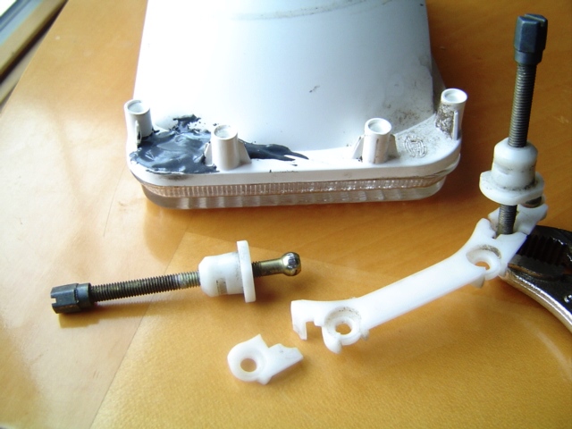

Never got around to welding some mesh to my grill guard and somewhere along the way something must of hit the headlight. Lens is intact, but reflector side is damaged. Issues is the plastic bracket that screws to the back of the reflector. It holds the ball ends of the headlight adjusters; one side has one broken ball end.
Looked at the JD parts fiche; found the headlight assembly (am120326 ,$55, ouch) but below the headlight line are two other non-illustrated parts, one is labeled LVA 11807 mounting parts Dealer can't help me with a pic or further description. Trying to determine if it contains the adjuster screws (only) or also has the plastic brackets that screw on the back of the reflector shell.
Anyone familiar with the LVA 11807 ?

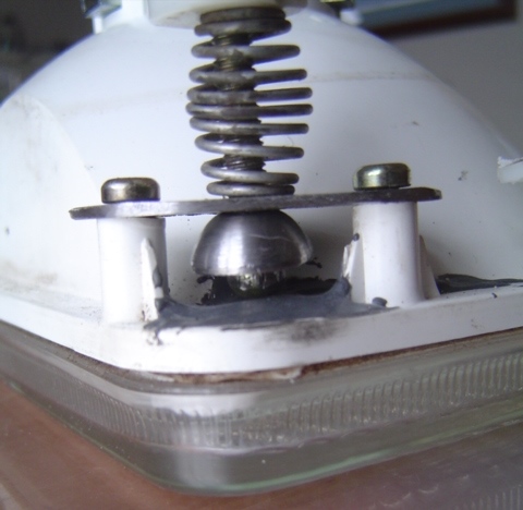

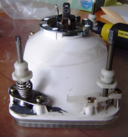

In case anyone else breaks a mounting tab, here's a straightforward repair. Plastic mounts only available as part of the headlight assembly. Spring is to keep tension on the assembly.
