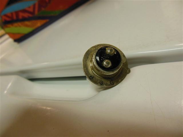

I tried searching but didn't find anything. Is this headlight bulb some special Kubota-only thing, or should I be able to find it at an auto parts store? It doesn't say much on it as far as identification and it doesn't look like a normal bulb to me... This is for the Grand L 3130

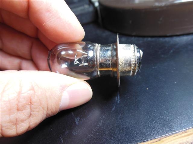

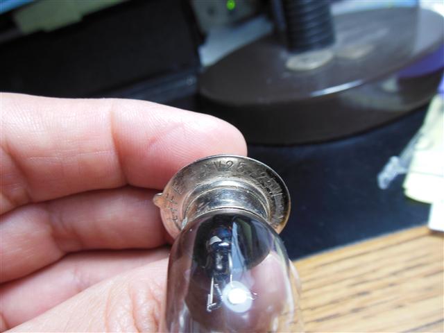

They look like this, and I cannot find a darn thing on them. I can't even track down the base style. That is insane for what should be a very easy, common part - a lightbulb!

I had my wife stop at NAPA while she is out to see if they can match it, but I doubt they will have any luck. So I have to waste time going to the dealer or get it online and incur shipping charges that will probably make it ridiculous. Why do they make the simple stuff so hard? <sigh>

A little research turns up a part number of 31391-34360. Apparently dealers think that it's okay to severely rodger people over these as they appear indistinguishable from the widely popular 1156 bulb which is available everywhere for far, far less.
Edit: ok, the one you pictured above looks quite different than the Messick's one; you might try an 1157 dual filament bulb and see if it fits the socket. I think the flange is just to keep moisture and corrosion out of the socket, or keep the dielectric grease in.

HA! Found it! Man was that painful. I saw something close in the Parts Unlimited catalog (Thanks for that idea Ken!) and it was made by Eiko, so I went to Eiko's page and searched there. Found it in a list of motorcycle/snowmobile lamps. The magic number is A-3603, and here is a link to one source of them, but now that the number is known you can search on that:
A-3603 - 25/25 Watt, 13/13 Volt T-6 Recreational Vehicle Bulb | Bulbs.com
$0.69/ea plus $6 flat shipping, so I think I'll get a few...

Here you go. You can find them on Amazon, about $7 a pair. Eiko Light Bulbs - Headlight - 12V - 25/25W - Mfg/N A-3603 - Card A-3603-BP There is also a 30/30 watt bulb that are used in ATV's but are more expensive.
/ Headlight bulb source? #14
For the Bison 650G, the headlight glassy assembly is manufactured by Stanley. The bulb is an Eiko 48008, which is an A-3603 bulb, dual filament, 25w/25w. I found it using the A-3603 number cheapest on Amazon for $1.60 + shipping.
